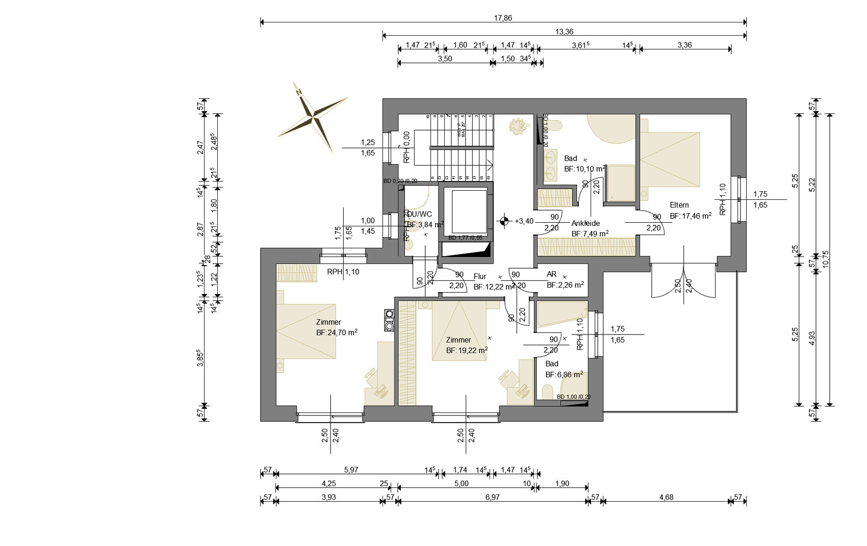

Where does child 2 shower?
What about child 3 and 4?

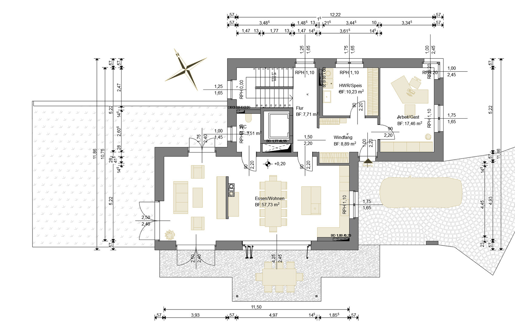

Please also furnish the wardrobes in the children's rooms. They will be needed earlier than the desks and much earlier than the double beds. Especially in the children's room with 19.22 m² (207.1 sq ft), I find this somewhat challenging in combination with the window position, if such a large bed is supposed to be placed inside, which practically occupies 2 interior walls and the 3rd interior wall is taken up by a corner desk.

Thank you for your feedback!

Where does Child 2 shower?
Shower/restroom adjacent to the room. It’s not large, I’m aware of that, but it should be sufficient for daily hygiene. In return, the room itself is bigger.
haydee schrieb:
What about Child 3 and 4?
Depending on whether they are present and their ages, options include sharing a room, a granny flat, or a ground floor office.

No living room
No room for possible Child 3 and 4
Good question!
I think it would work like this. The design has been reduced in size compared to the original plan. Currently at 209 m2 (2249 sq ft).
The living room was dropped out of necessity, because otherwise there would have been no use for that angled area.
Regarding Child 3 and 4, see above. You could also accommodate three children’s bedrooms plus a children’s bathroom upstairs, but it wouldn’t be as comfortable. That could be a possibility, perhaps using drywall for the partitions.
ltenzer schrieb:
Please also furnish closets in the children’s rooms. They will be needed earlier than desks, and much earlier than double beds.
Window positions were not planned well. Maybe French balconies would fit in the children’s rooms.
The floor plan is not finalized in detail yet. The roof shape will be challenging.
Do you think this could work as is or in a similar form? Any major mistakes? Further suggestions?

A toilet opening directly into the living area is unacceptable! Put the pantry inside the house, move the washing machine and dryer to the upper floor, assign the bathtub from one of the children’s rooms to the storage room, and turn that into the laundry room. A drying rack can be placed on the roof terrace (balcony?) in front of the bedroom when needed. Then put the toilet in the utility room on the ground floor.
Bathroom without a window in the granny flat—maybe avoidable.
6 (!) bathrooms?! Seriously?

A toilet opening directly into the living area is a no-go!
That’s a really interesting point. I assume you don’t mean the door swing direction?
I’d be very curious to know if that is the general consensus?

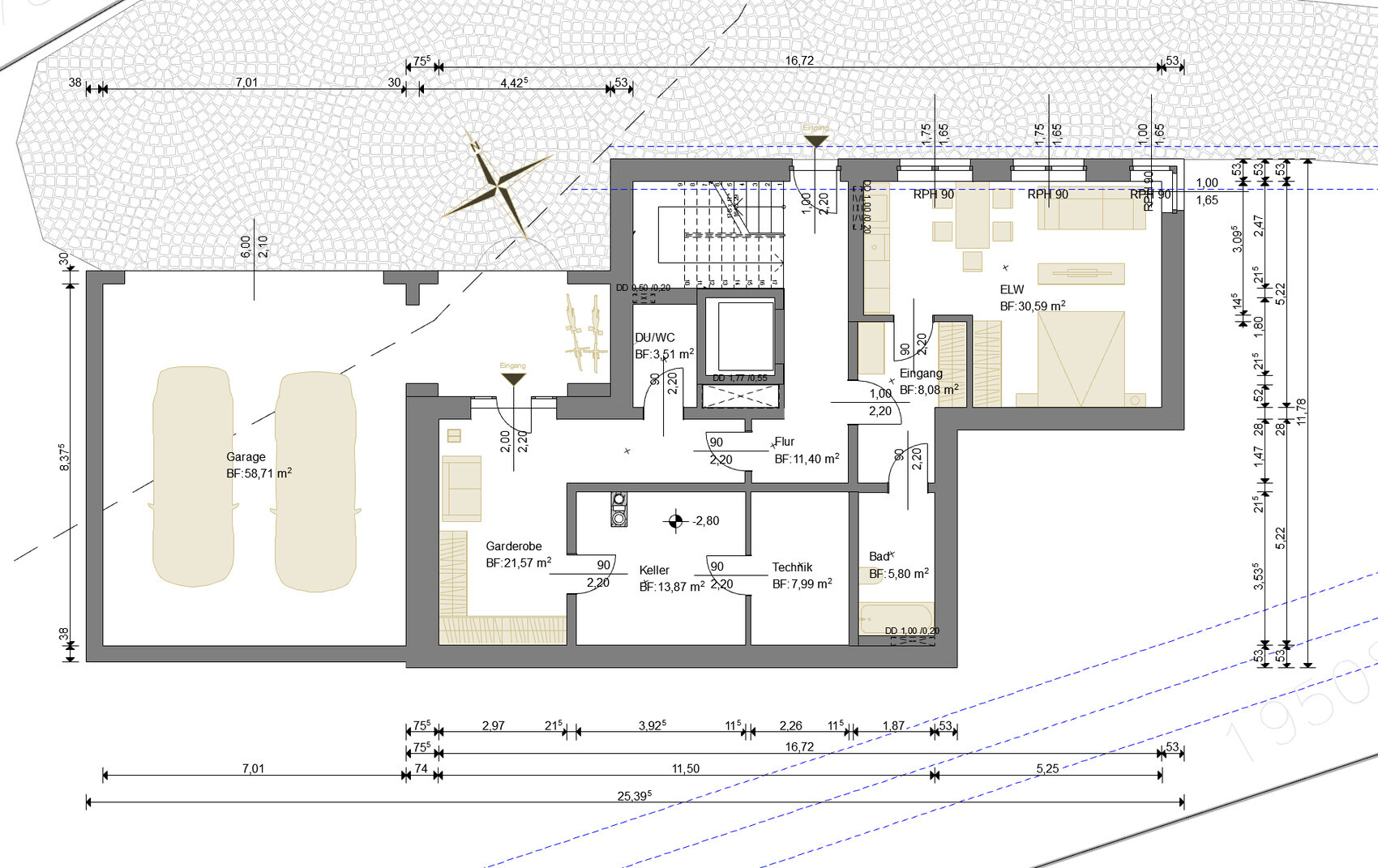

Tamstar schrieb:
Bathroom without a window in the granny flat, possibly avoidable.
With a basement window, it would definitely be avoidable. However, since it’s a hillside, I’d prefer not to install any basement windows because they are weak points. The house will have a forced ventilation system anyway. Natural lighting isn’t an issue nowadays either. We had a smaller windowless bathroom for years, and it was completely unproblematic.
At least the basement toilet can certainly be eliminated.
