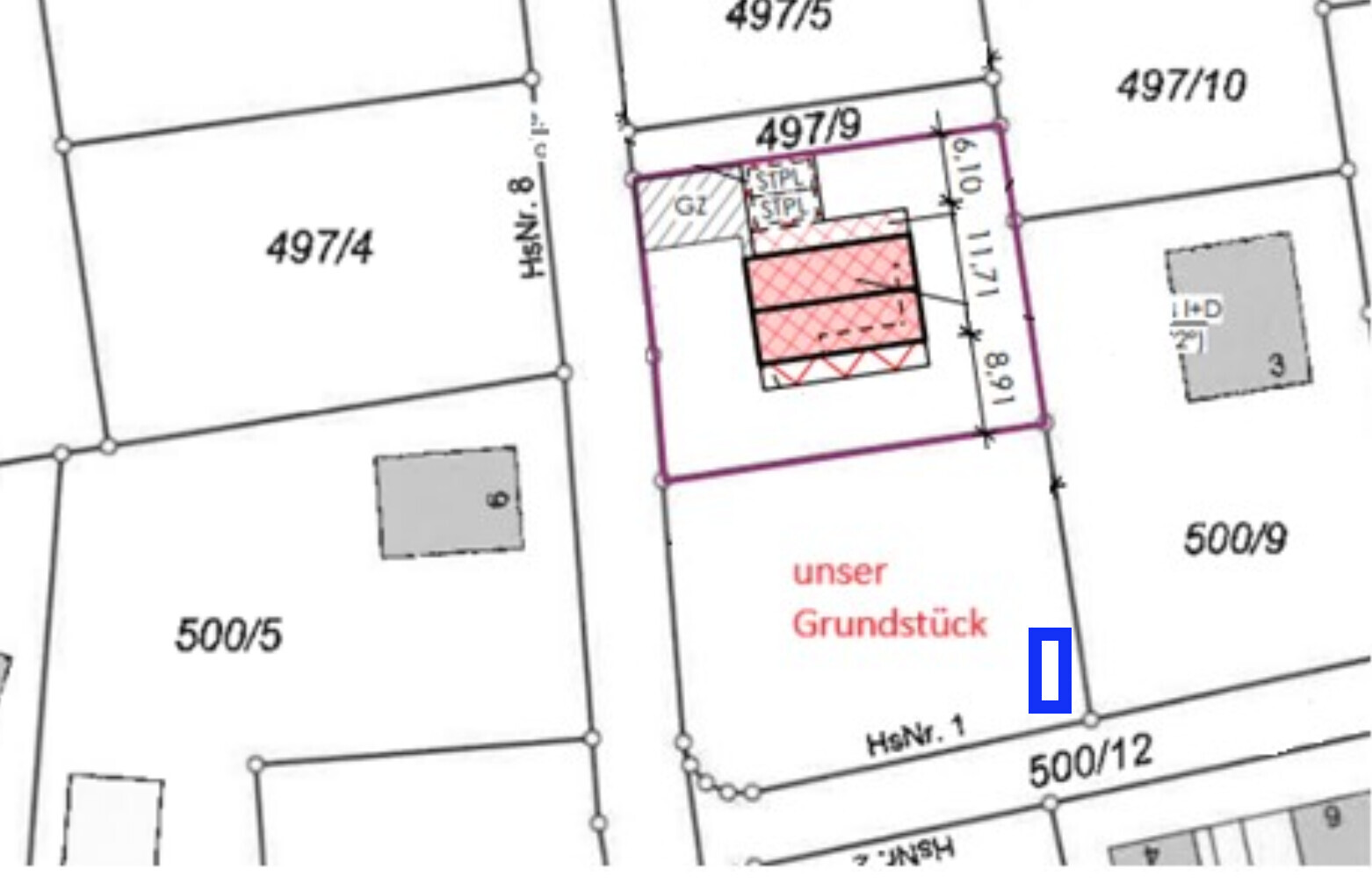

Plot size: 960 m² (10,333 sq ft)
Slope: no
Floor area ratio: 0.2, maximum buildable footprint however <175 m² (1,883 sq ft)
BUT: the 1977 Building Use Ordinance applies
  • § 19 IV: Ancillary structures according to § 14 are not counted towards the allowable footprint. The same applies to balconies, loggias, terraces, and structural elements as far as they are permitted within setback areas or distance zones under regional law (here: Bavaria) (…).
  • § 21a III: Covered parking spaces and garages are not to be counted towards the allowable footprint as long as they are less than 0.1 of the plot area.
Floor space index: -
Building envelope, building line and boundary: 5 m (16 ft) from the road on the south and west, 3 m (10 ft) from neighbors on the north and east

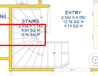

  • Staircase: can’t properly design it in the software, but according to a stair calculation tool it should work. Is the space requirement adequate? Are the asymmetrical runs a problem?

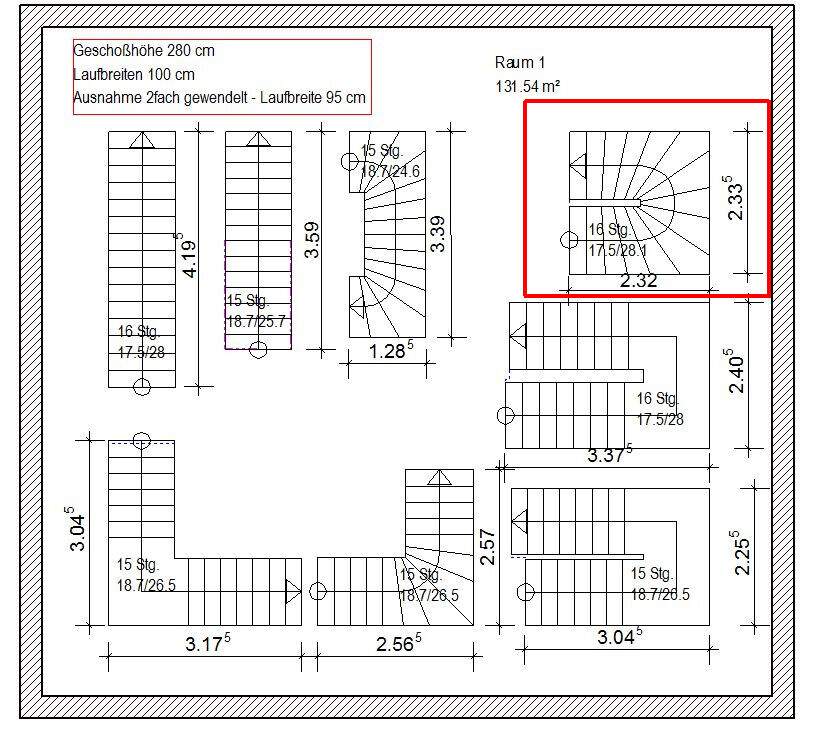

kbt09
27 Jan 2025 21:10
CornforthWhite schrieb:
Floor-to-floor height: 3050 mm (120 inches)
Stair flight 1: 1679 mm (66 inches) = 2320
Stair flight 2: 2682 mm (106 inches) = 2330
Stair flight 3: 2437 mm (96 inches) = 2320
Tread width: 100 mm (4 inches)
Number of steps: 16
Number of risers: 17
Riser height: 179 mm (7 inches)
Tread depth: 273 mm (11 inches)
Angle: 33.31 degrees
Blondel’s formula: 631 mm (25 inches)
I’ll add my input here
Floor plan of a building section with staircases; dimensions in cm; red marking of a stair section
I think your riser heights and tread depths are appropriate. I’m just not sure if the distribution of the stair flights works well. Compare this to a floor-to-floor height of 280 cm (110 inches) with one step less in the red marked area. Also, looking at your staircase, I am concerned about the red highlighted section. There are 5 to 6 steps tapering sharply toward the center due to uneven distribution of the flights. But I’m not a professional stair builder.
Floor plan with stair area marked in a red frame

    I’m also missing dimensions and preferably a 2D site plan.
    2D site plan? Do you mean a satellite image?[/QUOTE]

Site plan: Our property in pink shading, purple border, adjacent parcels 497/9 and 500/12.

I think your risers and treads work. I’m just not sure if the distribution of the flights is ideal. See the comparison with a floor height of 280 cm (110 inches) with one step less marked in red. And then, from your staircase, the area I find problematic marked in red: 5 to 6 steps that converge too tightly in the middle due to the uneven leg distribution. I’m not a staircase builder, though.
As mentioned, the drawing we have is just a placeholder and not accurate. The tool doesn’t handle spiral stairs well and unfortunately produces incorrect layouts. In the staircase tool’s sketch, the steps don’t converge as sharply in the middle. As I don’t have image rights, I can’t share that sketch here.
