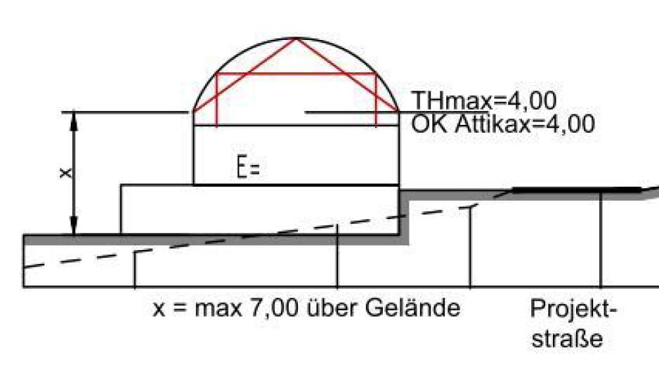

Zoning Plan / Restrictions
Plot size: 600 m² (22 m wide x 27 m deep) (72 ft x 89 ft)
Slope: yes, steep slope (approx. 8 m on the north side and 7 m on the south side; see attached leveling plan)
Site coverage ratio: 0.4
Floor area ratio: 1
Building envelope, building line and boundary: see zoning plan excerpt
Edge development: no, 3 m setback; garage allowed; 5 m setback required from the street side
Number of parking spaces: 2 per housing unit, one of which must be covered
Number of floors: max. 2 full stories + half / stepped floor
Roof type: no restriction
Architectural style: no restriction, except no log houses
Orientation: west
Maximum heights / limits: eaves height max., parapet top max. 4 m (13 ft) on street side; eaves height max., parapet top max. 7 m (23 ft) above ground height on garden side
