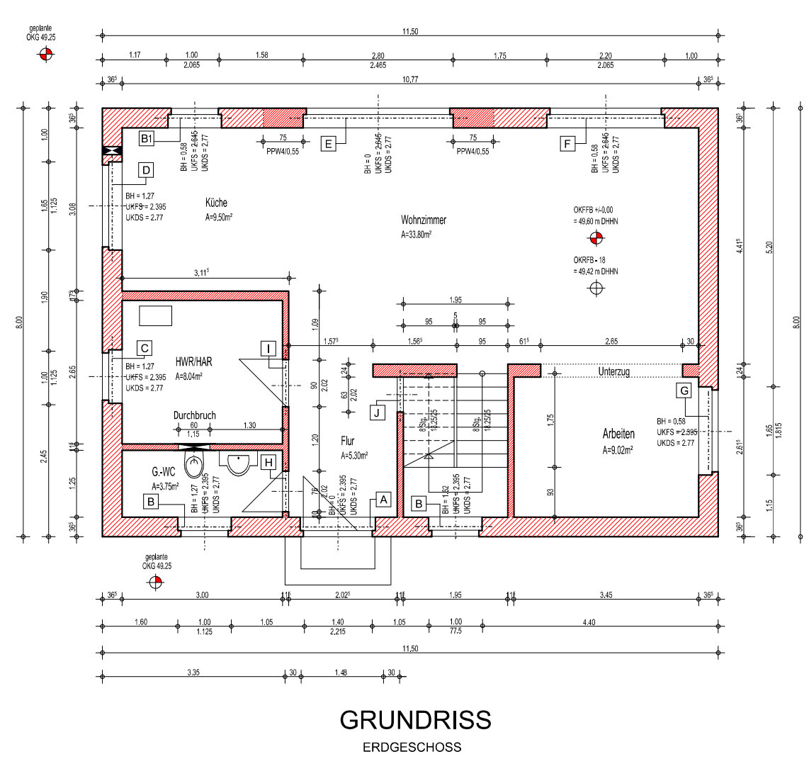

We bought a plot of land last autumn and are currently deep into the floor plan design. We would like to share our current draft with you and welcome any comments and opinions.

- 1000 m² (10,764 sq ft) rear plot, southwest facing (so southwest is on the left side of the site plan)
- Building boundary up to approx. 16 m (52 ft) behind the property line (up to the dashed line on the site plan)
- No zoning plan (construction according to § 34 of the Building Code)
- Groundwater at surface level and peaty soil (exact geotechnical report pending), so piled foundation required and no basement
- Affordable! (Our maximum budget for the house including foundation slab is €230,000)
- Country house style
- Bright, large windows facing south/garden
- Open living/dining/kitchen area
- Family of four, 1 bedroom and 2 children’s rooms
- Not oversized, max 150 m² (1,615 sq ft), preferably less
- Solid construction using Ytong blocks (for us the most cost-effective option, although we would have liked to build with wood as well).
- Developed ourselves after studying various floor plans (including from the book "Affordable Building with a Small Budget" by Achim Linhardt) with support from architect friends and our planner (an independent civil engineer).
- Dimensions 12.50 x 7.50 m (41 x 25 ft) (the measurements shown on the site plan are from an earlier draft).
- What we like: open living area, all main rooms have large windows facing the garden, efficient size, although the children’s and bedroom could be smaller, sewing/work nook behind the stairs upstairs, plenty of wall space for large wardrobes in the upstairs bedroom and hallway on the ground floor, light shaft in the stairwell, staircase (we originally wanted a straight run staircase but it would have taken too much space; the one with three quarter turns is also fine with us).
- What we don’t like 100% yet: the height of the house from the outside. It is currently planned as a two-story house with an eaves height of 6.2 m (20 ft), with the ground floor 2.84 m (9 ft 4 in) high and the upper floor 2.60 m (8 ft 6 in) high. The gable roof will be an uninsulated, unfinished cold roof, mainly because of the economical prefabricated truss construction method. This is a bit disappointing because I really like sloped ceilings and did not want the character of a townhouse. Lowering the roof with a knee wall of about 1.90 m (6 ft 3 in) and an insulated roof with open sloped ceilings would probably be more expensive due to the rafter/beam construction. We would also lose the garden view through the floor-to-ceiling bedroom windows.
- Simple: What do you think about the floor plan?
- Can you still imagine the relatively tall two-story house having a country house character? Maybe it depends on the facade design and choice of materials? Do you think it looks too “blocky,” especially from the front entrance side? Or would a lower eaves height with an attic conversion including a knee wall be preferable?
- We are still unsure how to arrange the windows on the garden side. The drawing with the elevations shows two possible versions. We actually prefer it when the upper floor window is centered over the lower window front. However, this does not align the interior line of sight from the entrance door to the garden/patio door (see ground floor plan). This represents version two; for version one, the window front would have to be shifted about one window width to the right, so that the patio door is behind the dining table. With the window front shifted left, the interior looks better to us, but from the outside it looks strange if it is offset from the upper floor window, right? What do you think?

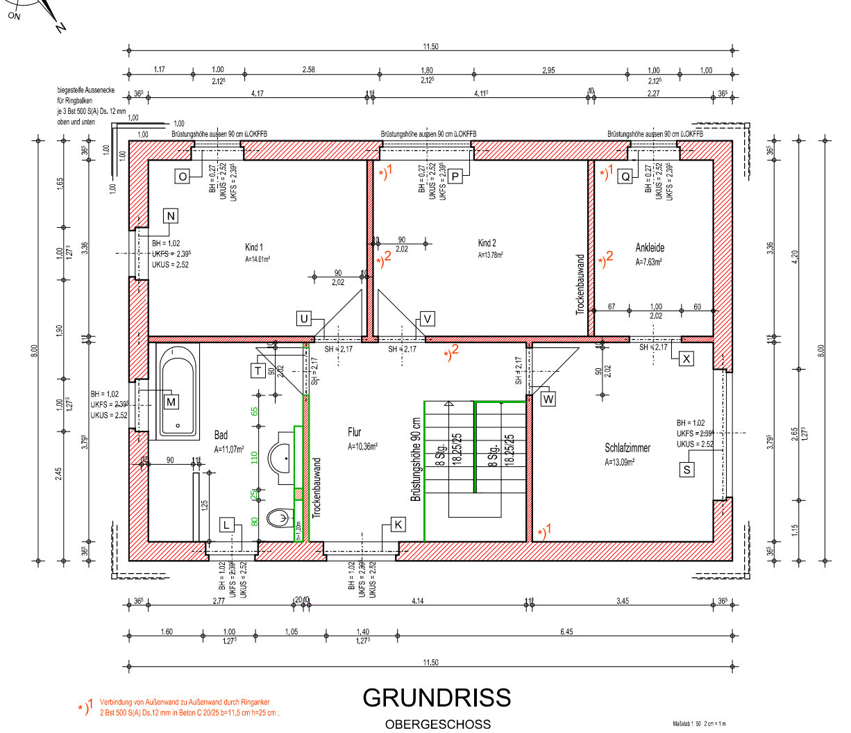

It’s been about a year now, and back then I received very mixed reactions to our planning (to put it mildly 😉). Here’s an update:

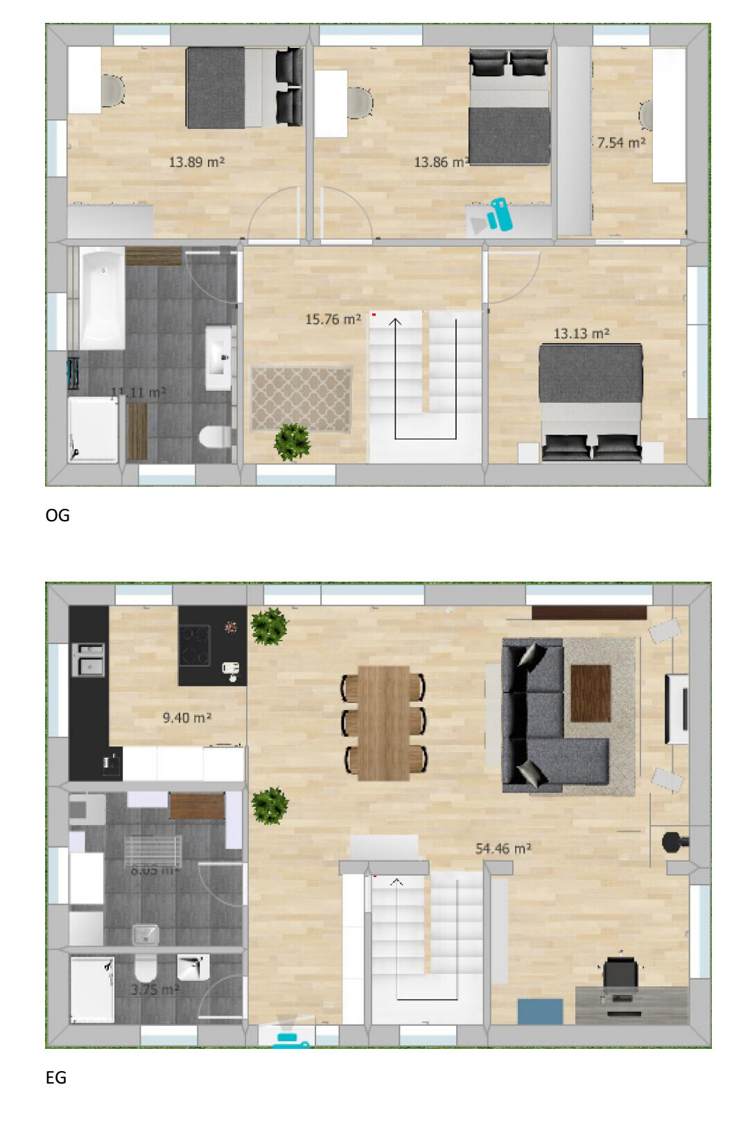

We ultimately decided on the last floor plan we discussed, with the half-landing staircase leading off the living room. However, we made some adjustments to the upper floor after our initial building permit / planning permission was rejected. The reason given was that on rear plots, two full stories are not allowed. That was tricky since closets, the shower, and everything else was planned along the eaves sides 🤨. After some research, we found a court ruling from Munich interpreting §34 in a way that the surrounding buildings must not be differentiated between front and rear developments. We referred to this ruling, and the building authority finally approved it 😀. By that point, we had rearranged the upper floor anyway and stuck with the new layout because we simply liked it better. Attached is the final floor plan.

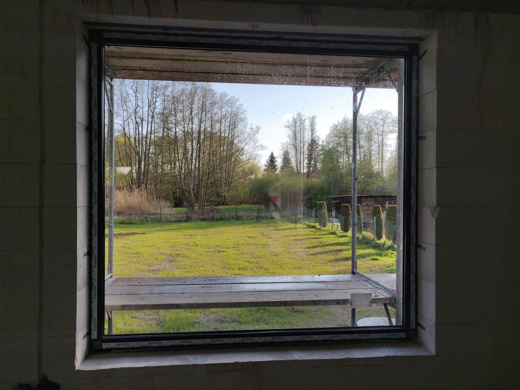

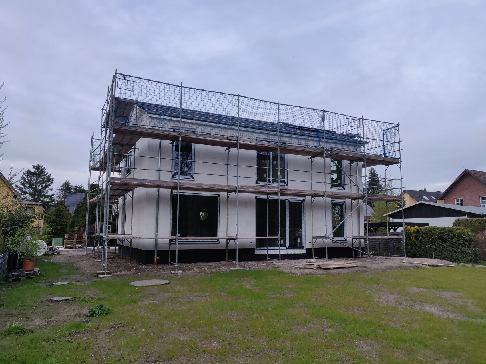

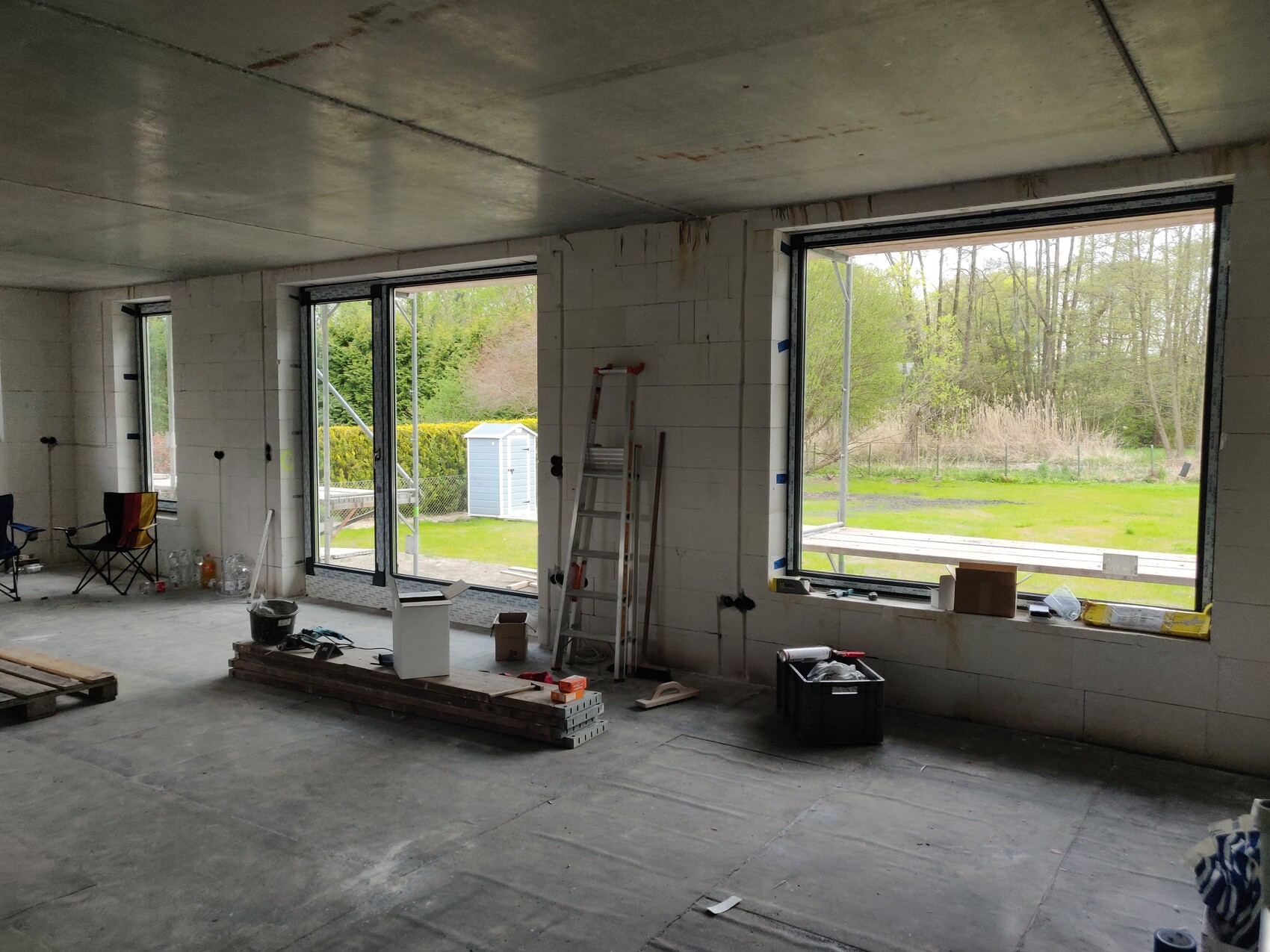

Just before Christmas, the slab foundation was poured, the masons started in March, and now the shell is up with a finished roof and windows installed. Progress is going well; the construction site hasn’t stopped for a single day. We are sticking to our budget so far; our continuously updated spreadsheet currently estimates a final cost of about 205,000 € (around $220,000), so we indeed still have some margin. This estimate includes the pile foundation and the slab but does not include the kitchen. We still have funds set aside for the kitchen, carport, and terrace.
For cost reasons, we have given up on a few things. For example, we abandoned the higher ceiling height on the ground floor, keeping it at 2.60 m (8.5 ft), the same as on the upper floor. The facade will now be plastered, as we decided to skip the wood or brick veneer, though I do regret that a bit. But since I see the inside of the house much more often, I want to avoid compromises there—especially regarding flooring, fixtures, and doors—rather than on the exterior design. Instead, we slightly increased the floor area from 11.5 x 7.5 m (38 x 25 ft) to 11.5 x 8 m (38 x 26 ft), which means the living area is now calculated at 142 m² (1,528 sq ft). Some windows were enlarged or added as well.
For self-help work, we mostly handled the site development and complete earthworks, drywall installation, and plumbing (my boyfriend and father-in-law are currently working on that), as well as window and door installation. We decided not to tackle the roof ourselves after a roofer friend of my father-in-law gave us a very good offer and kindly told us that we would just get in the way during roofing. Thanks especially to my father-in-law, we are getting materials and services at very favorable prices. My sister is building at the same time with a large construction company, and I’m often amazed at the cost of every small deviation from the standard there.
Looks nice.
The staircase seems somewhat questionable to me and appears to be the result of a “planning dead end”: always wanting an open staircase to the living area, which consequently led to it being enclosed.
Instead, a better approach would have been to position it from the hallway area, rotated 90 degrees counterclockwise.
That way, the parents’ area could have been planned differently as well – the widening certainly has a very positive effect!
I also find the low window in the kitchen a bit unusual – what is the purpose of it?

Yes, the staircase is definitely quite unique and doesn’t appeal to everyone. I never wanted it to be very open anyway; for example, I’m not a big fan of staircases without risers either. The walls had to provide storage space. However, I do like that it’s connected to the living room. We also tried other layouts, including the one you mentioned with the staircase rotated 90°, but none of those appealed to us as much. An architect from another forum also suggested an L-shaped staircase starting from the hallway, which wouldn’t have changed the floor plan much. But – maybe it’s just a strange quirk of mine – do you know that feeling when you’ve already showered and are in your comfy clothes late at night, slowly walking from the sofa to bed? And then having to walk again through the hallway with dirty shoes and jackets on? Even though houses today are well insulated and hallways are warm and sometimes open... probably it’s just a very specific feeling 😉.
The kitchen window has the same sill height as the seating window and the one in the study. Another full patio door seemed unnecessary, but we wanted more light and a better view of the garden from the kitchen. It can also be used as a pass-through 😉. That’s why we added this window quite late and changed the kitchen layout from a U-shape to an L-shape with a small island.

hanghaus20008 May 2021 10:34I also had a staircase right in the middle of the living room. After a few years, I remodeled. It is definitely much more comfortable when the staircase is located in the hallway.

Having a staircase right at the front door has almost only disadvantages and is usually not favored here in the forum. However, it is acceptable if the house is being built on a small footprint and with cost savings in mind.
