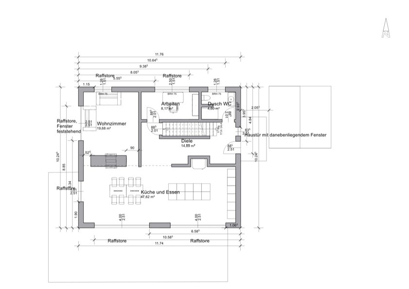

Floor plan of a house: living room, kitchen and dining, hallway, office, shower toilet, stairs.

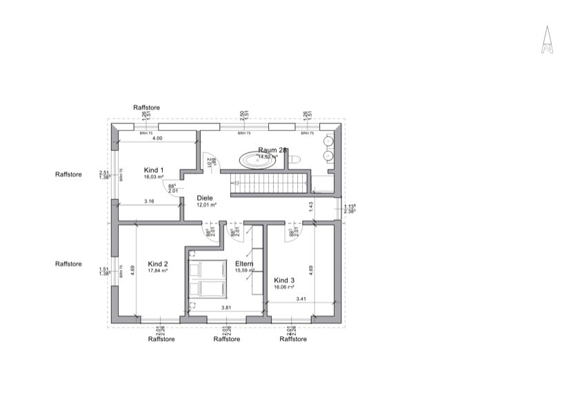

Upper floor layout: corridor, stairs, bathroom, master bedroom, and three children’s bedrooms.

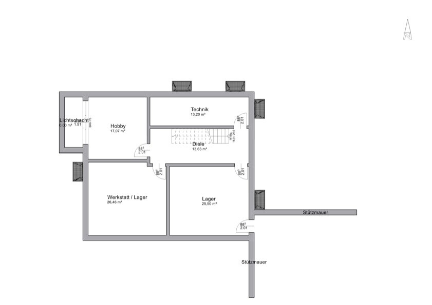

Basement floor plan with utility, hallway, hobby room, workshop/storage, storage, and light well.

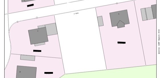

Site plan of a residential quarter: multiple plots with buildings, central open space, green area below.

1. There is a lot of space for the kitchen and dining area on the south side, which I think is good. The living room is on the north side, which works well. However, I don’t understand the kitchen island layout. I would plan the island parallel to the tall cabinets.
2. What is the recess for? Is it for the refrigerator? I wouldn’t design it like that because of the hallway behind it.
3. What is the space between the dining and living areas?
4. I wouldn’t design an entrance door with a window next to it separated by a wall. I would choose an entrance door with a window without a wall in between.
5. How wide is the corridor/entrance at the bottom?
6. In my opinion, it might be worth considering moving the staircase slightly south to reduce the hallway space on the ground floor and the rooms upstairs, in order to enlarge the bathroom on the upper floor.
7. Also, I would divide the narrow bathroom into a parents’ bathroom and a children’s bathroom, and while at it, reconsider the necessity of a shower on the ground floor.
8. I would never place the master bedroom between two children’s bedrooms.
9. Personal question: Are you sure you need a third children’s bedroom?

- The niche for the refrigerator: From my perspective, freestanding refrigerators are currently a trend. Whether that will always be the case or whether you might want something different later on is uncertain. In that case, you’d have an unused niche in the wall—or possibly a broom closet, depending on your needs.
- Child 2 / Parents: The child’s room doesn’t really benefit from the narrow entrance, whereas the master bedroom might gain from having a bit more space. I would consider moving the door to the child’s room slightly to the left and giving the master bedroom a wider entrance.
By the way, I agree with the previous commenter regarding the children’s rooms: I would also prefer not to have our bedroom next to the children’s rooms. It depends on the child, of course—ours is a light sleeper and wakes up at every noise.

The recess in the hallway is annoying. The kitchen doesn’t need that either. With some rearranging, you could avoid that recess. Possibly also compensate with a large wardrobe cabinet so there isn’t a bottleneck.
I don’t like anything upstairs! The bathroom is set too far back, and having a bathing area in front of the actual bathroom somehow feels out of place.

Below, the floor plan fits well except for the recess; with three children, the cloakroom space will no longer be sufficient.
Upstairs, I find it suboptimal due to the unnecessary narrow corridor, the entrance jut-out by the children’s room, and the awkwardly shaped bathroom.
