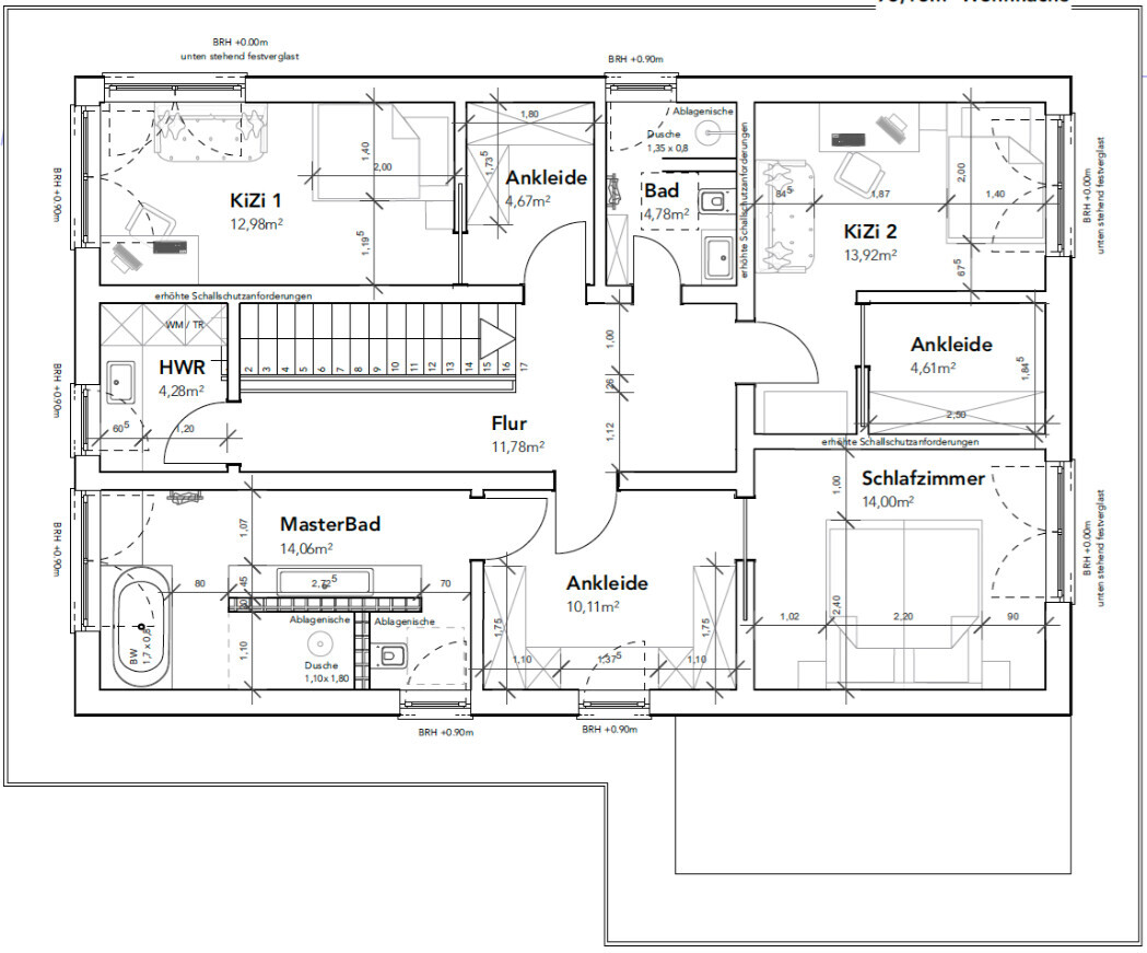

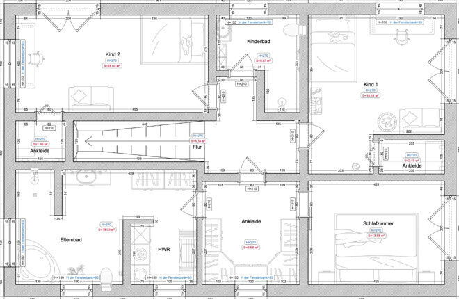

we have purchased a quite challenging sloped plot and have now received the first draft from our architect. I have personally revised it to address some weaknesses that arose due to my requested changes. The exterior dimensions are relatively fixed. I am fairly satisfied but would appreciate some additional feedback before sending it back to the architect.

On the upper floor, the second children’s bedroom is located in the northwest rather than the southwest because the higher neighbor's house stands directly to the south, and to the north there is a great view of the green valley.

Floor plan of an upper floor with bedroom, bathroom, walk-in closet, children's rooms, and hallway.
Floor plan of a house with Child 1, Child 2, bedroom, master bathroom, children's bathroom, walk-in closet, hallway, utility room.
In my opinion, the floor plan has been worsened instead of improved.
Somehow, the architect's floor plan is larger???
I would be very interested in the details of how this continuous parapet is supposed to work in a solid construction house.
Putting the additional costs aside for a moment. (You can count them as balcony costs: 500 euros/m (160 dollars/ft) * 120 m (394 ft) equals 60,000 euros (72,000 dollars))
They are not cutting corners here.
Slowly, the 1.2 million budget is no longer realistic.

You can’t tell from the design (at least in the version shown here): the drawings show stacked flat-roof bungalows with roof overhangs on each floor slab. Also, there’s a “disintegration” into the plot that practically amounts to topographical violation (penalty: excavator buckets weighed in gold).
Exactly, that was a misunderstanding with the architect, who didn’t take this into account in the first draft. That’s why you only see the roof overhangs.
However, I don’t understand how you perceive it as a topographical violation, because I would like to know how you think the plot should be built otherwise… On a slope, you have to excavate. If we just put it on top, we’d need a 4m (13 feet) high ladder to the front door, and the car would have to stay parked on the street.

hanghaus2023 schrieb:
In my opinion, you made the floor plan worse while trying to improve it.
Somehow, the architect’s floor plan looks larger???
I’m curious about the detail of how the continuous parapet is supposed to work on a solid masonry house.
Setting aside the additional costs. (You can count those as balcony costs: 500 euros/m * 120m equals 60k)
There’s no skimping here.
Slowly, the 1.2 million is slipping away.
In what way is it worse? My design provides at least 4 square meters (approximately 43 square feet) more living space and no narrow, corridor-like kids’ room accessed through a closet.
I left out the roof overhang on the outside because it was hard to represent in the software and, frankly, I don’t want roof overhangs everywhere and on every floor. That was just the architect’s interpretation. By the way, this is absolutely not unusual—my parents’ 1960s Bauhaus-style house has the same.
