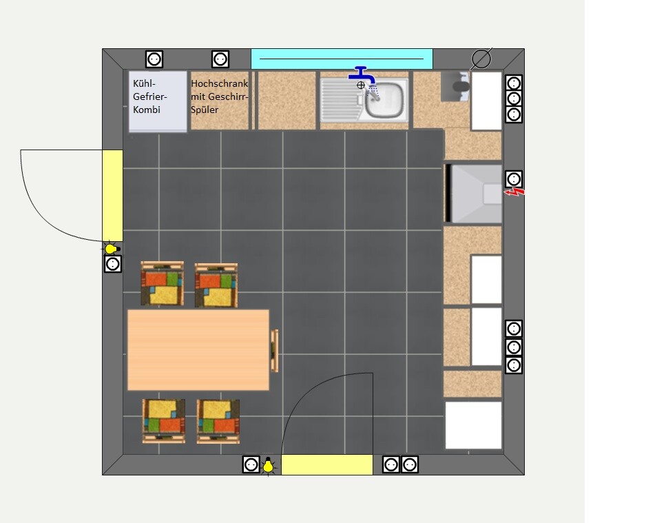

West-facing windows: We would like to have 2.01-meter (6 ft 7 in) windows in Child 2’s room as well as in the kitchen, but that would significantly limit the kitchen layout. I have now uploaded a picture with the detailed plan.

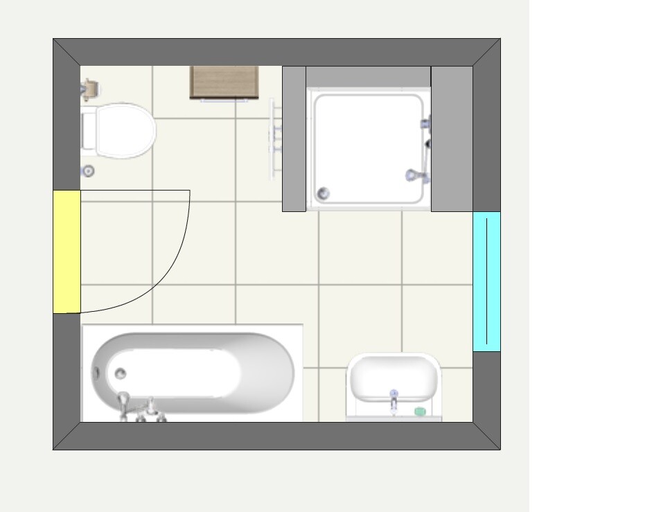

Bathroom downstairs: I have now uploaded a picture showing the current layout, as we were not satisfied with it. Could you please explain on the picture what you mean?

West-facing windows: We would like to have two 2.01 m (6 ft 7 in) windows in Child 2’s room and the kitchen, but that would significantly limit the kitchen layout. You could reduce the distance between the windows by 25 cm (10 inches): give both children’s rooms 2.01 m (6 ft 7 in) at the top, and the office 2.26 m (7 ft 5 in) at the bottom.
I would adjust the dining room/conservatory passage to 2.01 m (6 ft 7 in).

Regarding the bathroom: On the right side, first the shower, then the bathtub. On the left side, the washbasin, and by the window the toilet (or vice versa). The door should be positioned accordingly; there is enough space. Anything else only takes up space, reduces room, and limits natural light. Mobility is restricted.
