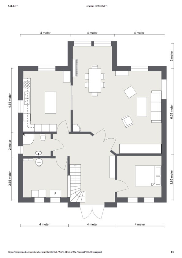

Heiko_baut18 Dec 2017 19:11Hello everyone,

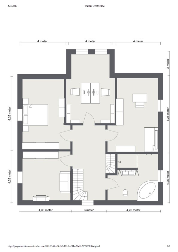

Based on the floor plans attached, the architect from the general contractor is now planning our house. The floor plans were created by us as a guideline for the architect. Please don’t scrutinize too closely whether doors, frames, or windows are exactly right, as, for example, they are definitely not finalized yet.
The first drawings from the architect are expected to arrive after Christmas. The architect had relatively few comments on the floor plans. From his perspective, the hallway on the upper floor is too large, and there will be a few minor changes made in the bathroom. The chimney flue also needs to be adjusted.
The building permits / planning permission applications are planned to be submitted in mid-January 2018.
What is currently causing us some concern is the relatively small kitchen. The net size will be around 16 sqm (172 sq ft), but we would prefer a larger kitchen—20 sqm (215 sq ft) or more. Unfortunately, we cannot think of a smart way to meaningfully change the layout without making too many compromises in the other rooms.

Heiko_baut18 Dec 2017 19:41Thank you for the information, RobsonMKK,
attached are the floor plans as JPGs and the questionnaire:

What do you think of the floor plan? Do you have any ideas to enlarge the kitchen without major compromises to the utility room and living room?
Just looked at the kitchen, and I don’t see any problem there. You can fit a lot of countertop length in. Even a 1.20m (4 feet) deep island fits perfectly (countertop 0.65m (2 feet 2 inches) + 1.1m (3 feet 7 inches) aisle + 1.2m (4 feet) island). There’s still about a meter (3 feet 3 inches) of space left to the sliding door.
Heiko_baut schrieb:
The architect from the general contractor [...] had relatively few criticisms of the floor plans. That doesn’t surprise me at all and unfortunately doesn’t mean much.
Heiko_baut schrieb:
The kitchen is too small I would question that. Where does that opinion come from?
Heiko_baut schrieb:
What do you think of the floor plan? I don’t have to like the house. Objectively, I have doubts about the space-saving staircase leading to the attic. The main staircase also doesn’t seem optimally arranged in relation to the entrance. The setback in the facade on the ground floor at the utility room and guest room probably looks quite awkward. Personally, I wouldn’t like that the bay window projects relatively far out and makes the house deeper than it is wide. Take a look at the facades – the windows don’t appear to be distributed in an aesthetically pleasing way.
Heiko_baut18 Dec 2017 20:01Thank you for your reassuring words. The kitchen fitter said that an island only makes sense if there is at least 1.30 m (4 feet 3 inches), preferably 1.50 m (5 feet), of space to the door and the aisle.
