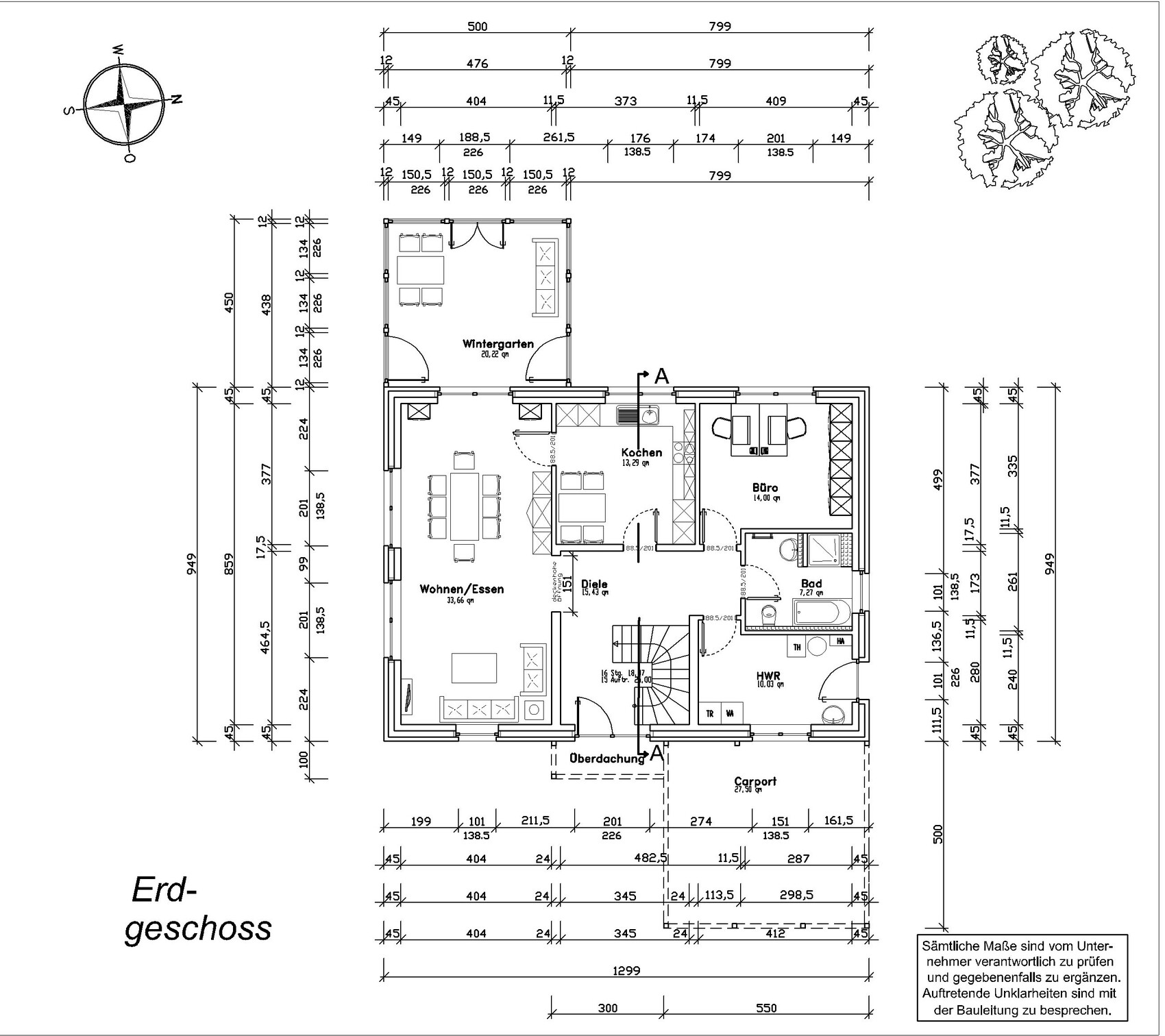

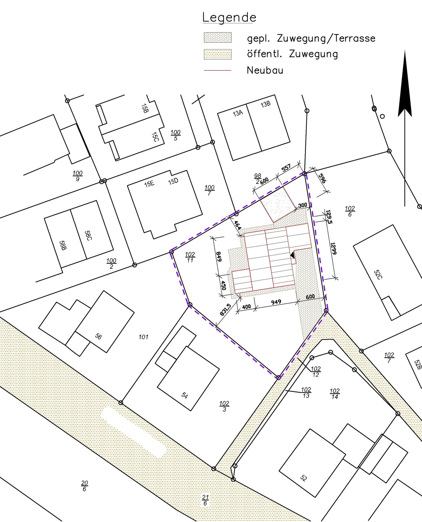

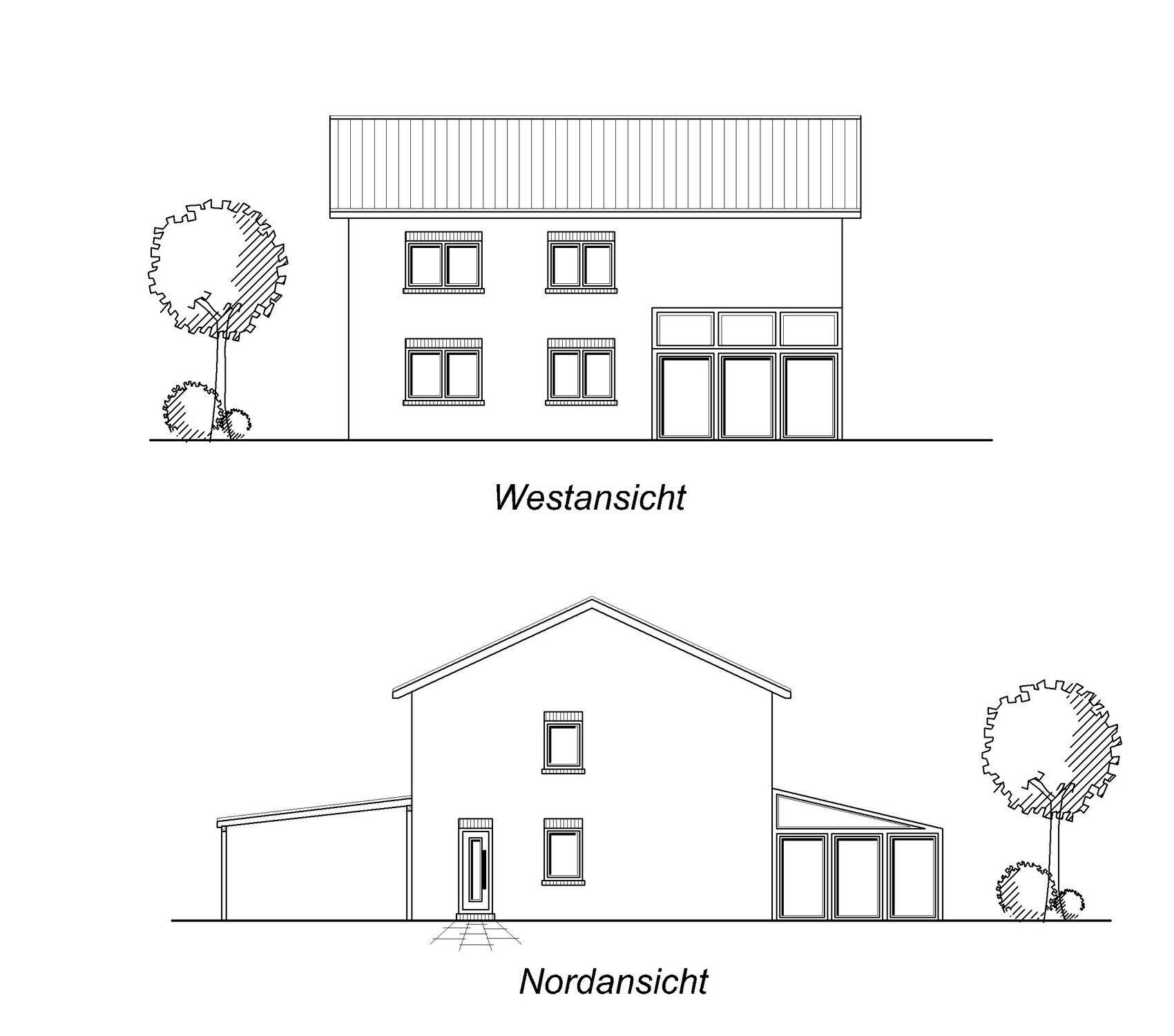

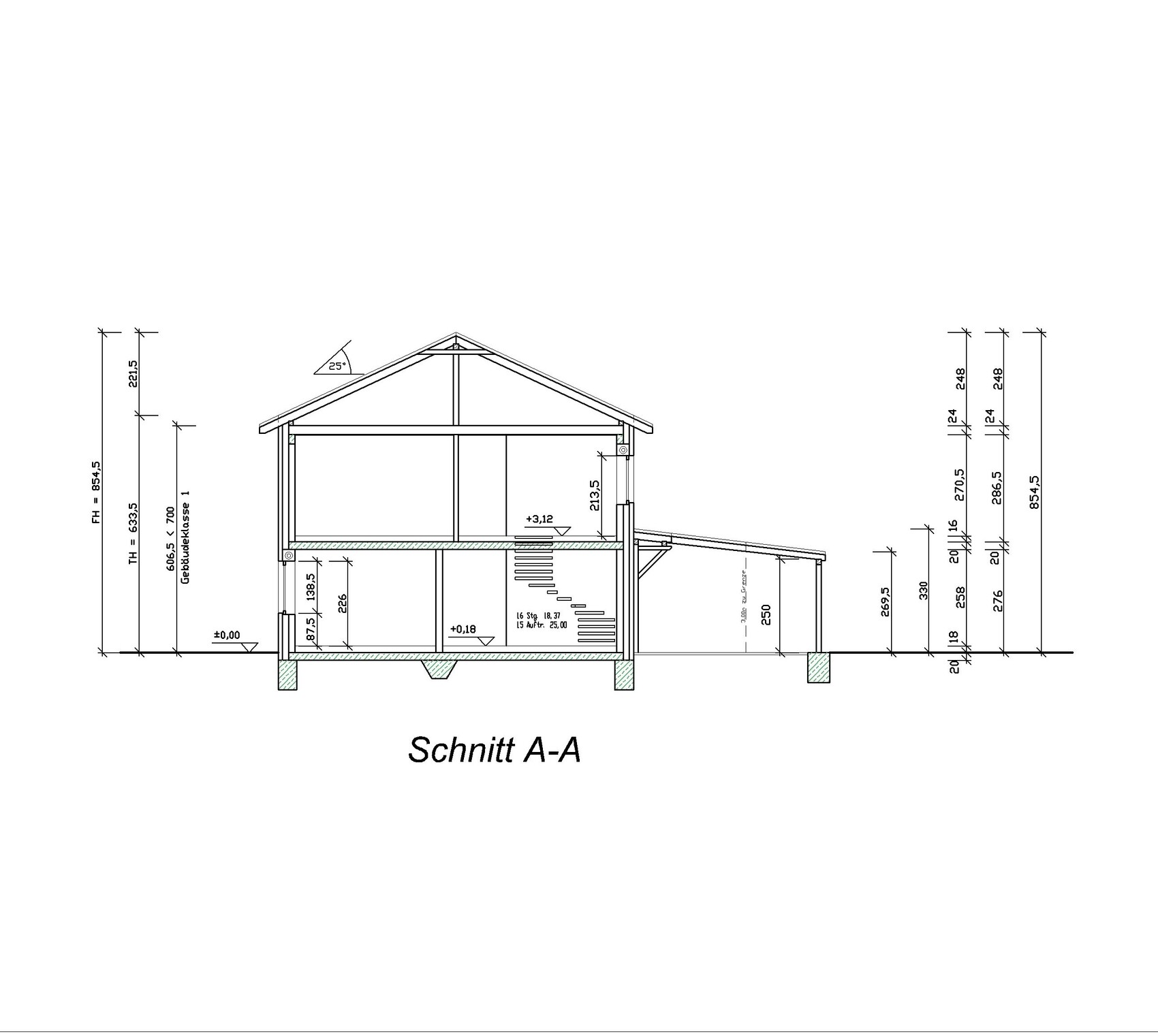

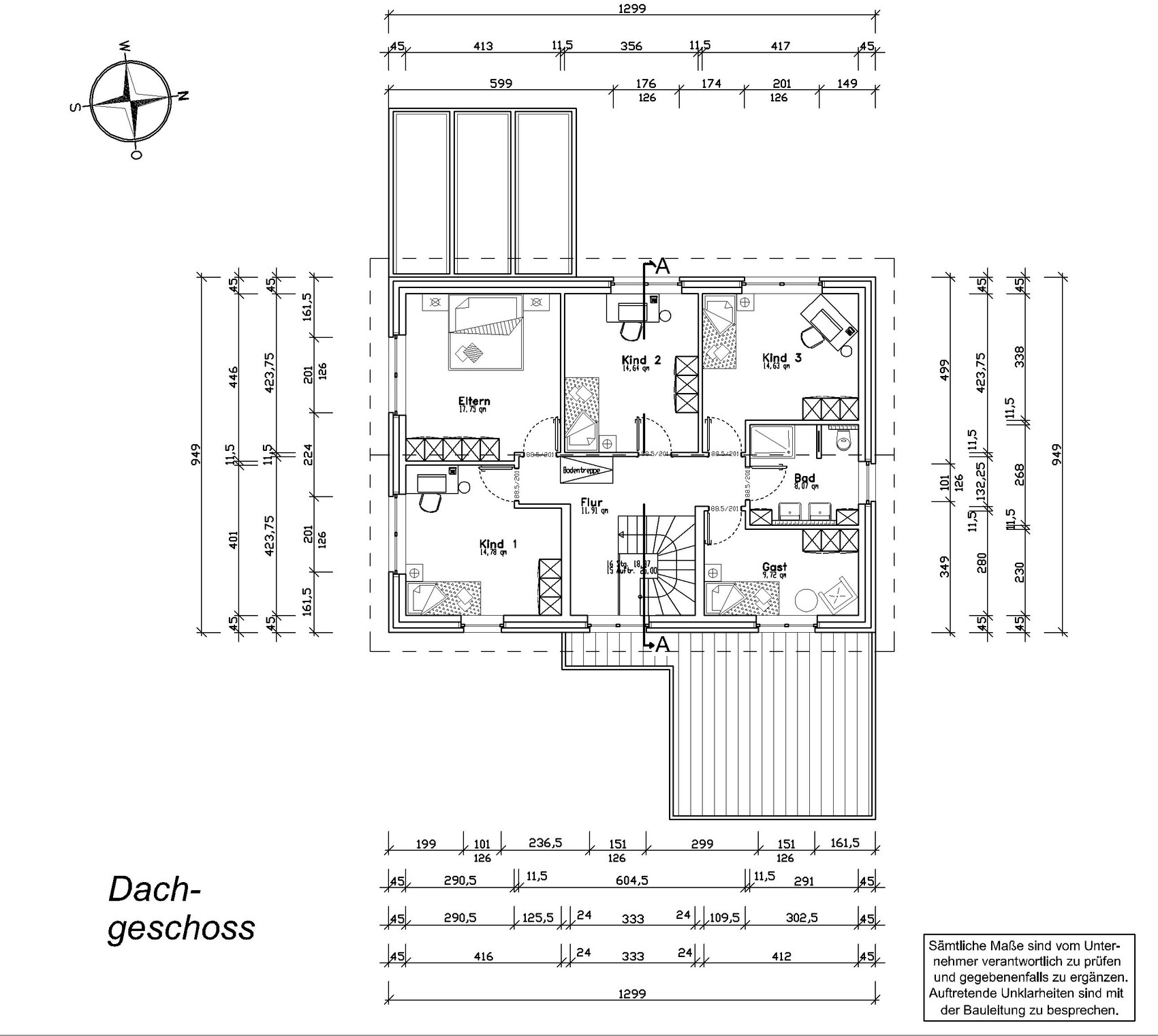

after a long time, I’m back with a new design that nearly meets all our wishes.
We (a family of five) are planning to build a single-family house in Lower Saxony next year. The house might be split after about 15 years so that my wife and I live on the ground floor, and the upper floor is either sold or kept for the next generation.
It is about an infill plot; there is no zoning plan.
Plot size: 911 m² (9,804 sq ft)
Roof type: Gable roof, 25° pitch
Style: Traditional
No basement
Number of people, ages: 2 adults 42 years, 3 children 7, 9, 12 years old
Office: Family use
Guest stays per year: a few times, 3-4 people
Closed architecture
Traditional construction method
No open-plan kitchen
No fireplace
Garage and carport: yes, both; garage mainly used for bicycles and storage
Additional wishes: Definitely a conservatory!
Planned by: Architect
What is disliked? Possibly too much circulation space, but can this be reduced? Bathroom layout downstairs
Preferred heating system: Gas
Please share your opinions.

If there are two bathrooms, I would prefer the one with the bathtub to be next to the bedroom rather than the office.
Hello Paulus,
the house has really taken shape in the meantime and is on the right track.
However, I’m already seeing the planning as somewhat final? Has it already been submitted as a building permit / planning permission application?
If that’s the case, some advice might come a little too late...

Thank you for the quick replies.
What you mean about the bathtub makes sense, although we rarely use the bathtub but might use it more as we get older, so it would be on the ground floor.
The plan has not been submitted yet, but the architect needs it by Wednesday morning at the latest, so it’s not too late for your advice, but please hurry.
