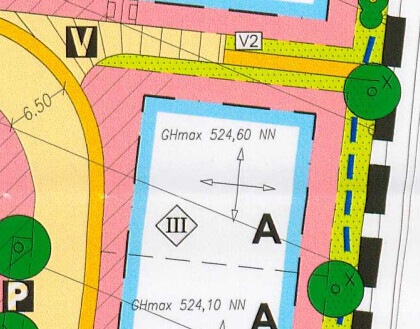

Attached is our building plot in the site plan, including the marked building area (approx. 17 x 17m (56 x 56 ft)). The plot slopes less than 1m (3 ft) from north to south.
What is not current on the plan: the adjacent path to the north is fully asphalted; the marked walkway and green space do not exist. Access road to the west; to the east runs a drainage ditch, then a farm track and a field.
In our view, the development plan is quite relaxed:
- Site coverage ratio 0.4 without outbuildings, floor space index 0.8.
- Garage and other ancillary areas may be located outside the building area.
- 2 full stories allowed.
- Eaves and ridge height sufficient.
- Roof shape is freely selectable (we want a gable roof (permitted 27–45°) or a hip roof (permitted 25–40°)).
- Dormers and roof recesses are permitted, max. 2/3 of the roof length and minimum distance 1.5m (5 ft) from the gable.
- 2 parking spaces per dwelling unit, only 1 parking space if under 50m2 (540 ft²).
- 5m (16 ft) queueing space in front of the garage; however, some have already been allowed to reduce this to 3m (10 ft) in the development area, which we might also consider.
Idea: The house and front door should face north; the necessary setback area towards the adjacent path is to be used as parking space parallel to the path. The planned double garage will be placed in the northwest corner, with access from the west. Terrace on the southwest side. The plan is not more detailed yet.

thank you for your input!
To be honest, we have not really considered a bungalow; they are very rare in our area—I don’t know a single one among acquaintances.
From initial research, I think our property might be too small for that?
