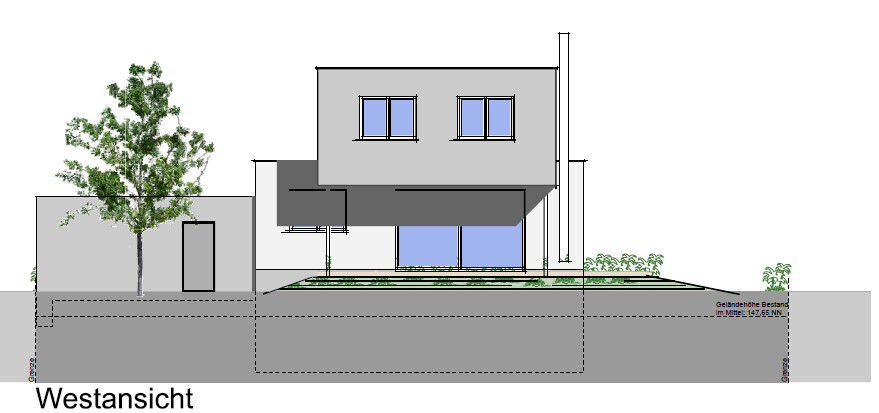

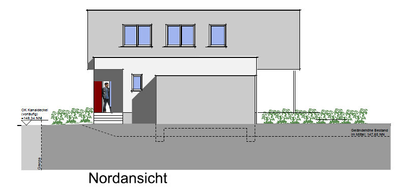

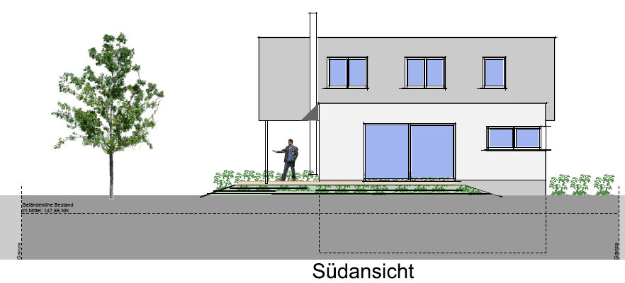

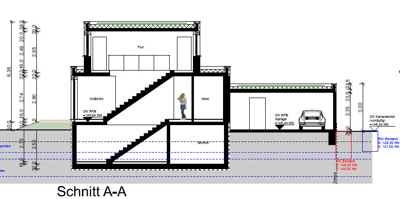

Notstrom
23 Aug 2019 22:06
Modern two-story south-facing view of a house; person at the entrance, tree on the left, garden.
Section A-A through a multi-story house with stairs, corridor, storage room, and garage.
Modern two-story house facade with flat roof, terrace, tree on the left, garden in west view.
North view of a modern house with stairs, red door, person at the entrance, and garden hedges.
kaho67423 Aug 2019 22:48
That can be offered. Personally, I’m not a fan of these large overhangs, but that’s a matter of taste.
The living room is a bit small for the size of the house, but still acceptable. I would move the door to the ground floor bathroom to the entrance area, as otherwise, the restroom wouldn’t be private enough for me.
Having a children’s room next to the bedroom is always a bit tricky—I would make the wall a bit thicker. The same goes for the child’s room next to the bathroom.
I would divide basement room 2. Not every basement room necessarily needs a window well. It would ruin the terrace. That’s not worth it to me.
Otherwise, quite good.

24 Aug 2019 00:20
I quite like that.
I like these overhangs but wouldn’t want them myself.
Still, a nice design!
It would be interesting to see the dimensions for the upper floor.
What I don’t like: the living room furniture arrangement feels uncomfortable. Rotating it 90 degrees counterclockwise would make it feel a bit cozier. Still, be careful with two entrances—the living room might simply not feel cozy. It’s also tricky with two children regarding which way they take in the evenings.
The bathroom is furnished in an impractical way. It’s better to invest in planning now.
tomtom7924 Aug 2019 06:44
You have a flat plot and are building 4 steps in front of the door?
There are still many rough spots in the overall layout.
Consider turning one of the master bedrooms into a children's room.
The bathroom could use a few extra square meters, especially around the bathtub and the door.
Plan for a sliding door between the kitchen and the hallway.
Otherwise, very nice.
