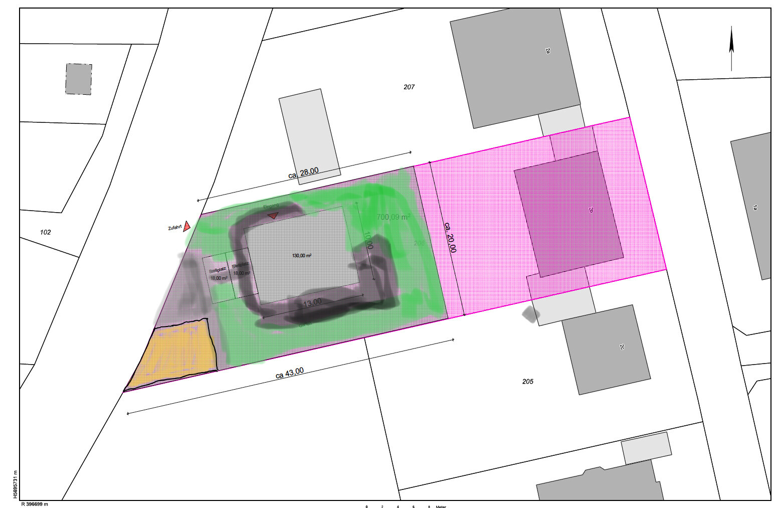

Here is a site plan, but as mentioned before, we are just at the early stages. The terrace will be the thick black area around the house on the east/west sides, the gray area will be paving, and the yellow marks the garage (just an idea of what it might look like, we will see).
As for the plot, hmm, small is "GOOD." Prices here are about 280-300 € per 1 sqm (square meter), so we’re doing well. The typical lot size offered in our area ranges from 300 to 350 sqm. We’re lucky here because we got a garden plot that an older lady no longer uses.
Site plan of a building plot with house floor plan, dimension lines, and color-coded areas

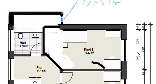

Yes, the laundry chute was supposed to be in the hallway or the master bathroom. Now the architect has planned it in the kids’ bathroom, but that will be removed. The bathroom will be made slightly smaller, and the older child’s bedroom will be a bit bigger.
Floor plan of an apartment with hallway, bathroom, and child’s room I
