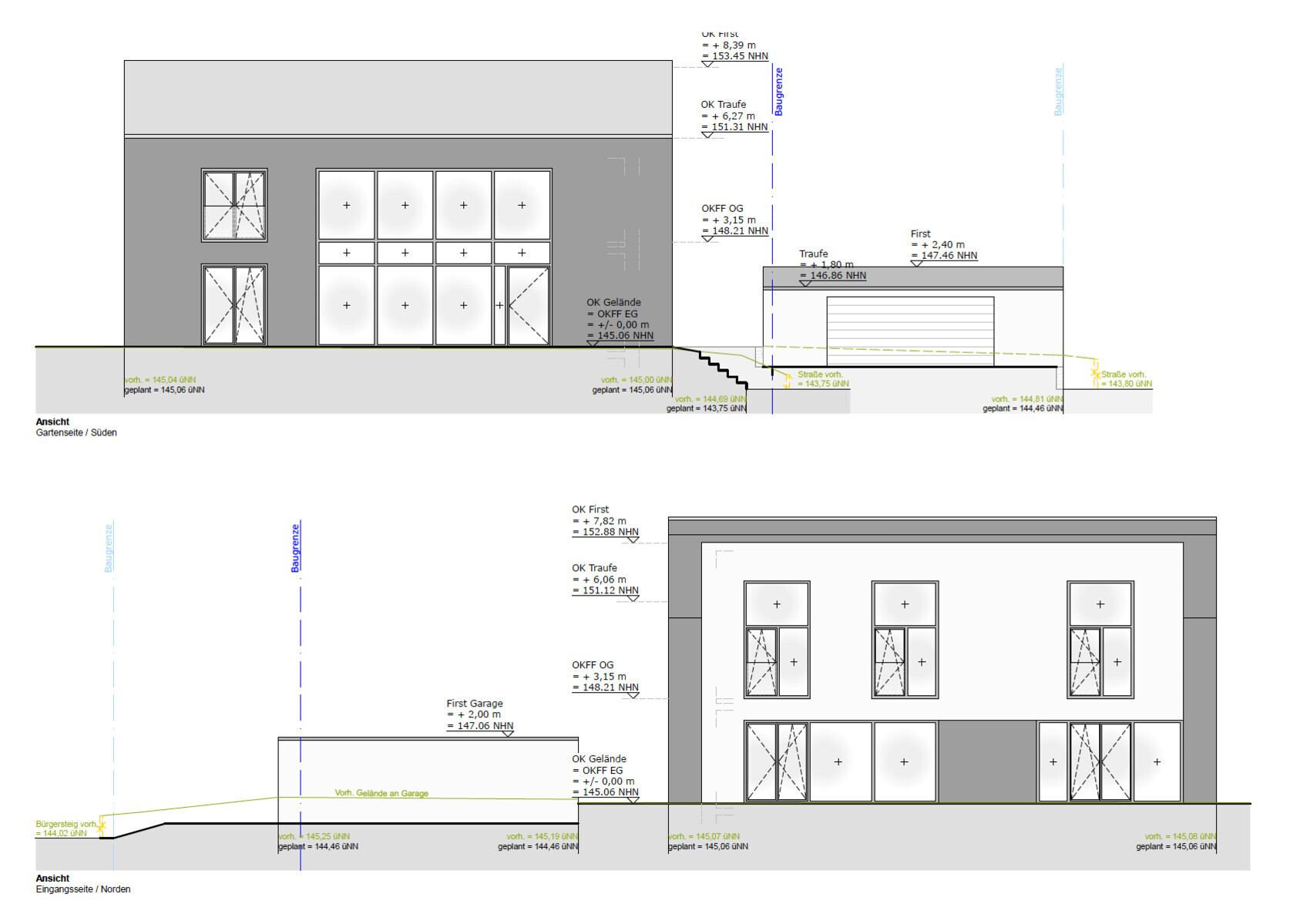

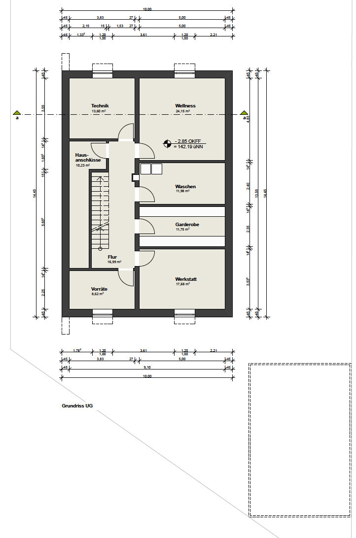

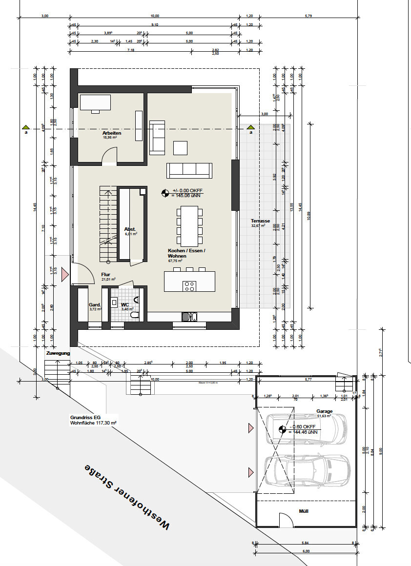

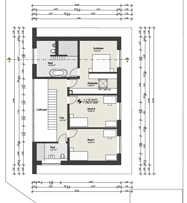

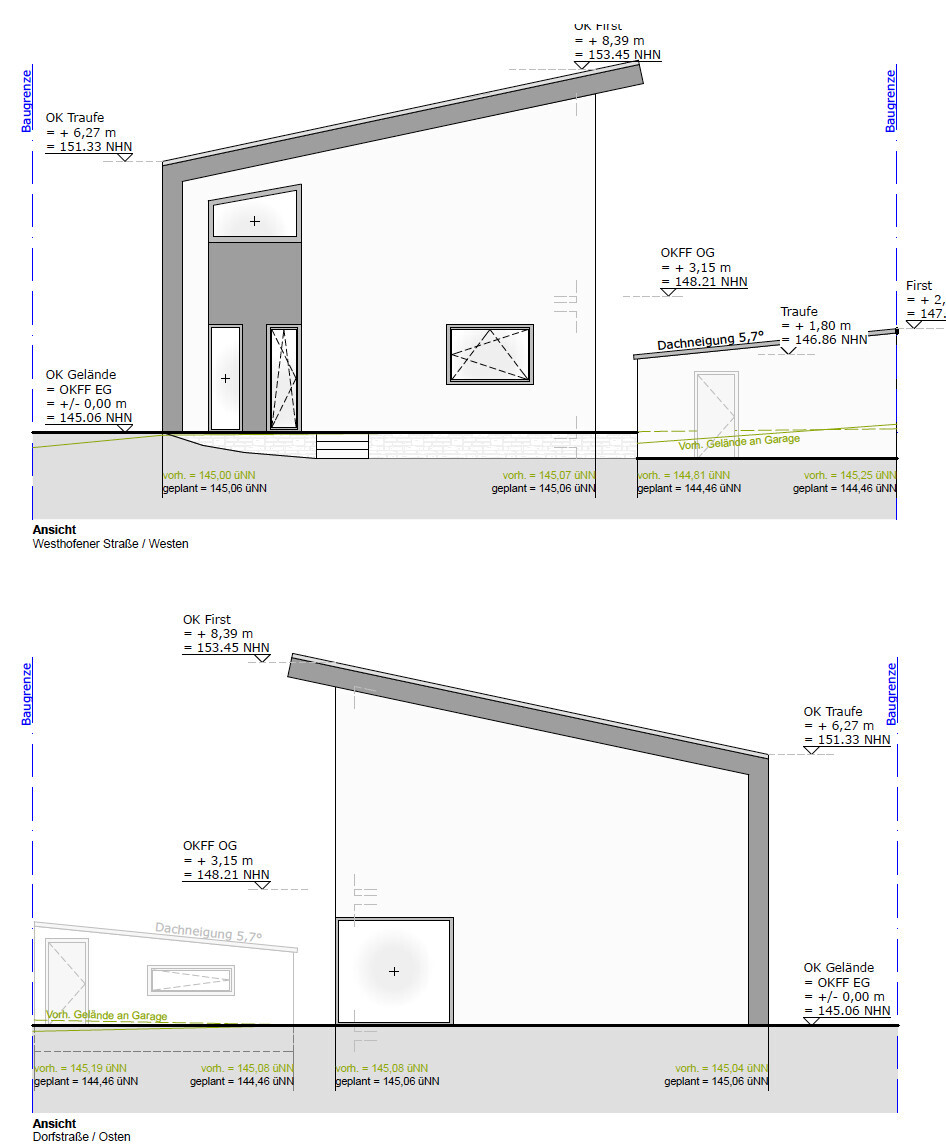

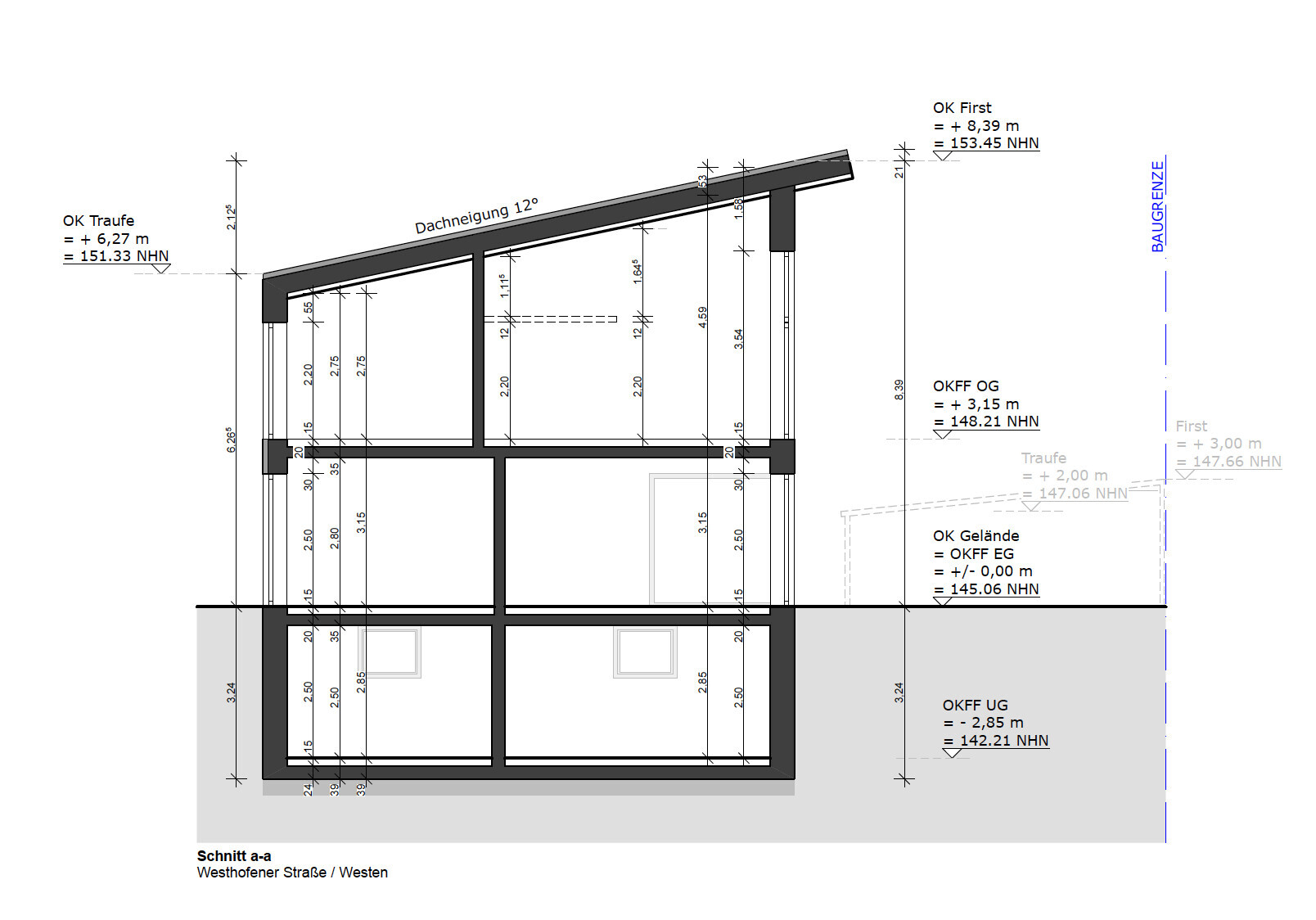

Here are the latest drafts showing how it “will” look. Thanks to everyone for the many tips!
darek6er
Garden view/south side of a building with windows, doors, and garage; height details.
Ground floor plan: living/dining area, terrace, study, hallway, restroom, cloakroom, storage room, garage.
Upper floor plan with bedroom, dressing room, two children’s rooms, two bathrooms, and hallway.
Basement floor plan: technical room, wellness area, laundry, cloakroom, workshop, storage, hallway.
Cross-section of a building with 12° roof pitch, floors, and measurements in the plan.
House with pitched roof; front and side view with height details and terrain.

3 Jul 2020 00:22
The floor plan is good, the house style is good, but the windows... rather a thumbs down – too many always cause headaches. A kitchen island in the entrance axis would really bother me! That’s just my opinion.
Good luck with the building permit / planning permission.
