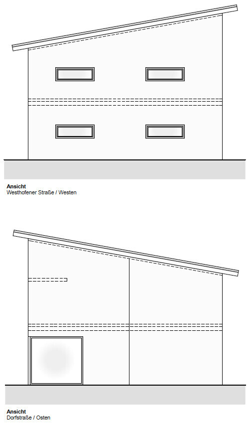

Two-story house with a pitched roof; west and east views with windows.

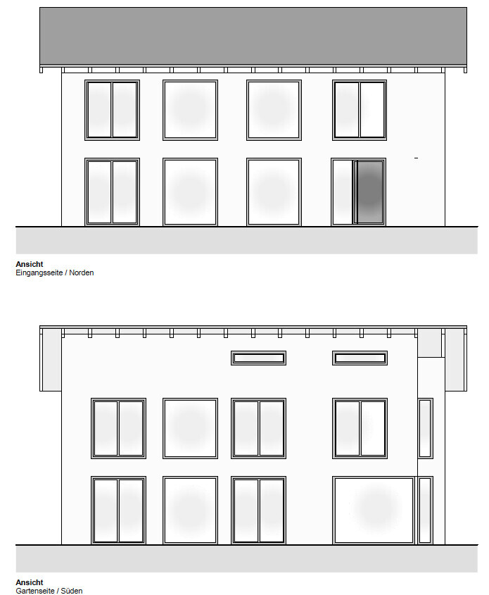

Two-story house with a flat roof; front and garden side with many windows (north/south).

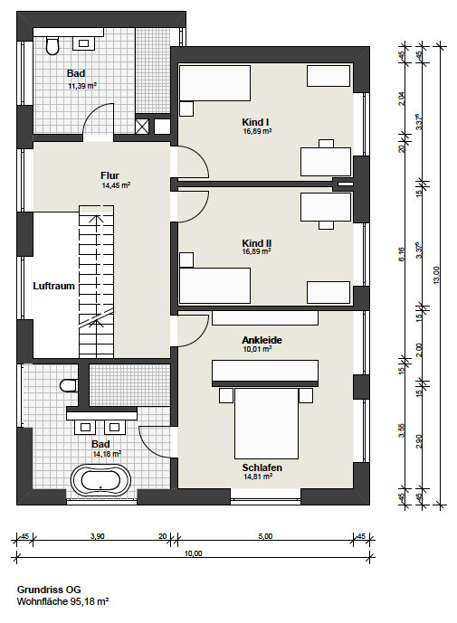

Upper floor plan: two children’s rooms, bedroom, dressing room, bathroom, hallway, open space, overview.

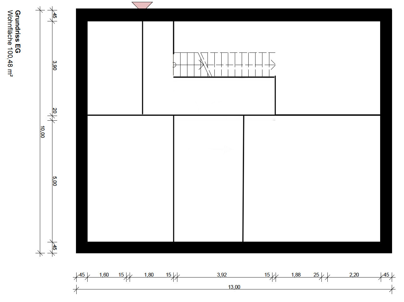

Ground floor plan: kitchen/dining/living with dining table and sofa; study; hallway; storage room; shower toilet.

Ground floor plan with stairs, interior walls and dimensions in a black frame.

What comes to mind when I look at the bedroom: Do you both get up together in the morning, or why would one disturb the other when getting up and dressing?
Where is the TV supposed to go in the living room?
The wardrobe is too small for children.
