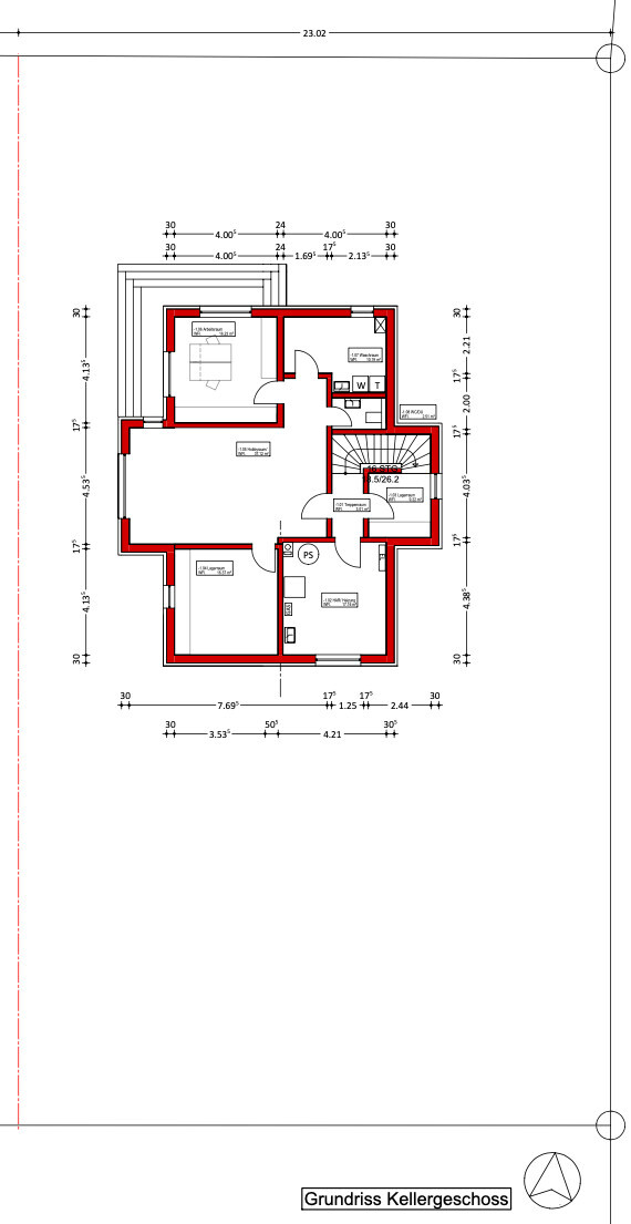

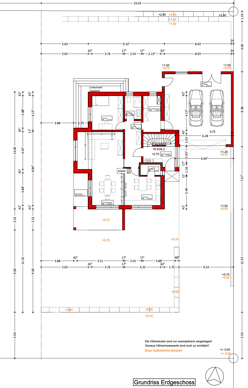

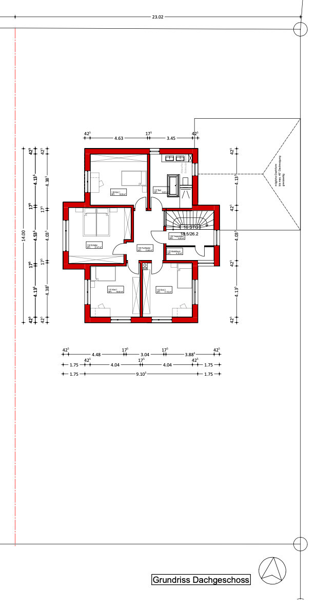

ᐅ Floor plan single-family house approx. 200 sqm double garage basement
Created on: 6 May 2020 01:02
J
jonashartfJ
jonashartf6 May 2020 01:02Hello everyone,
First of all, respect to this forum – it’s great to see so many valuable contributions here and how openly but constructively the discussions take place. This is the reason why we want to share our building project for discussion and look forward to feedback for optimization.
Plot size approx. 800 sqm (8600 sq ft)
Slope slight slope (2.5 m / 8 ft drop from north to south over 40 m)
Site occupancy index 0.4
Floor area ratio 0.4?
Building setback, building line and boundary 3 m (10 ft)
Edge development garage
Number of parking spaces 2 parking spaces
Number of floors 2 full stories (if we get approval for a deviation from the development plan)
Roof type gable roof
Architectural style modern gable roof house
Orientation southwest-facing garden
Maximum heights / limits none
Other requirements
Owners’ Requirements
Style, roof type, building type: gable roof, modern
Basement, floors: 2 full stories + basement
Number of people, ages: 4 people (2 adults, 2 children)
Space requirements ground floor, upper floor approx. 190-210 sqm (2045-2260 sq ft)
Office: family use or home office? family use + home office in basement
Guest overnight stays per year 3-4 times
Open or closed architecture mixed (open and bright living-dining area)
Conservative or modern construction style modern
Open kitchen, kitchen island separated by large sliding door
Number of dining seats 8
Fireplace yes, with seating bench
Music/stereo wall stereo wall planned
Balcony, roof terrace no
Garage, carport double garage
Utility garden, greenhouse yes
Other wishes/special features/daily routine, including reasons why or why not for certain choices: fixed attached terrace roof, practical entrance area, efficient use of space, house access via double garage
Who created the plan:
-builder’s company planner
-architect
-do-it-yourself
Architect – result of preliminary planning
What do you like most? Why? layout of rooms on the ground floor. Spacious living/dining area. Access between garage and house
What do you not like? Why? due to the maximum plot width, it is difficult to realize the house entrance with coat area as well as WC/bathroom nearby
Cost estimate according to architect/planner: rough estimate according to DIN 450,000
Personal budget limit for house including equipment: 500,000
Preferred heating system: gas condensing boiler (but no final decision yet)
After several iterations, especially for the ground floor, we believe we have a good concept. However, we would like to share all floors here for feedback, as we have seen on other topics that very good and valuable input appears, highlighting aspects we hadn’t thought of. Improvement suggestions are therefore very welcome.

jonashartf6 May 2020 09:08Thank you for the feedback on the budget. That is why we are realistically expecting over 500,000 euros. We will be doing some work ourselves, such as site development, roofing, and electrical installations.
J
jonashartf6 May 2020 09:12haydee schrieb:
Budget for house with basement, garage, and additional construction costs is not sufficient
Where is the terrace?
Why 3 children's bedrooms?
What will you use the basement for? The terrace is on the south side and should be accessible from the living/dining area (see dashed lines in front of the rooms).
A third children's bedroom is planned for possible future family expansion.
The basement will be used for:
- Home office
- Utility room including small workshop
- Storage for food and additional items such as children’s belongings, decorations, etc.
- Large room that can be used as a hobby room, for family gatherings, drying and ironing laundry
- Laundry room for washing clothes
