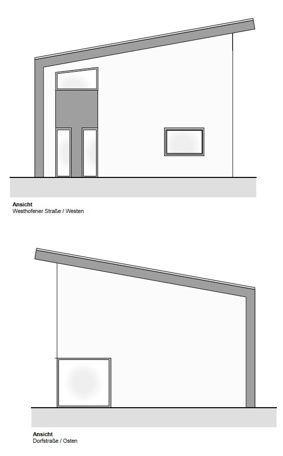

Two-story house with a pitched roof; west and east views with windows.

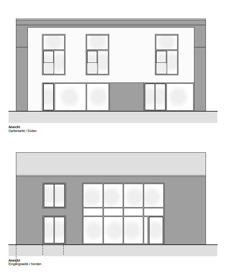

Two-story house with a flat roof; front and garden side with many windows (north/south).

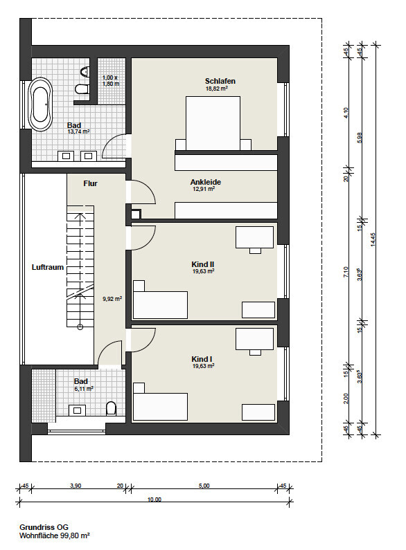

Upper floor plan: two children’s rooms, bedroom, dressing room, bathroom, hallway, open space, overview.

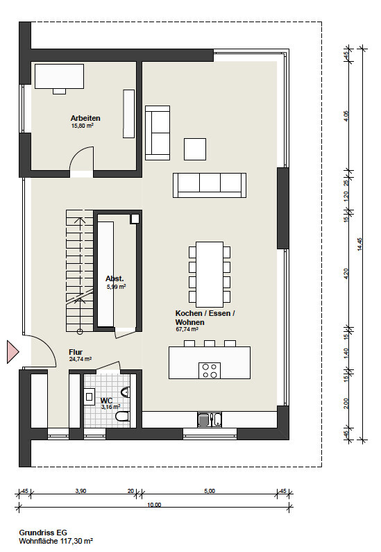

Ground floor plan: kitchen/dining/living with dining table and sofa; study; hallway; storage room; shower toilet.

Upper floor plan: Bedroom, Child room I, Child room II, Walk-in closet, Hallway, Open space, 2 Bathrooms.
Upper floor plan: Bedroom, Walk-in closet, Bathroom, Hallway, Open space, Child room I, Child room II.
Ground floor plan: Open living/kitchen area with dining table, sofa, study, hallway, storage room, half bath.
Modern building architecture with slanted roof overhang; West and East elevation views.
Two-story building facade with ground floor windows (south elevation) and glass front on the north side.

I think it’s pretty cool. I hope you have a good window installer.
One small thing I have to mention: Have the door in the kids’ bathroom open the other way. Otherwise, Child 1 regularly bumps their head. I would find the bathroom door next to the head of the bed in the master bedroom very uncomfortable. It would be better to rotate the bed 180° and place it against the opposite wall.
One small thing I have to mention: have the door in the kids’ bathroom open the other way. Otherwise, Child 1 keeps bumping their head. I would find having the bathroom door next to the head of the bed in the master bedroom very uncomfortable. It would be better to rotate the bed 180° and place it against the opposite wall.
The daycare room will open inward, and the bed will be moved to the other side—the architect just drew it incorrectly.
But knowing myself, there will probably be one or two more changes during the construction phase as well.
The window installer is its own story... Actually, it’s my wife’s uncle who is a metalworker with his own company, and my wife also works there. But he has no idea yet what’s coming his way.
11ant19 May 2020 18:25
darek6er schrieb:
Window manufacturing is quite a story... Actually, my wife's uncle runs his own metalworking business, and my wife works there as well. But he still has no idea what’s ahead of him.
Metalworker, well then it probably won't be PVC (which I think is also not really suitable here).
darek6er
19 May 2020 18:31
Metalworker, then it probably won’t be PVC (which I also consider not really suitable here)
Schüco AWS 90.SI+ profiles will be used
kaho67419 May 2020 19:59
Oh dear, for these windows it's best to have someone who usually builds windows for Hufhaus or similar. I definitely wouldn't hire someone who has never or rarely done this kind of work before, and especially not a family member if you want to maintain a good relationship.
