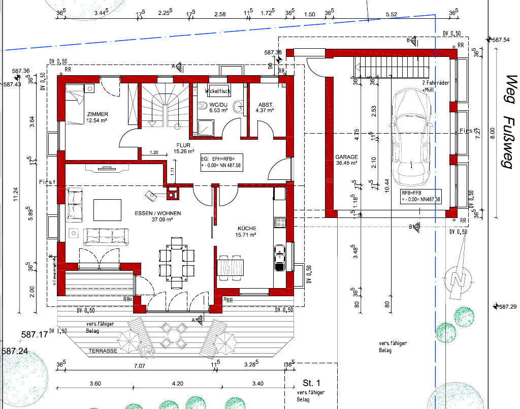

Ground floor:

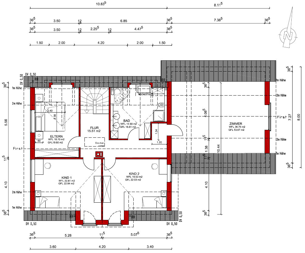

Upper floor:

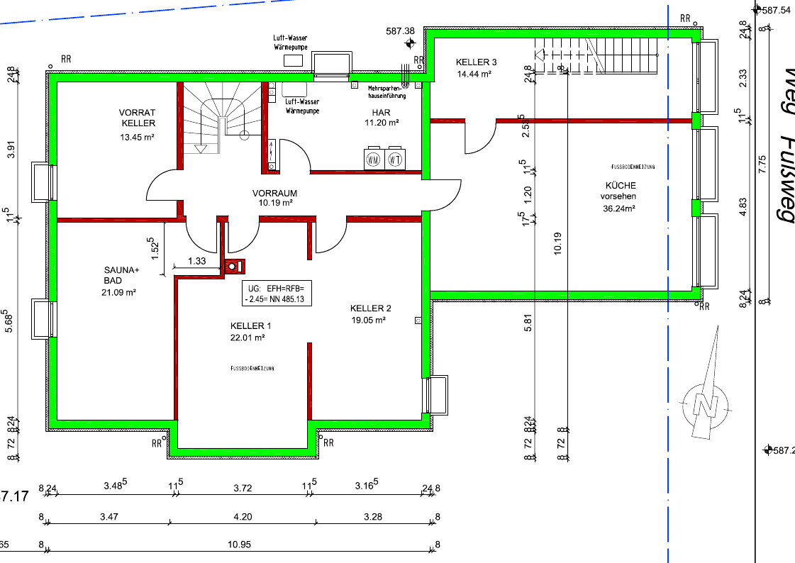

Basement:

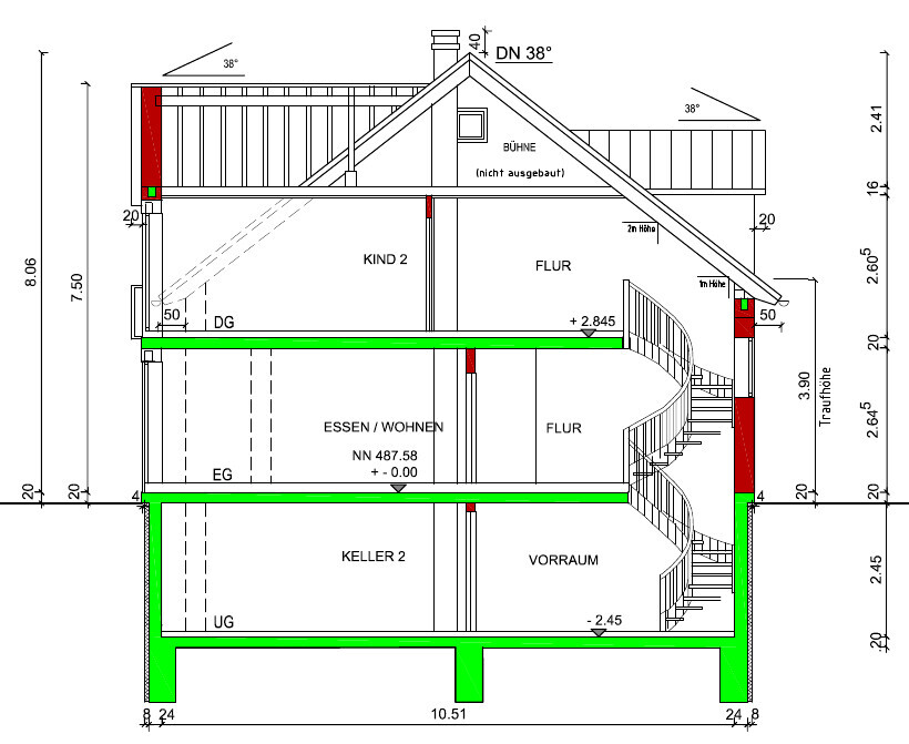

Section:
Your comments on the first version were really helpful! Thank you very much for that.
What do you think now about the revised floor plan?
Thanks.

Basement:
Section:
Thanks.
develloper2 May 2016 21:12I have been quietly following the old thread.
I really like the new floor plan and the changes that have been made!
Perhaps consider moving the door of Children's Bedroom 2 to the right side according to the plan, so that, as in the other rooms, a wardrobe can fit behind it.
Also, I personally think that not having a large shower included in the bathroom design is not ideal. A large shower is really great! Maybe move the bathroom door to the left side on the plan and place a shower behind it?
Much better:
a few things that still catch my eye:
1. I would move the front door closer to the bathroom; this way, you have a good spot on the wall facing the kitchen for a nice coat rack or wardrobe.
2. Kitchen entrance: consider how you want to arrange the kitchen later. It might make sense to move the kitchen door closer to the entrance so you can place cabinets along the wall facing the dining room.
3. The same applies to the children's room. Move the door a little away from the wall to gain more usable space.
4. If you widen the passage on the upper floor to the garage a bit (1.40/1.50m (4 ft 7 in / 4 ft 11 in) instead of 1.20m (3 ft 11 in)) – which means reducing the bathroom slightly – you have the chance to plan a larger shower. There is still room for a cabinet behind the bathroom door.
5. Install a skylight above the staircase to bring more natural light into the upper floor.
6. On the ground floor, I would either include a sidelight next to the door or alternatively add a window.
Hello BeHaElJa,
As mentioned in the previous thread, the kitchen will not look like the architect’s current design. Unfortunately, the architect is not able to handle the kitchen planning. He already does not implement everything we discuss during meetings.
We recently started the kitchen planning with a kitchen studio, and we have another appointment there next week. We hope to have a plan by then that we can share here.
We have been considering the kitchen layout. Originally, we wanted a closed kitchen, but now we also like the idea of an open kitchen with a roughly 3m (10 feet) long countertop on the west side facing the dining area, and a storage area on the east side. This could allow for floor-to-ceiling doors instead of a window on the south side. However, we still have some concerns about privacy and visibility.
Thanks for the suggestion regarding the lighting in the hallway (upstairs and downstairs). Do you have any ideas on how to solve that?
