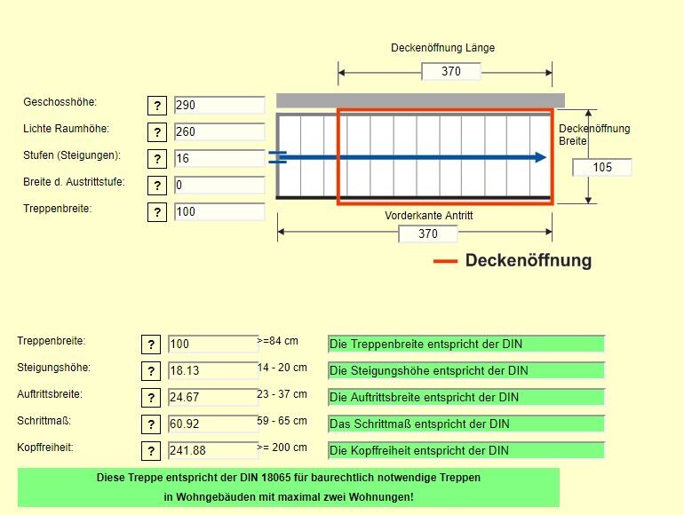

j.bautsch10 Mar 2019 10:34The staircase could actually accommodate about 10–30cm (4–12 inches) more length, but I didn’t want it too close to the entrance. If it’s extended further toward the back, eventually there won’t be anything left of the niche in the children’s room... However, it might even be possible to do without it, as the rooms are quite large anyway.

Visually, it looks like the staircase opening is built over a bit too farI built over the staircase including wall thickness by 50cm (20 inches). According to the stair calculator, that is still okay; the clear height is then about 205cm (81 inches). But you could also leave out the niche on the upper floor, since the rooms are actually large enough.
kbt09 schrieb:
Franky73 with 94 sqmIn that plan, the staircase doesn’t work at all with the tread run. I would say you need at least one meter (39 inches) for the tread run.
