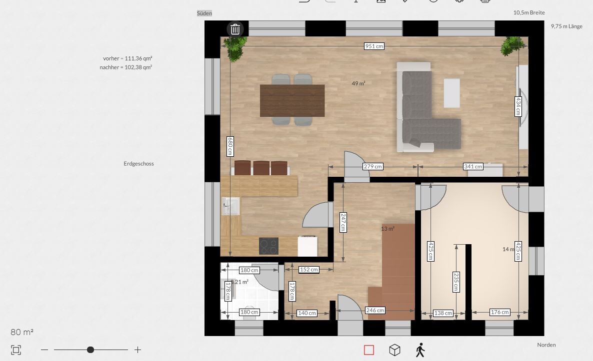

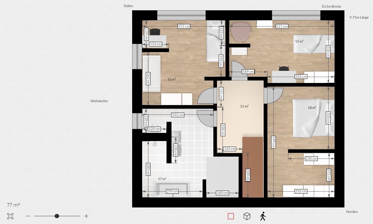

we are in the process of building a single-family house with a basement suitable for living. This is the design we have come up with. I would like to hear from you if you see any possibilities for improvements.
On the ground floor, there is a side entrance door on the right. The carport will be located there.
In the basement living area, the children's rooms face south. From there, it should be possible to access the terrace and the garden.
I look forward to your tips and suggestions!
Ground floor plan: open living and dining area, kitchen, bathroom, hallway, and two rooms.
Apartment floor plan: kitchen, living room, hallway, and bedrooms with dimensions.

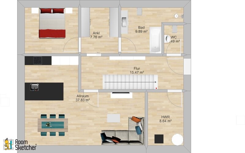

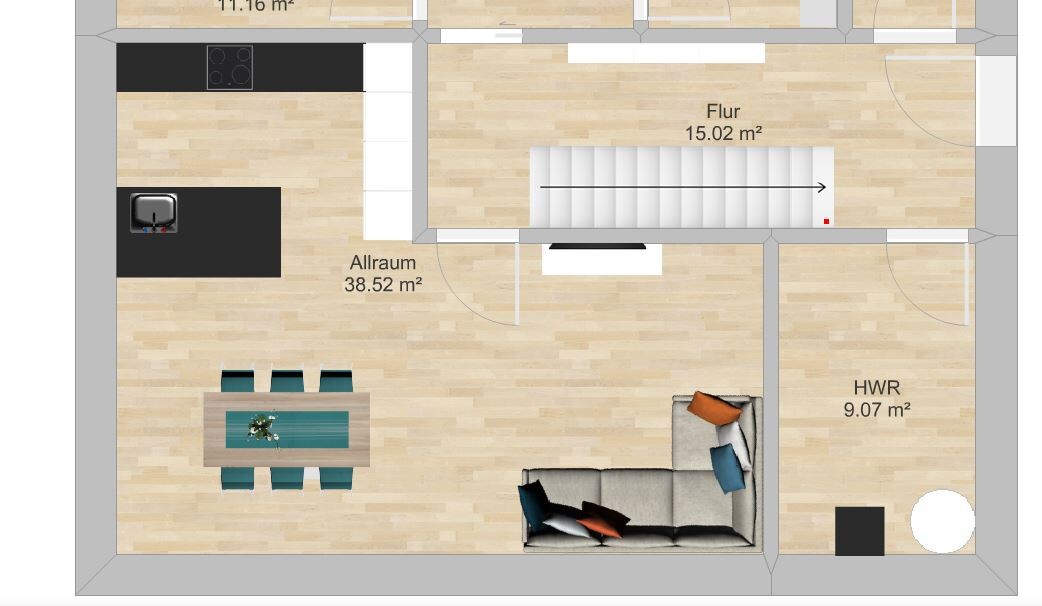

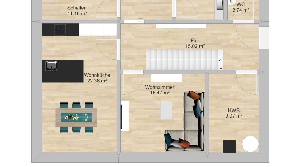

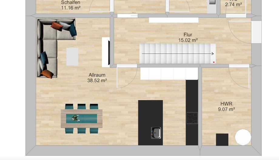

So, I have put together several versions of the "all-purpose room" here.
Floor plan of a living and dining area with kitchen island, staircase, hallway, and utility room
Floor plan of an open living space with kitchen (island), dining table, sofa, hallway, and utility room; staircase.
Floor plan of a house with open kitchen/living area, dining area, living room, bedroom, hallway, WC, and utility room.
I don’t really think swapping it would improve the layout. The kitchen just doesn’t fit well in the upper corner in my opinion, and it ends up being a noticeably smaller kitchen as a result (although of course, it depends on whether that is sufficient for the original poster).
The separation in version 3 is optional even with the kitchen layout, the sofa can be positioned as shown in version 2.

The dimensions are basically fine as they are; I have a pretty good overview. For example, the sofa in my case is 2m x 3m (6.5 ft x 10 ft).
Unfortunately, I haven’t found any other solution with a different staircase given all the original poster’s conditions *eye roll* I’ve really tried a lot of rearranging, but it’s not easy...
The living room in my plan is always at least 3.8m (12.5 ft), which I find sufficient considering the quite extensive room program here.
However, I have worked on one small change:
I moved the living room down, and the right sofa wall is now 3.6 m (11.8 ft). To do this, I extended the house a bit, which made the bathroom somewhat larger. The kitchen wall is 3.6 m (11.8 ft) wide, the left side by the dining table is about 6 m (19.7 ft), and the bottom wall is 8 m (26.2 ft).
The bedroom is also 3.6 m (11.8 ft), the dressing room 2.5 m (8.2 ft), and the bathroom 4.2 m (13.8 ft) (the guest toilet got a bit narrower, with internal dimensions of 1.3 m (4.3 ft)). The upper rooms are all 3.1 m (10.2 ft) long (or wide, whichever you prefer).
The living area is now no longer quite an open-through room.
