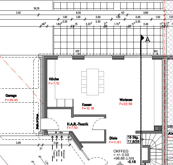

my first post.
In our house, we only have this option to arrange our kitchen, dining area, and living room. Does anyone have ideas on how we can divide the space? The kitchen will be completely redesigned.
Best regards, Stefan
Floor plan of a house with kitchen, dining area, living room, and garage
Manu1976
26 Jan 2015 22:27
What is on the other side of the stairs? The toilet and something else?
I also find this floor plan very difficult to design. How many people will live in the house? How many people usually gather for parties? How big is your sofa?

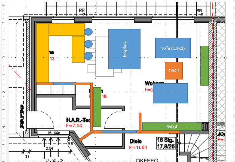

26 Jan 2015 22:38
Tricky... I gave it a try. The kitchen window would then need to have a sill height of 1m (3.3 ft).
I assume this is a semi-detached house?
2D floor plan of a living, dining, and kitchen area with sofa and dining table
milkie
26 Jan 2015 23:07
I prefer BeHaElJas idea. I would only arrange the living room differently. Maybe extend the small section of the wall further into the room, possibly only half-height, and place the sofa there.
The kitchen could also consist of a single wall unit and a peninsula, which would allow for a patio door in between.

DERSTEFAN
27 Jan 2015 06:20
Let's ask it this way: what do you not like about the proposed layout?
Hi -- I don’t like that I have a direct view of the kitchen – but I have been going over the plans again during the night. I think I have found an ideal solution. I can adjust the walls, meaning I can make the wall by the stairs shorter or longer, or also make the utility room smaller.

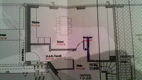

DERSTEFAN
27 Jan 2015 06:24
Here is a suggestion from me
2D floor plan of a house with kitchen, dining area, and living room
