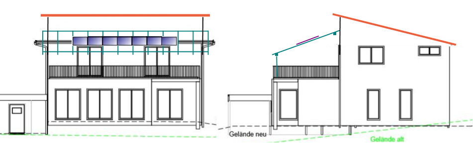

Alright then: to prove my lack of drawing skills, I tried sketching myself – without incorporating my parapet variant, so it only shows a symbolic single support under the foot plate of the (apart from the solar panels) "uncovered shed roof" – just to illustrate the roof shape:

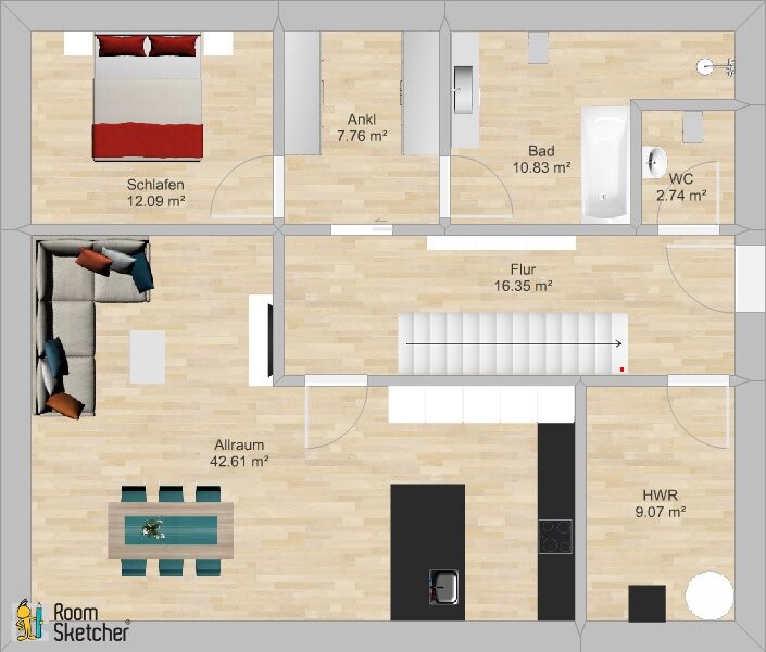

j.bautsch9 Mar 2019 22:55How about this:
Ground floor
The hallway has been made slightly wider.
I removed the offset.
The utility room is now only accessible through the hallway, allowing for more kitchen cabinets, so no more storage of supplies is needed in the utility room.
The TV is no longer mounted on the bedroom wall.
However, the sofa could also be arranged with its back to the room again.
Area 101.45 m² (1092 sq ft)

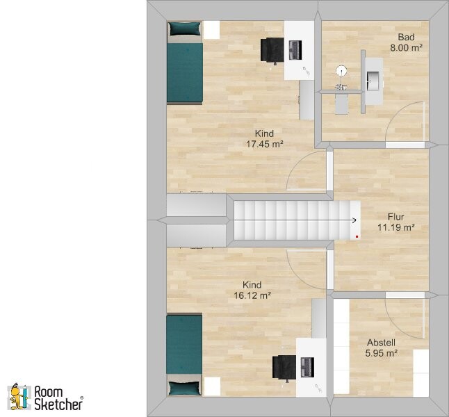

Upper floor:
Mostly unchanged
Area: 58.71 m² (632 sq ft) (the width could still be increased if one-story design is still possible; I’m not very familiar with that)
Total area 160.16 m² (1724 sq ft) (slightly larger, mainly on the ground floor)

Total area: 160.16 m² (1724 sq ft) (slightly larger, mainly on the ground floor) I find this version definitely more interesting! But... the house keeps getting bigger! Originally we wanted a maximum of 140 m² (1507 sq ft), now it’s 148 m² (1593 sq ft), and with your version it would be 160 m² (1722 sq ft). As I said, everything still has to remain affordable.
I also think your bathroom layout with the T-shape is better solved than the current version from our architect!
