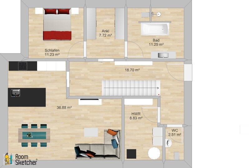

I wouldn’t like that in a house of nearly 150m² (1,615 sq ft), the combined living, dining, and kitchen area is only 37m² (398 sq ft). When the children have moved out, you end up with many rooms and bathrooms, but the living room is still small. I would rather plan a house where a wall can be removed later to enlarge the living area. A few years pass quickly, and then the children have left, and the house no longer fits your needs.

11 Mar 2019 07:40
Franky73 schrieb:
What do you think about this option?
I would strongly recommend using a sliding door for the kitchen entrance... I find the drawn door rather impractical. I planned a double sliding door.
I would definitely not design the hallway narrower than 2.2m (7 ft 3 in). The staircase requires about 100cm (39 in), leaving 120cm (47 in), but you also have to deduct plaster thickness from that...
I would like to design the kitchen with a width of 3.7m (12 ft 2 in), so it can fit 3 × 60cm (24 in) tall cabinets and 2 × 90cm (35 in) base cabinets with the cooktop centered above, plus side panels of 5cm (2 in) each (don’t forget to deduct plaster thickness). If the TV wall doesn’t get shorter (in my plan it is 3.5m (11 ft 6 in)), then the house will need to be extended to the left.
I mostly kept the entrance area as you had it, except for the bedroom—I gave it a width of 3.5m (11 ft 6 in) because 3.36m (11 ft) in your plan is really tight. Realistically, a bed with a frame is about 1.9m (6 ft 3 in) wide, and you need at least 90cm (35 in) on the entrance side for the door radius, leaving only 56cm (22 in), which is definitely not enough. So I added those 15cm (6 in) so you get at least 70cm (28 in) behind the bed.

I would advise you to take a step back, because this simply won't work. You will soon have nearly 30m² (320 sq ft) just for the hallway, sorry but that is complete nonsense.
There is only dithering here, you won't make progress like this.
