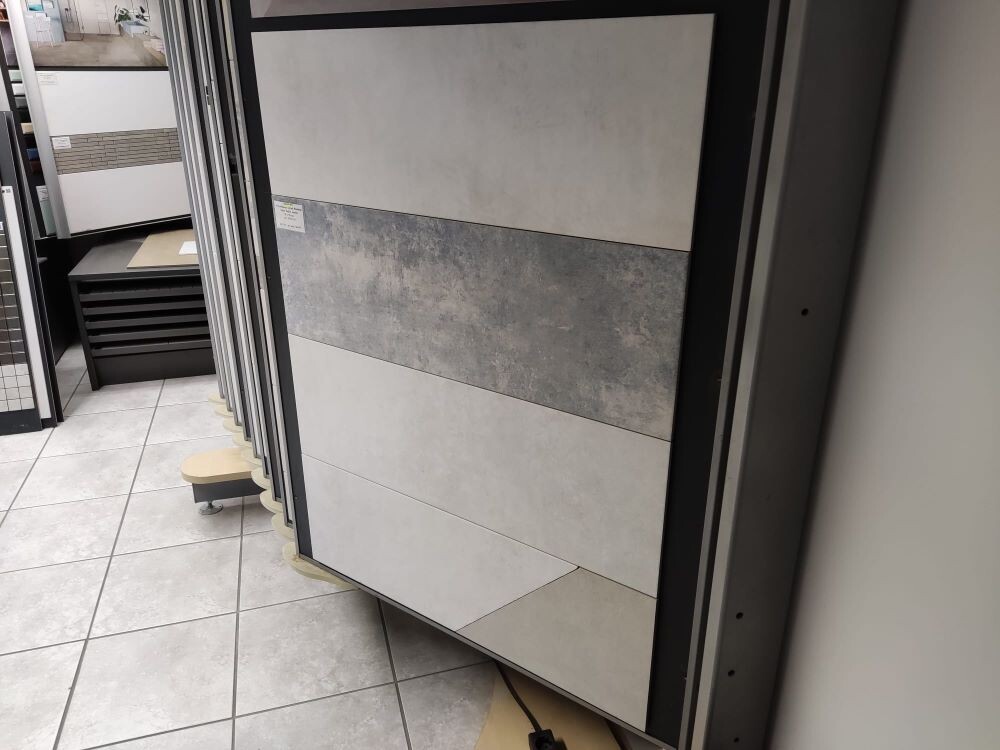

What exactly do you want to achieve with decorative tiles? What kind of tiles are they? The same ones, just in a different color or with a pattern?
If I see that they are darker than the main tiles, then they create a certain effect.
But yes!!! If you have a light color under the vanity, you emphasize it indirectly with the light shade. If you go darker, the area under the vanity visually recedes.
If you keep an inset box in one color, you emphasize that surface or create a 3D effect—sometimes intentionally, in other cases not so much.
When framing an edge, you usually frame the entire element, including the sides of the bathtub, not just a small area at the back. You should consider a bathroom with its built-in walls in 3D, not like an ordinary bare room.
mayglow schrieb:
Basically, at the sink, if you extend the countertop, the visual difference is probably not that noticeable whether you do just the top row or the entire area.

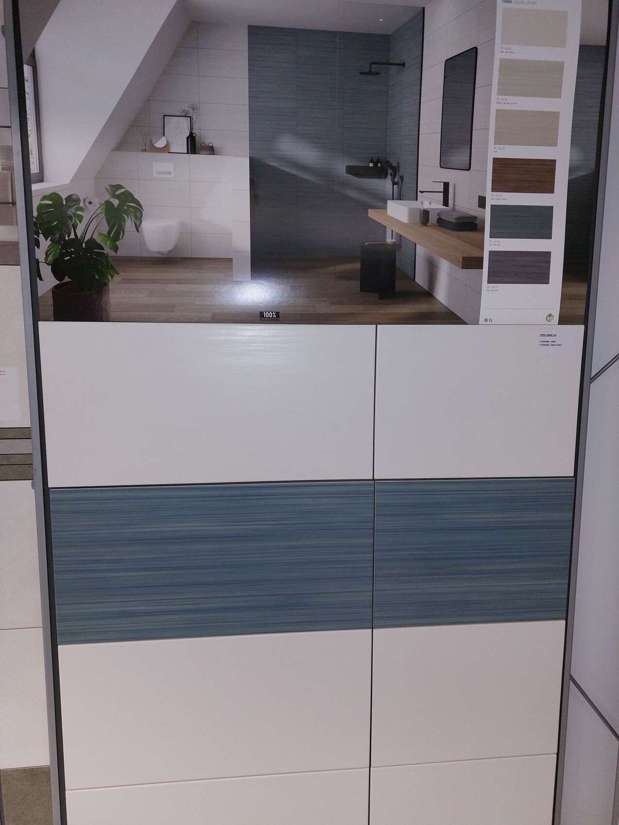

Actually, the idea for the top row came somewhat from the 3D structure. Kind of creating the illusion on both sides that the setback is at the same height. But maybe that’s just nonsense, or at least on the bathtub side, we should have included the side walls, or something like that. Either way, it was basically intentional to make it look a bit more finished. But amateurs often have silly ideas...
We currently requested two combinations for the wall tiles. I can’t find one of them online at all, and the other looks quite different in color in the online photos compared to real life. And my phone camera is also lousy… but basically, these were the two options:
A)
- Decorative tile: Agrob Buchtal, Tailor, 30x60cm (12x24 inches), "Decoration element Denim"
- Remaining wall tiles: Agrob Buchtal, Tailor, 30x60cm (12x24 inches), stone matte cotton beige
(The photo is not of the 30x60cm (12x24 inch) version and ACTUALLY the decorative tile is a faded denim blue, not gray… my phone really distorted it badly) So uh, the photo is unusable.
B)
- Decorative tile: NIKA, 30x60cm (12x24 inches), Y-NIK94A, decorative blue
- Remaining wall tiles: NIKA, 30x60cm (12x24 inches), Y-NIK90A, white
(Looked somewhat less gray/greenish in real life)
Having the whole bathtub block and the entire washbasin block blue is probably too much for us. As has already been pointed out here, our bathroom is quite small.

Bertram1006 Dec 2023 08:16The entire shower covered in dark decorative tiles makes the shower area feel quite small and dark when you are inside. I know a shower with medium-gray decorative tiles and find it attractive only from the outside, not while actually showering.
I wanted to give some feedback, even though I feel a bit silly doing it since we hardly followed your advice (oops). In the end, we left things as described on the previous page. It might seem a little odd around the sink area, but having the whole space colorful was too much for us, and just doing the shelf felt too little—and then we started running out of time. Now, looking back, maybe just doing the shelf would have been nicer, especially since I suddenly see that kind of detail in about every other bathroom, ah. I’m still really grateful for the feedback, even though we didn’t really apply it in the end.
We also went back and forth about the shower but ended up leaving it “all blue.” It was basically the same kind of dilemma: with “just a little,” we weren’t sure what would work best. I’ve often seen something like a strip running vertically behind the shower controls. But that would feel a bit weird for us because I don’t think our controls are on the back wall but rather on the side wall.
I think my main conclusion about the bathroom is that the planning didn’t really go smoothly. It was kind of fragmented in terms of when decisions were made. From the builder’s side, there was just one appointment asking, “Do you like the sanitary fixtures?” (Yes, that’s fine) and another appointment for “Which of the standard tiles do you want?” (Not really any of them…) After that, we got to visit a tile showroom, and the company that’s doing the work for us gave some generally pretty good suggestions. But at that point, it felt like there wasn’t much guidance tailored to OUR bathroom. (Like, a lot of general options but no comments such as “We usually use 120cm (47 inches) high tile backsplashes—does that really make sense here?” or “Our bathroom is quite small, so I don’t think large floor tiles will work well,” things like that came from us, not from them.) Maybe they were able to do that (probably yes), but they definitely didn’t have our plan in mind, and maybe we didn’t ask for enough support, or their understanding was that the builder would handle that... But these things really belong together; it’s hard to choose tiles if you’re not sure whether they’ll even work in your bathroom. Maybe we also should have been more proactive about insisting on that (as my mother-in-law always says, “Only those who speak up can be helped”). So that’s what I’ll take away for “if we ever build again” → to ask earlier and more strongly for support.
So yes, there was quite a bit of back and forth, but in the end, it was kind of a “oh well, it’s fine, we’ll just do it like this.” Well then, we’ve got a somewhat odd bathroom.
Thanks again for all the input here!

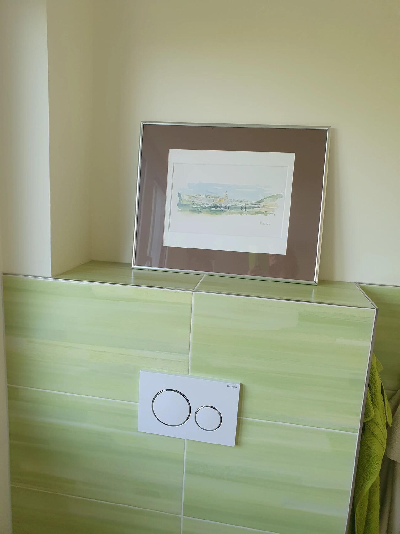

Bertram1005 Jan 2024 14:36mayglow schrieb:
Well, then we’ll just have a bit of a strange bathroom.We’d like to see that.Jokes aside, I think you’ve done a great job. You have to balance time and stress, after all. I believe your bathroom will turn out well! It definitely sounds reasonable. Besides, no one here is claiming the forum could design a nicer bathroom than you.
I have tiles in my bathroom and hallway that would probably be considered outdated here, but I really like them. Just in case that’s reassuring...
Pinkiponk5 Jan 2024 20:06Bertram100 schrieb:
I have tiles in the bathroom… that would simply “fail” in this forum, and I really like them. Just in case that’s some kind of reassurance… Plus @mayglow: My tiles wouldn’t just fail in the forum; they actually have failed. However, we have been living with them for about 1.5 years now, and their spring green color produces the desired psychological effect. 🙂 The white push buttons don’t quite match, but we couldn’t find anything better.
(What a lovely pun: Dear mayglow, our bathroom tiles are spring green.)
