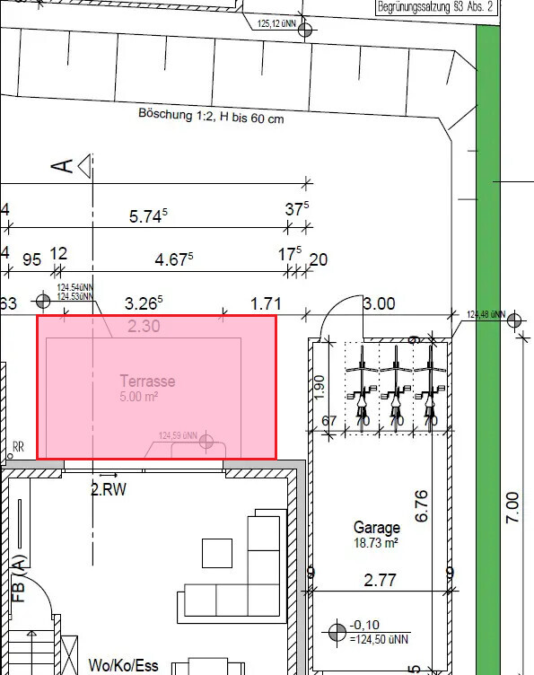

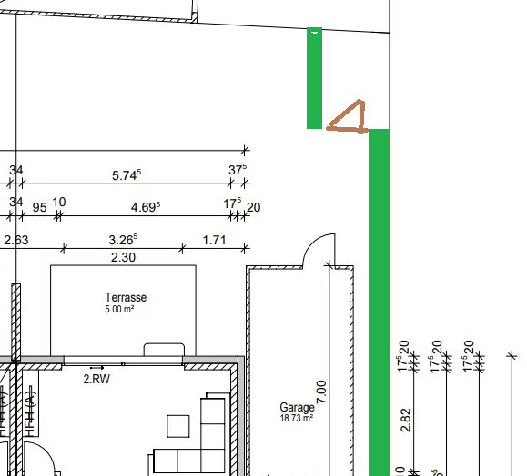

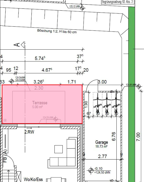

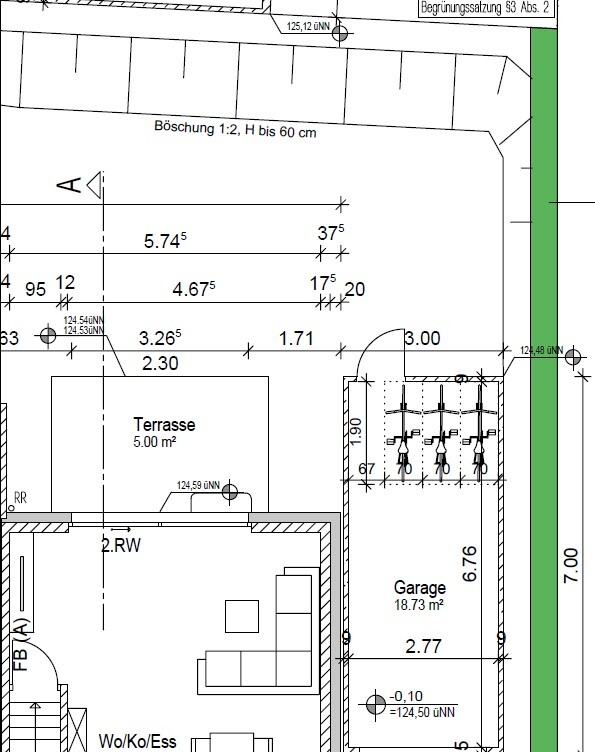

We are currently thinking a bit about the outdoor area. Since it’s a pre-planned townhouse development and generally not a large plot, we don’t have much influence over some things, or there are more done deals compared to what an individual home builder might have. Basically, there is always the recommendation to plan the outdoors as well, but moving the house or similar options were never really on the table for us.
I mostly only have small partial views myself, so apologies in advance. Here is a bit more of the surroundings added with my excellent Paint skills (we are marked in red). The railway tracks might be a bit lower, but we definitely are above them — I could check if I can find elevation data. Otherwise, directly south of us is just a neighbor’s garage and not much else.
In our ground floor plan, you can see the whole plot, although overall dimensions are missing:
Then we have this section with a few more contour lines of our garden (Nope, I don’t have a larger section either, would like to get one, I will check if I can obtain that). So, our plot has a slight slope (about 90cm (35 inches) along the length of the plot).
On the right side, marked in green, is our mandatory hedge, which is specified in an urban development agreement: Hornbeam hedge facing the street with 5 plants spaced 1m (3 feet) apart.
The developer is doing the following for us:
- Essentially, during earthworks, "height differences to the development and new construction levels will be adjusted" and "In the area of open spaces and gardens, height compensation will be done using locally available soil or, if necessary, delivered soil/topsoil." Also later in the contract: "Terrain modeling will be carried out as required on-site." (which I assume means creating the slope.)
- Partition wall to the neighbor made of sand-lime brick masonry with flush pointing
- Paving the terrace (here’s the question if we want to extend it, and if yes, by how much)
- Planting the mandatory hedge (we would actually like to have an access to the street there, like a gate in the hedge or similar, but we’ll see if we can resolve that with the city after handover or if the developer can still do it)
- (Not included here) Paving of the driveway (+ prefabricated garage)
At some point, someone from the developer will probably approach us (at least that was announced, if I remember correctly), possibly to discuss if we want to enlarge the terrace and maybe also about the slope. It doesn’t hurt to start thinking about this in advance.
Some of our neighbors apparently requested terrace extensions, roughly like this:
Personally, I think having a green strip next to the terrace isn’t bad at all. You don’t have to pave everything. But how wide should it be at a minimum? 50cm (20 inches)? 80cm (31 inches)? Will anything grow there? (As shown at the very top, the terrace faces almost due south and there is no tall building in the south or anything like that.) At the same time, I’m thinking, it probably needs to fit the size of the paving slabs (which we do not know yet). But my current idea would be more like this:
And then place a small flower bed and/or a herb planter or something similar on the left/right side? Honestly, we have zero experience with gardens and such, but I think our plot is manageable enough that we can just experiment. In the worst case, it won’t be perfect.
Regarding the slope, my rough idea is "something like shown makes sense and then plant it." It’s not ideal for the garden to be “set lower” and look toward the neighbor’s garage, but with some greenery planted, I think it will be fine.
Then there is our mandatory hedge. There is an urban development agreement that requires it. Our terrace is also on the second row of houses, and I find it a bit strange that we no longer have direct access to public land from there (except through the garage). On the other hand, if we get too loud there, we might have to grant our neighbors right of passage through our garden, so maybe that’s not a good reason to avoid it. But basically, I would like to be able to access the street from there when needed with bikes or garden tools, even if it means a small step. I think then we would have to come up with some compensatory measure for the lost section of the hedge (presumably with a maintenance agreement). The question is what would be suitable, like a hedge by the parking space? The hedge to the townhouse neighbor? Planting a tree? We should also consider how wide the gap should be and how many plants would need relocating. I mean, this might all be irrelevant if the city doesn’t agree, but it would probably be good to have a proposal when we ask. Fundamentally, we could either try to install a gate, something like this:
or try something fancy like a hedge arch?
On one hand, it feels a bit strange to think “already” about the garden at this stage. On the other hand, we need to have some idea of what we want in case we want to ask the developer for changes later.

mayglow schrieb:
I actually think having a strip of greenery next to the patio isn’t a bad idea. You don’t have to cover everything with paving, after all. I agree, and for more ideas I recommend checking out the local “colorful gardening chat thread” (or whatever it’s called—I’m just a reader there since I have two left green thumbs).
Costruttrice28 Aug 2023 15:05We also had a gate from our garden to the street, which meant interrupting the hedge. To maintain privacy at that spot, we planted the hedge plants about 1.5 m (5 feet) back from the gate, toward the garden, so you could access the gate from the garden side and from the street you would see the gate framed by the hedge plants. I hope this makes sense… Maybe this could be an option for you as well if you have enough space. That way, the city would still have its hedge—just a few plants set further back—and you would have your gate.
WilderSueden28 Aug 2023 16:14Your sketch might conflict with the slope.
I also don’t believe in any compensatory measures for transplanting a beech tree from your hedge. Whether you want privacy screening at the gate is something you need to decide. I would generally suggest starting without it since any path around the corner is inconvenient and will take up space in your already small garden. Let the house be completed first, then sit on the terrace and consider where the gate should be located.
As for the terrace itself, I would only make it large enough to comfortably fit the table. For birthday parties or other gatherings, you can always set up a folding bench table set on the grass. Definitely include planting in front of any partition walls.
