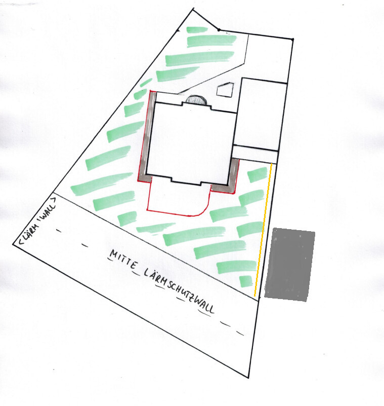

I would now like to build a wooden privacy fence on our side of the property, something with a trellis for climbing plants, and plant greenery in front of it so that when looking toward that corner, we see a nice garden instead of the metal.
Am I allowed to do this without any issues? Are there any minimum distances I have to keep? I’ve attached a sketch where I have marked the metal shed in gray and the desired privacy fence in yellow. Of course, I wouldn’t do this without discussing it again with the neighbors first, but I would like to know where I stand legally. I haven’t been able to find much information online, only about enclosures with fences.

Am I allowed to do that without any issues?Yes. kati1337 schrieb:
Do I need to keep any distances?No, as long as your privacy screen stays under 2m (6.6 feet) in height. kati1337 schrieb:
a few centimeters onto their property.That is not allowed. Either right on the boundary or with a 1m (3.3 feet) gap. kati1337 schrieb:
I don’t want to get into disputes with them over something like this.Good attitude. kati1337 schrieb:
Generally speaking, the municipality never informed me about neighboring properties.The Lower Saxony Building Code only requires that if the neighbor wants to deviate from regulations protecting neighbors. kati1337 schrieb:
If I now set up a wooden privacy fence, say 20cm (8 inches) from the boundary, am I legally safe?Yes. kati1337 schrieb:
Where should I look that up? The Building Code?No. kati1337 schrieb:
Construction regulations?Yes. Section 5, paragraph 8, number 1, letter b). kati1337 schrieb:
Are there special regulations just for gardens?Not that I know of. But there is the Lower Saxony Neighbor Law, sixth section. kati1337 schrieb:
Is it always decided by the federal state then?Yes. kati1337 schrieb:
How much distance from the boundary should you keep?None or at least 1m (3.3 feet), unless the structure is taller than 3m (10 feet) or longer than 9m (30 feet), or if another building already stands on the boundary such that the total length exceeds 9m (30 feet), or if on any other neighboring boundary except the street side, one or several buildings already stand such that the total length exceeds 15m (50 feet). kati1337 schrieb:
With the privacy fence?Up to 2m (6.6 feet) height, it doesn’t matter. kati1337 schrieb:
How we handle the enclosure afterward.That’s not your concern. According to Section 27 of the Lower Saxony Neighbor Law, paragraph 1, number 1, your neighbor must enclose their property.Escroda schrieb:

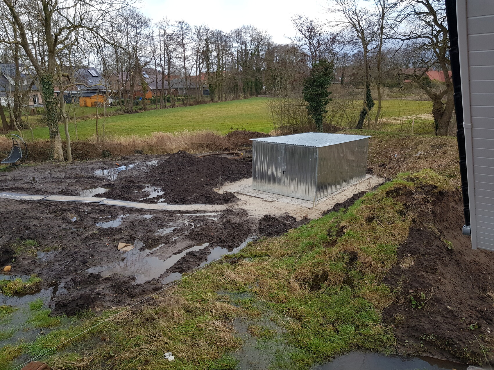

I just checked, and it actually stands exactly on the boundary. Well, not the shed itself, but the paving slabs do run along the boundary line.
So, we need to discuss the fence again. We had previously agreed to enclose the area with a shared hedge on the boundary, but it seems that’s no longer an option. I’m not willing to give up part of my hedge from my property, especially since we already have a very small garden.
kati1337 schrieb:
By the way, that is the centerpiece.However, first of all, it is set so deeply that the problem is almost completely resolved by simply "looking over it," so to speak; and secondly, I would just consider it a container for storing the construction equipment securely.https://www.instagram.com/11antgmxde/
