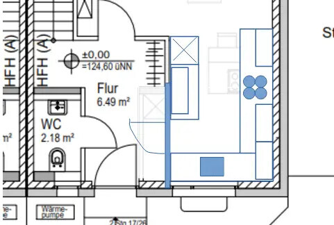

The final kitchen adjustment by @ypg. I think this is a good solution; the kitchen window at the top of the plan then has full effect. The cooktop would be placed to the left of the tall cabinets on the plan... you could even choose a vented range hood in this setup. I would position the sink opposite, on the right wall. This way, it’s less visible from the sofa, and the area in front of the window serves as a nice prep space between the cooktop and the sink.

We are still in discussions with the developer.
So far, we have had two kitchen planning appointments (at the kitchen showroom) and had a rough proposal based on this one:
And another rough proposal based on this one:
We liked the second proposal much better once it was fully planned out, and after sleeping on it a few times, we prefer the dining table closer to the kitchen instead of swapping the living and dining areas (which was the original idea of the first plan).
The kitchen planner and my husband both think it makes more sense for the kitchen door to open inward, even though the dishwasher is there. This is roughly where the plan stands right now.
Besides that, we have received approval from the developer for an additional window on the ground floor along the long wall, with a fixed lower section and an openable upper section. My husband thinks this is better regarding dirt anyway, while I’m a bit sad about losing the shortcut to the garage. But at least more natural light is a definite plus. I’ve asked again why this is the case (the email only went out today, so no reply yet). My husband is happy with it, and in my opinion, the dining table also works better with more light there.
We haven’t made any requests regarding the staircase. I actually don’t want to, because I see the domino effect it would cause (especially upstairs), and my husband is too lazy to deal with it himself. We are basically at the point where there is a finished plan from the developer, and any changes mean paying for planning hours, etc., and especially upstairs, that would be quite a lot. It’s also generally known that “custom planning with a developer who doesn’t usually do that” often doesn’t lead to ideal results. Honestly, I’d rather save that money for other things right now, such as preparing for photovoltaic solar panels and a wallbox, or a toilet with bidet function. Just putting it plainly.
