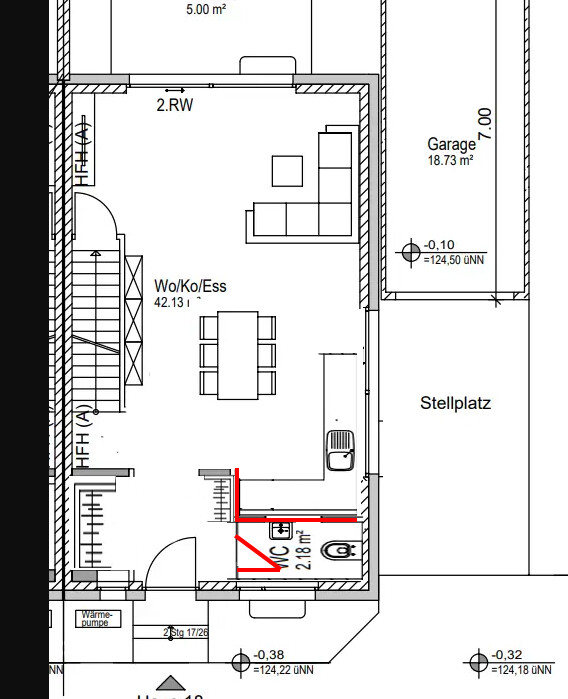

I think it’s a solid floor plan for young families, but the ground floor worries me a bit. I feel maybe a different staircase shape would have helped, but as far as I’ve been told, that cannot be changed.
How do we best arrange the ground floor? Should we still make some changes here?
Ideas for potential changes to the ground floor
Maybe reduce the kitchen size and straighten the hallway wall? (We’ve discussed this idea in the kitchen forum but haven’t talked to the planner yet.) The scale is off here (I think my cabinets are too large). The rough structural width in the kitchen at the narrowest point is 248 cm (98 inches), so roughly 240 cm (94 inches) minus about 130 cm (51 inches) for both kitchen sides would leave 110 cm (43 inches) aisle width. Also, the window would be moved to the corner. In return, there would be more cloakroom space in the hallway. Bad idea? Opinions?
Another question is a bit… can we reduce the distance between sofa and TV? I’ve just sketched in our current furniture; it would look roughly like this (sofa 275 x 220 cm (108 x 87 inches)).
Ideas so far include putting a shelf behind the sofa (but that blocks the terrace door more). Any other ideas?
mayglow schrieb:
Oops, I copied the design without the door drawn in. But I think you can figure it out with a bit of imagination 😉 It’s probably unavoidable that the dishwasher blocks something in a narrow kitchen, unless in my imagination the door opens inward, and the flap locks the door securely and decisively – which would be an argument in favor of a sliding door. Although I have to say that, combined with the centrally located bathroom, I increasingly like the idea of moving the kitchen to the back; then using the suggested window as a secondary entrance door (?)
By the way: my staircase measures only 3.50 meters (11.5 feet) in length. So a spiral staircase to the upper floor really makes sense.. it shouldn’t be more expensive. I see two likely possibilities for the spiral staircase: second, the builder also has a model with a spiral staircase of the same width and identical floor-to-ceiling heights, which they assign to this house, or first, the answer is an irresistible defensive price – mind you, not out of stinginess or malice, but the common wisdom of an average homeowner unfortunately doesn’t reflect the cost structures of the homebuilder business.
Seriously: personally, I would be cautious about excluding the stairs entirely from the contract and subcontracting them. That is already a risk when building with a general contractor, and when buying from a builder, that risk is on another level. But I’m sure that in the builder’s logistics alone, just fulfilling a special request (without the domino effects) means the setup costs for only three staircases are already higher than the price a subcontractor would charge for a complete single set of stairs. Therefore, my conclusion: if the desired staircase is offered in another project, the request is easy to fulfill (probably for a symbolic additional cost of around two thousand for the three sets) – otherwise, you’d probably be shot down just for asking. What seems like a harmless forum thread here could lead to the special requests department needing to hire someone just to handle refusals *LOL*
mayglow schrieb:
We had a thread open in the specialized forum for this kind of thing, and the recommendation was almost unanimously in favor of this proposal:
Likely with the door opening into the hallway or a sliding door or something similar. (My husband is currently very enthusiastic about the extra door, I don’t see it as urgently necessary. But he definitely has the final say in the kitchen since he is the main user.)
My concerns about the window being partially blocked by the tall cabinets didn’t seem to bother anyone much. And my suggestions with a U-shape and a two-row layout had zero supporters.
My husband and I currently prefer having just the fridge instead of three tall cabinets, with a cabinet block next to it for a coffee corner, something roughly like this:
Again, everyone else thought that was a bad idea, but in the end, we have to live with it 😉
We haven’t been to the kitchen showroom yet; that’s planned for next Saturday. Maybe we’ll get some new inspiration then. From my own kitchen planning perspective, I would sign off on this EXACTLY as it is right now. 🙂 It looks very coherent, also regarding the countertops...
Is this design still being considered? For twice a day getting the dishwasher in the way for 5 minutes, I would gladly accept the extra door and shorter routes for groceries!
@-LotteS- ... your kitchen dimensions are generous. In @mayglow’s case, the kitchen would be smaller both in the “standard with hallway widening” version and especially in the last version by @ypg. You really have to think carefully about the layout of a G-shaped kitchen given the space. It tends to work best as a one-person kitchen. However, the approach for the sofa area, being narrower, definitely fits well. The dining area also offers possibilities to add a small desk corner or a wall piano 😉 or simply a long dining table for guests. What I also like about this solution is that it is outside the standard plan 😉
or [...] the developer also has a model with a switchback staircase of the same width and the same floor-to-ceiling heights and assigns those to this house From what I’ve seen so far, the houses planned in this residential area only have straight staircases. The semi-detached houses without basements even have them positioned sideways, which was one of the main reasons we didn’t like them as much. The landing at the start of the upper floor staircases in the terraced houses seems to be an exception to the standard. At this point, I’m almost hesitant to ask anything more 😉 In other projects, you occasionally see different staircases, but of course, I don’t know how well the floor-to-ceiling heights fit or not, and I don’t think there’s anything under construction right now in that direction (all completed). Outsourcing the construction is definitely not an option for us. Our urgency isn’t that high anyway.
@ypg Thanks for the draft! I really like the living and dining area layout <3 Although our sofa might not fit there (but the more I focus on the house, the more likely it seems that it will have to go sooner or later). I find the kitchen area a bit cramped too, but I’ll try to mentally crunch it a bit more. A friend once asked, regarding another basic draft, why we don’t simply switch the living and dining rooms. At first, it felt strange to me to have the dining table and kitchen “that far” apart, but in reality it’s only a few meters without any doors or anything between. And while windows can sometimes be distracting when watching TV, it’s nicer to have more light at the dining area. So I would definitely reconsider that. Thanks again for the draft 🙂
-LotteS- schrieb:
From my perspective, I would sign off on this immediately from a kitchen design point of view. 🙂 It looks very coherent, especially regarding the countertops... It's definitely still in the running! Would you prefer the option with the coffee corner or rather the tall cabinets for more storage space and possibly a tall oven? 😉Similar topics
