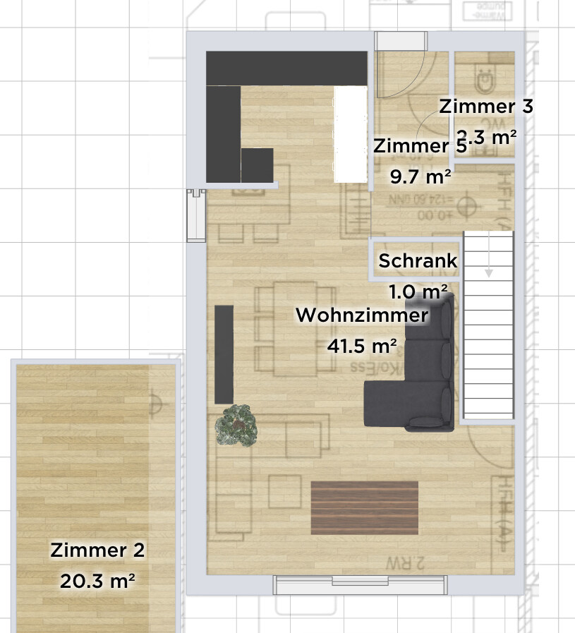

How do we best arrange the ground floor? Should we still make some changes here?
Ideas for potential changes to the ground floor

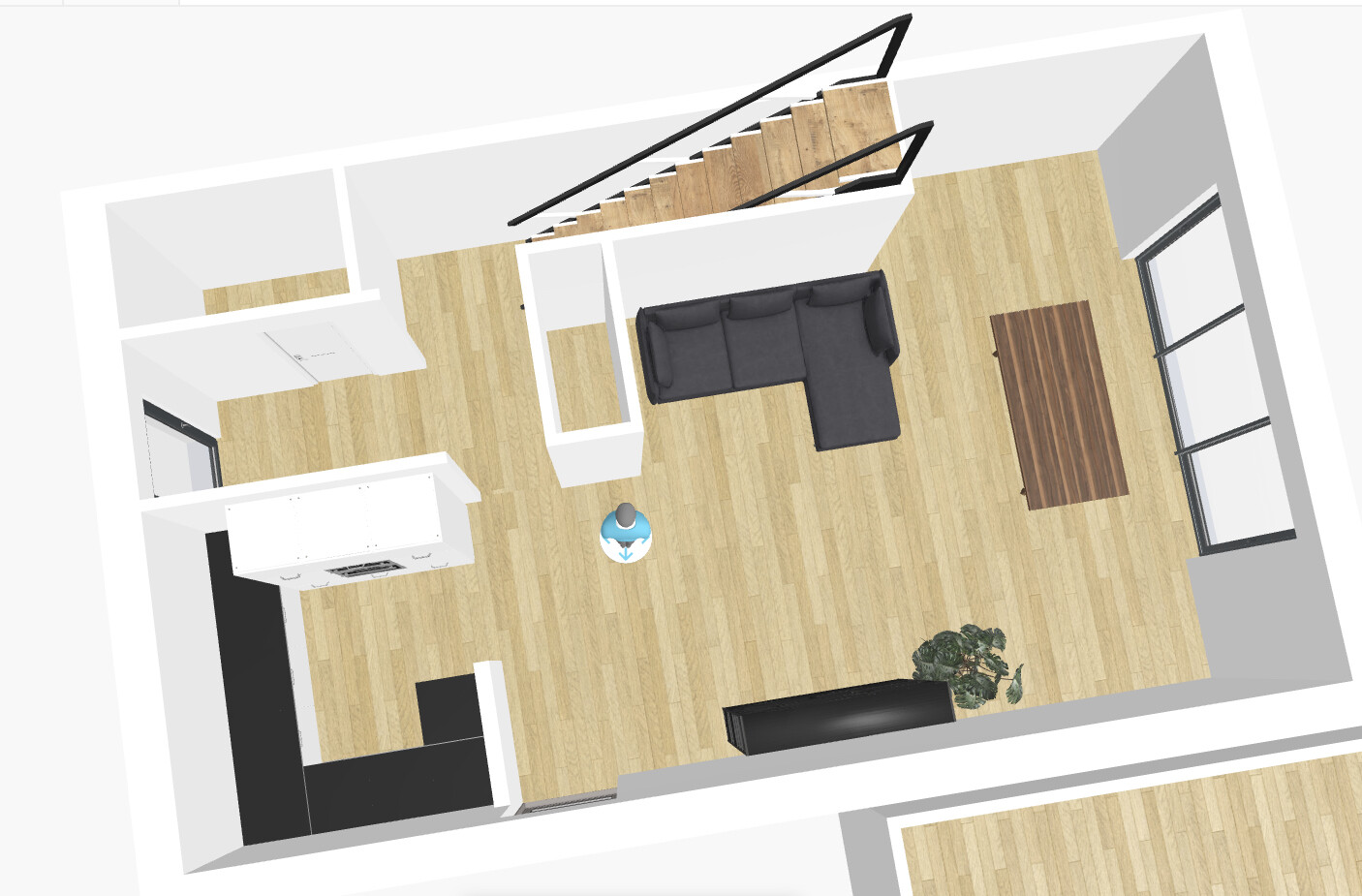

Maybe reduce the kitchen size and straighten the hallway wall? (We’ve discussed this idea in the kitchen forum but haven’t talked to the planner yet.) The scale is off here (I think my cabinets are too large). The rough structural width in the kitchen at the narrowest point is 248 cm (98 inches), so roughly 240 cm (94 inches) minus about 130 cm (51 inches) for both kitchen sides would leave 110 cm (43 inches) aisle width. Also, the window would be moved to the corner. In return, there would be more cloakroom space in the hallway. Bad idea? Opinions?
Another question is a bit… can we reduce the distance between sofa and TV? I’ve just sketched in our current furniture; it would look roughly like this (sofa 275 x 220 cm (108 x 87 inches)).
Ideas so far include putting a shelf behind the sofa (but that blocks the terrace door more). Any other ideas?
Even with the door, the wardrobe already has significantly more space than before (previously 113cm (44 inches) in the niche, now approximately 180cm (71 inches), possibly more depending on the exact layout). So it definitely improves the hallway. My husband says it’s "simply comfortable," and he likes the idea of being able to enter the kitchen directly from the hallway (for groceries, but also just when coming down the stairs). He also feels it makes the kitchen seem less enclosed than a U-shaped layout or less narrow than a galley kitchen.
To be honest, I’m relatively neutral about it. In my opinion, the straight wall in the hallway helps either way, whether there’s a door or not. If there is a door, I would prefer a sliding door, but we’ll see.
mayglow schrieb:
We also had a thread about this in the specialized forum, and the recommendation there was quite unanimous in favor of the proposal:Is this supposed to represent an open passage from the kitchen to the entrance area that would be blocked by the open dishwasher door? mayglow schrieb:
But he definitely has the final say on the kitchen because he is the main user.)If he is also the main cleaner... *duckandrun*https://www.instagram.com/11antgmxde/
What is this supposed to represent: an open passagewayOops, I copied the design without the door shown. But I think you can figure it out with a bit of imagination 😉 It's probably unavoidable that the dishwasher blocks something in such a narrow kitchen, but this way, when it's open, all the other cabinets remain accessible and can be loaded.mayglow schrieb:
(although narrower than the original, as a two-row layout or L-shape with door) Regarding narrow kitchens... We currently live in a very narrow timber-framed house, and my kitchen measures approximately 4.50 x 2.30 meters (15 ft x 7.5 ft). On the west side, we have a kitchen run along the full 4.50 meters (15 ft) with a countertop integrated into the windowsill (approximately 0.65 - 0.85 meters deep / 2 ft 2 in - 2 ft 9 in), then a 1.00-meter (3 ft 3 in) wide walkway — just enough space so that the pull-out drawers from Ikea, including their handles, don’t clash when both are open at the same time, which happens maybe three times a year — and then on nearly 3.00 meters (10 ft) we have tall cabinets and countertop with a depth of 0.65 meters (2 ft 2 in) plus the fridge.
I really enjoy working this way, with short distances. Because of the deep countertop by the window, I don’t feel cramped (well-planned lighting helps too), and I would definitely plan at least a 2.00-meter (6 ft 6 in) section to be this “narrow” again. It might sound tight, but it has worked great in everyday life for three years now. Without an L-shape, you don’t have the dead space in the corner (we have two runs opposite each other, west and east, and on the north side the radiator with a stool in front for when my back needs a break)... I don’t remember your exact room dimensions right now, but a “narrow” kitchen, if well planned, can work very well 🙂
