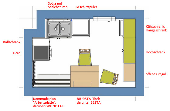

At the moment, we only have mismatched kitchen furniture from my old apartment, arranged like this from above:
We want to get rid of most of the open shelves simply because everything gets dusty and greasy, and they are already mounted too high. Pots and similar items should go into the corner cabinet instead.
There is already a shelf under the table because we really have nowhere else to store things properly. Currently, some food is stored in the hallway, which we want to avoid — hence the idea of having larger cabinets under the table. I would prefer less deep cabinets, but they should also support the countertop, which would otherwise be free-spanning at 1.20 meters (4 feet) and might sag over time. The chairs would be hung on the wall when not in use (instead of constantly being in the way as at present). Although we can also eat in the living room, that is always a bit inconvenient. Still, we are considering it as an alternative because placing the table in the kitchen would only be possible by the window.
Elsewhere, I don’t see any additional storage options where we (about 160cm (5 ft 3 in) tall) wouldn’t have to climb, like with the planned wall cabinets at the top for rarely used items. No cabinets can be hung above the sink because the wall is thin and full of cables, and there would be steaming appliances like a kettle and coffee machine on the dishwasher. The chairs would hang on the wall where the stove currently is. Below that would be the cat food corner.
But we’re happy to receive any tips!
PS: This is a rental apartment, and we are not allowed to change (or have changed) any plumbing or electrical connections. We have only three regular power outlets in the kitchen, all located between the radiator and the window.
