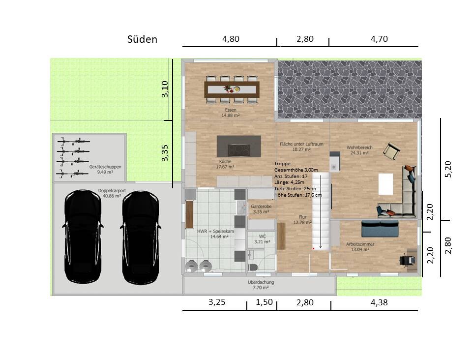

Floor plan of a house with kitchen, dining area, living room, office, entrance hall, and carport.

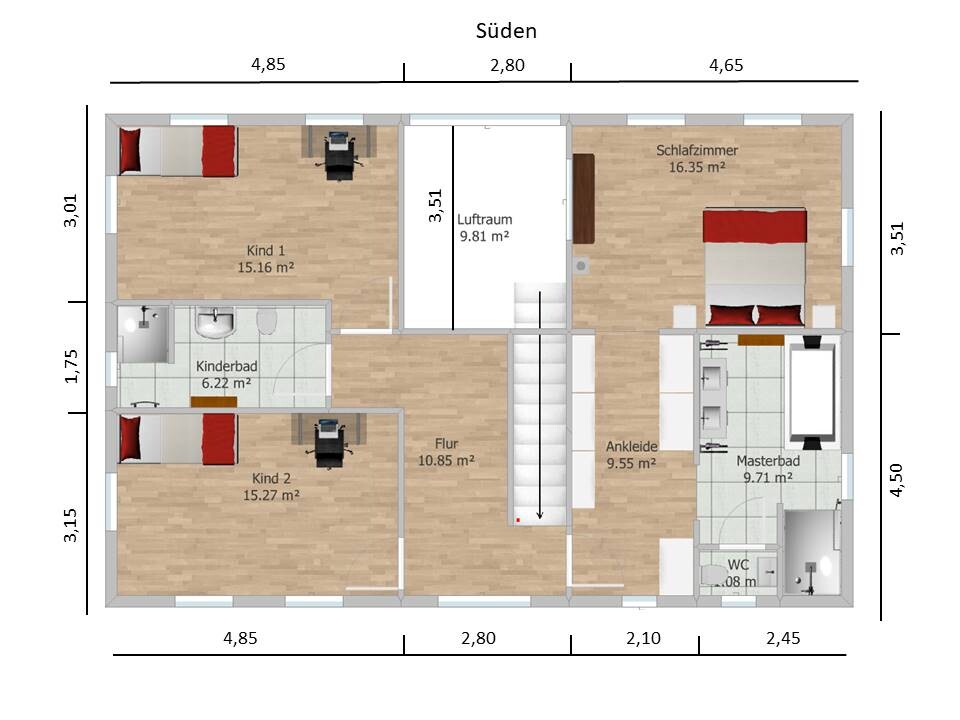

Upper floor plan: master bedroom, two children's rooms, bathrooms, corridor, and storage room

- The 3.10 m (10 ft) space for the dining table from the island might feel a bit tight. We have 3.40 m (11 ft) and wouldn’t want any less to allow easy passage when someone is sitting at the chair.
- The kitchen will be very large but somehow impractical. Where will the sink be placed?
The decision whether to put the cooktop or the sink on the island is a much-discussed topic. From my own experience, I can only say that you spend much more time at the sink and doing prep work than at the cooktop. We are incredibly happy to have the sink on the island and the cooktop on the countertop and would set it up the same way even after 3 years.
Why not simply have a large island with both? You have the space for that... I’m not a big fan of the bar stool and counter setup, but that’s a matter of taste...
- @ypg already pointed out the issue with the stairs: You mentioned a higher ceiling height on the ground floor. Your stair design won’t work like that; it would be extremely steep. If I take the 5.20 m (17 ft) measurement as a reference, your stairs shouldn’t be longer than 3.5 m (max 4 m).
- I would probably extend the wall with the fireplace; the stairwell connects with the gallery. This would require mirroring the upper floor: parents’ wing on the right, children’s wing on the left.
- The bump-out in the hallway caused by the kids’ bathroom doesn’t really appeal to me either...
My suggestion could certainly be improved, but it should be enough to illustrate what I mean. If the stairs are moved a bit to the left on the plan, there would be enough space to solve the issue with the dressing area and bathroom in the parents’ section. There is space for this since the ground floor hallway is already quite generous at 3 m (10 ft) wide.
If the sofa is rotated, it won’t awkwardly block the window and will create a nice corner for relaxation. Also, the stove would then be visible from the dining area and not only from the couch.

I’m also concerned that although 8 chairs plus table can be nicely arranged in 15sqm (160 sq ft), it will likely feel very cramped in everyday use.

We like the suggestions regarding the kitchen and dining area. Despite having a larger kitchen island overall, the space for the dining table increases from 3.10m to approximately 3.80m (around 10.2 ft to 12.5 ft) by rotating it 90°.

Good idea! Besides better orienting the sofa towards the windows, the fireplace can also be used again as an additional room divider that is visible from everywhere. And for example, we could add an extra armchair to the living room.
matte1987 schrieb:
- @ypg already mentioned the stairs: You referred to a higher ceiling height on the ground floor. Your staircase won’t work like that or it will become extremely steep. If I consider the dimension of 5.20, your staircase shouldn’t be longer than 3.5m (max 4m).
The staircase is currently 3.90m long with a ground floor ceiling height of 2.70m (8.9 ft). That should fit, right?!

We initially had the layout mirrored as well but decided on the current arrangement for the following reasons:
  • All bedrooms have a view of the garden (in the mirrored version, one room would face the neighbors and the street)
  • All wet rooms are stacked directly above each other
  • The required space of 32 sqm on the right side is not sufficient for the parents’ area
  • Only on the left side is there the possibility for a free-standing wall for the bed
  • The walk-in closet has natural daylight in the morning
However, if it’s possible to move the staircase further left to enlarge the right area, mirroring the layout is definitely worth considering.
Floor plan of a house: kitchen, dining area, living room, study, WC, utility room, cloakroom, carport

The space is too short. In addition to your finished ceiling height, you need to account for at least 30 cm (12 inches) of ceiling thickness that you also have to clear. I think the staircase should have 17 steps and will therefore be between approximately 4.25 and 4.60 meters (14 and 15 feet) long. (17 steps, rise about 17.5 cm (7 inches) each, tread between 25 and 27 cm (10 and 11 inches))

We’ve mirrored the layout of the upper floor, so the parents’ and children’s areas are now completely separated. We plan to discuss this with the builder next week. Do you see any major issues that would be difficult to fix?

Floor plan of a house: Bedroom, two kids’ rooms, walk-in closet, hallway, bathroom, WC, open space.
