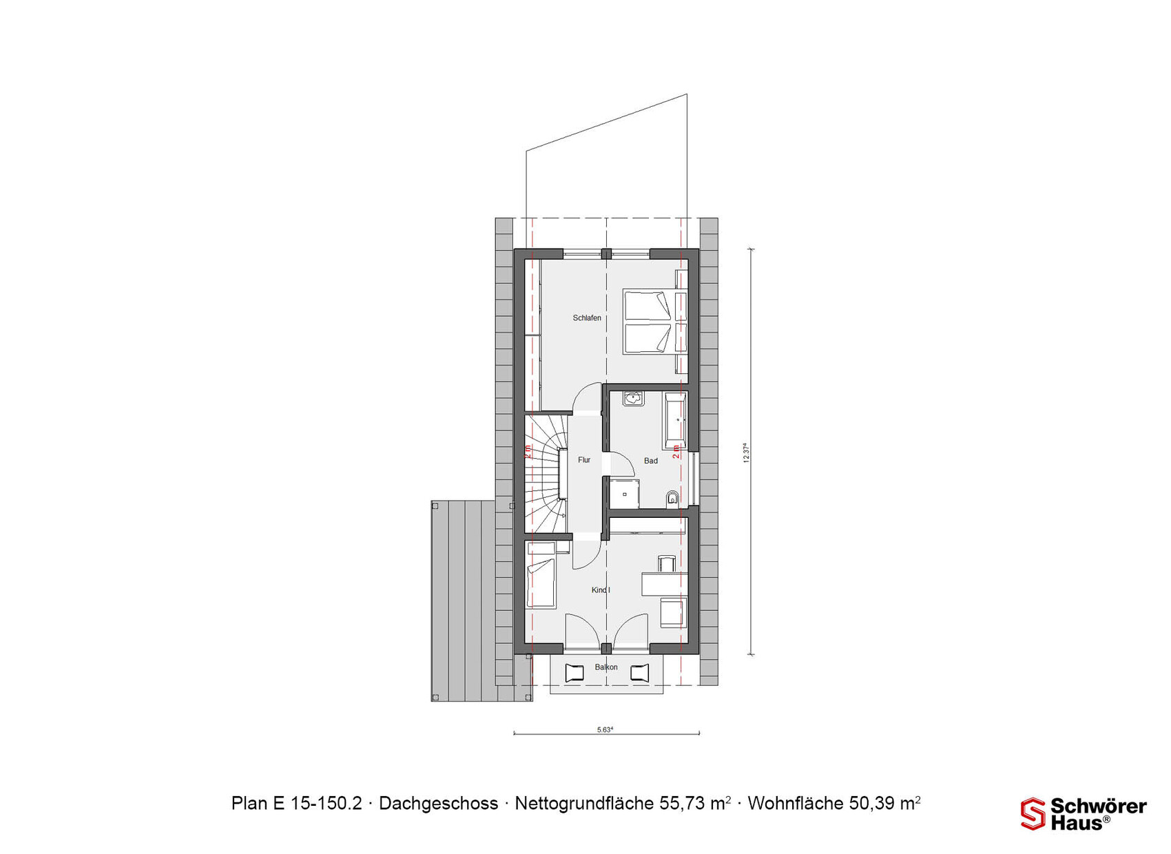

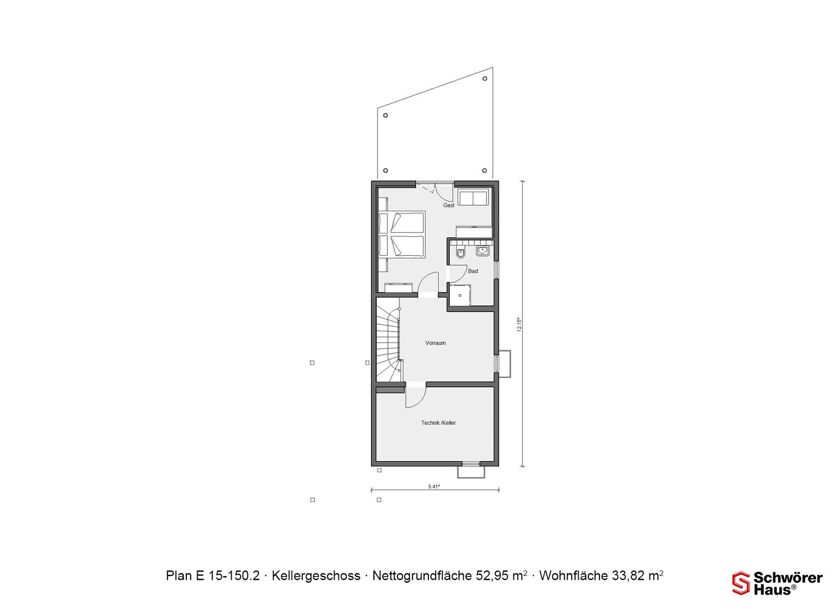

Of course, one could try talking to the neighbor to see if they would waive their setback area and allow edge construction. Maybe ask Escroda if that’s possible. Then it would be possible to build a very narrow house. Something like this from Schwörerhaus (disregarding the terrace and the fact that this is not a hillside):
Basement floor plan with entrance area, staircase, utility/cellar, bathroom, guest room and terrace.
Attic plan: bedroom, child’s room 1, bathroom, hallway, balcony, staircase.
Ground floor plan with living, dining, kitchen, hallway, balcony and carport.
5.60 m wide (18 feet 5 inches).
