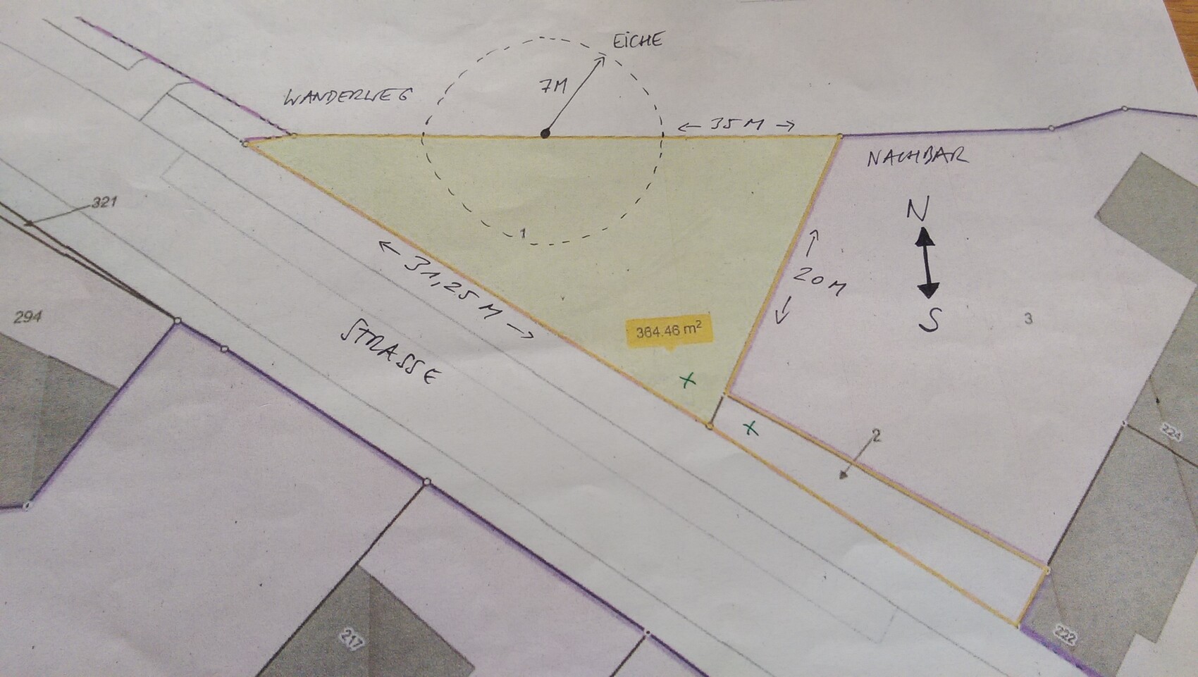

Sorry for the delay. Unfortunately, I was in the hospital.
Attached is a first sketch. Unfortunately, it’s not to scale, but it should give a rough idea. At least I hope so.
kbt09 schrieb:
Is there a building envelope? If there is a zoning plan, please quote it.
What house size do you need? How many floors? Garage? Carport? Parking spaces?
Is the neighboring plot still available for development? Do you know how construction is planned there?There is no zoning plan.
Two floors and a basement. We are planning a granny flat in the basement. Living area about 200 m² (2,150 sq ft), slightly more.
Garage in the basement on the right side next to the neighbor. The neighboring plot is already developed.
