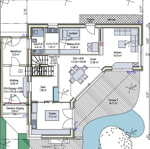

WilderSueden22 Jan 2021 20:12I can't help you with the ceiling issue, but the design of the granny flat seems inconvenient to me. Basically, it only has one bed for sleeping. If a person in need of care can still get out of bed, they always have to walk around the house to reach the connection point. And if they can no longer get out of bed, they wouldn't want to be so isolated.
Schwabe2322 Jan 2021 20:20You are probably right. Since this will be a KfW 40 Plus house, the second dwelling unit must meet certain minimum requirements to qualify for the subsidy. Maybe one day a door will be installed to the main apartment if the "tenant" agrees to it...
WilderSueden22 Jan 2021 20:59Adding another door will further disrupt the floor plan of the secondary apartment. Whether you want to create a pseudo-living unit to qualify for higher subsidies is your decision—I don’t want to judge that. But consider that for a one-time cost of 30,000€ you will have this awkward section in the house that no one will find comfortable to live in and will likely be used only rarely. At the same time, for example, it forces you to take a staircase every time you want to go from the living room to the bathroom. If you install the door, you will have access to a bathroom on the ground floor, but it won’t even have a window, except one looking into the storage room. It’s really not very pleasant.
