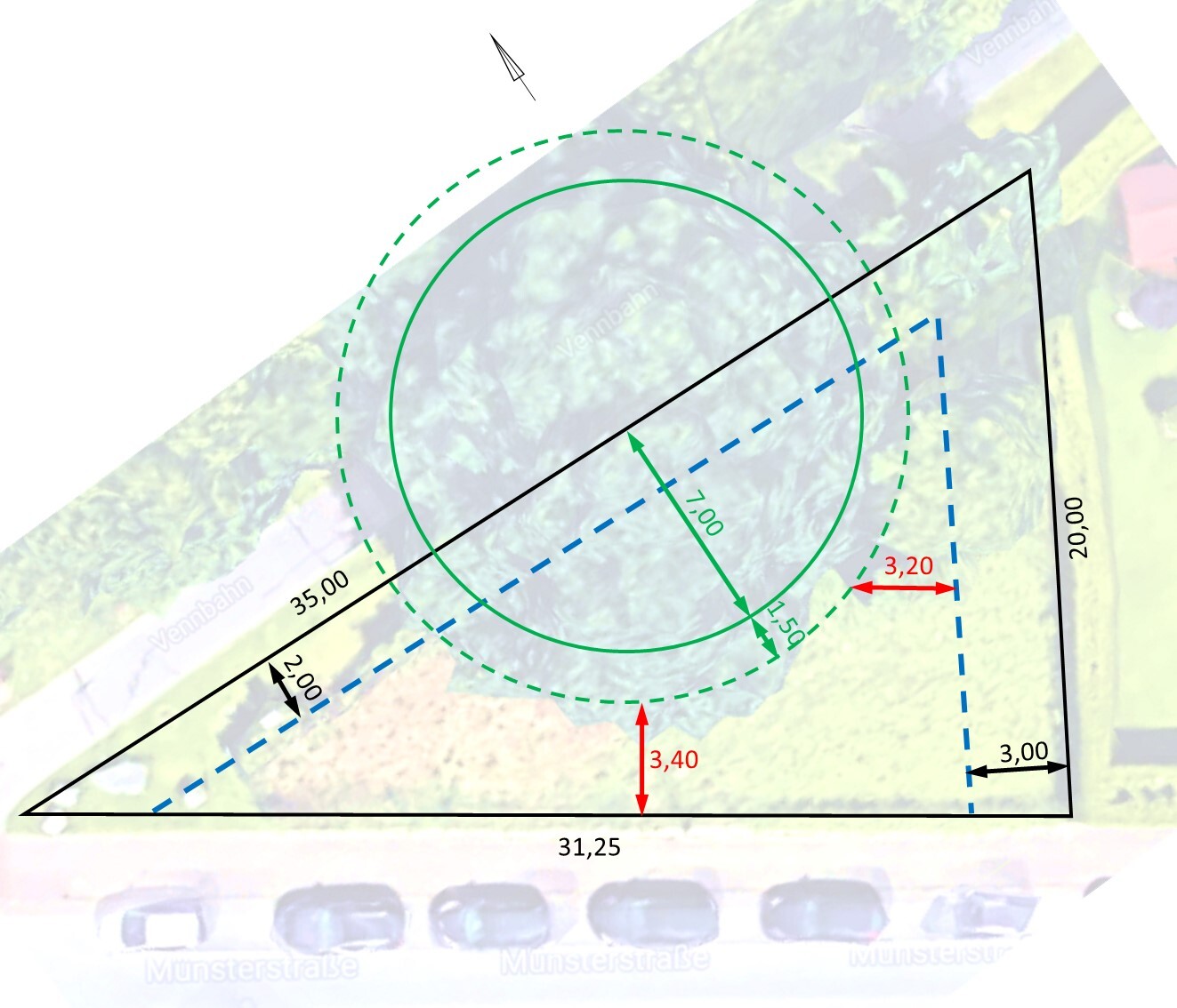

Mottenhausen12 Nov 2018 11:43This is now to scale, based on your hand sketch and Google Maps.
Honestly, why would someone buy something like this? I’m writing this for the third time: given the conditions, the plot is not buildable, not even with boundary construction along the street. I added two red arrows to show how serious the situation really is. I thought it was bad, but the reality is even worse.
Or is it a misunderstanding, and the 1.5 m (5 feet) distance only needs to be maintained from the trunk?
