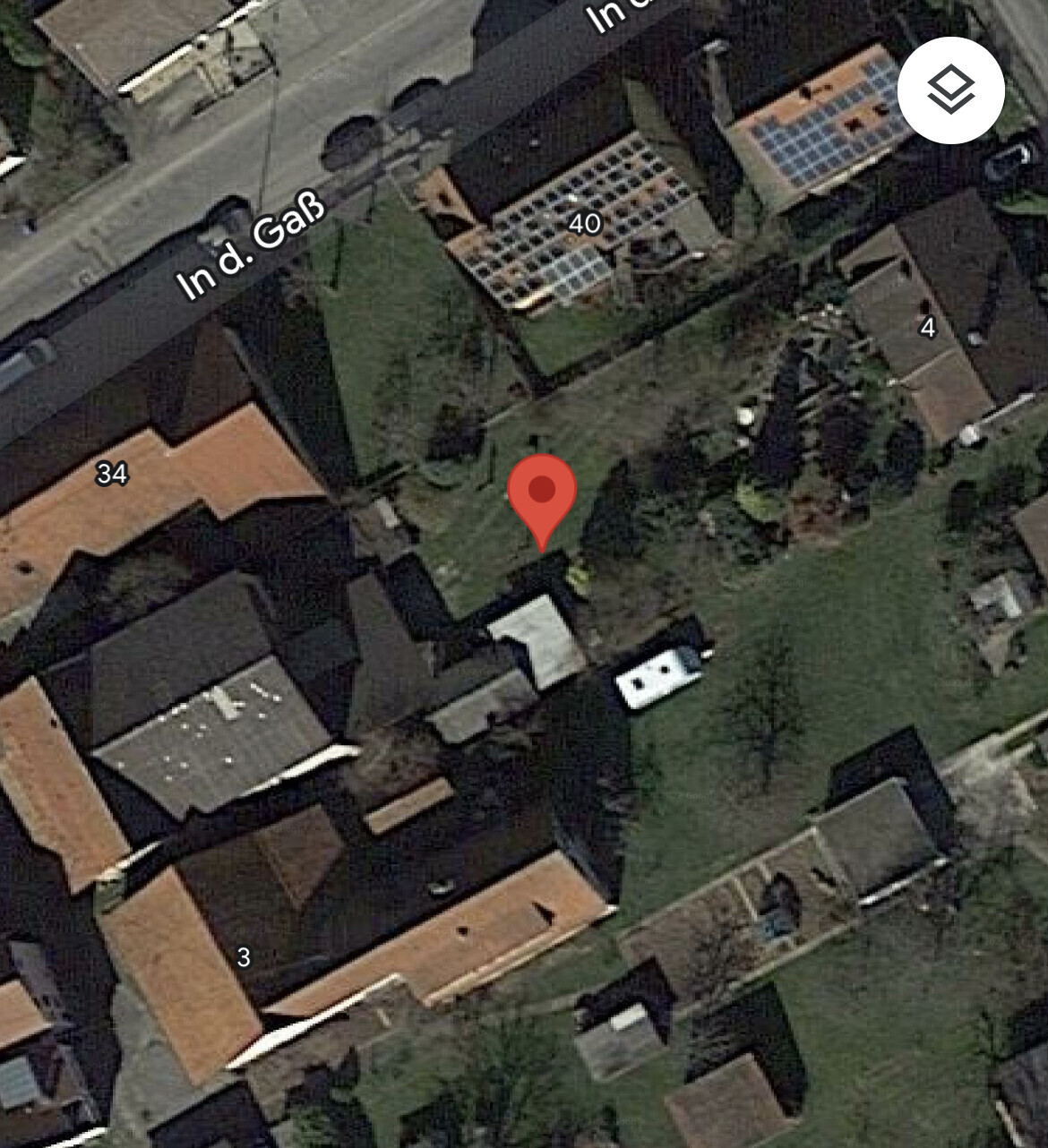

In the attached image (Grundstück.jpg), you can see the plot cleaned up with Photoshop from above. Access is only from the west side and is currently planned to be 3 meters (10 feet) wide.
It is the plot marked in red.

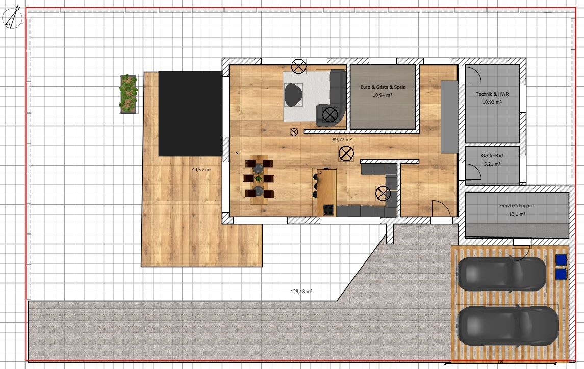

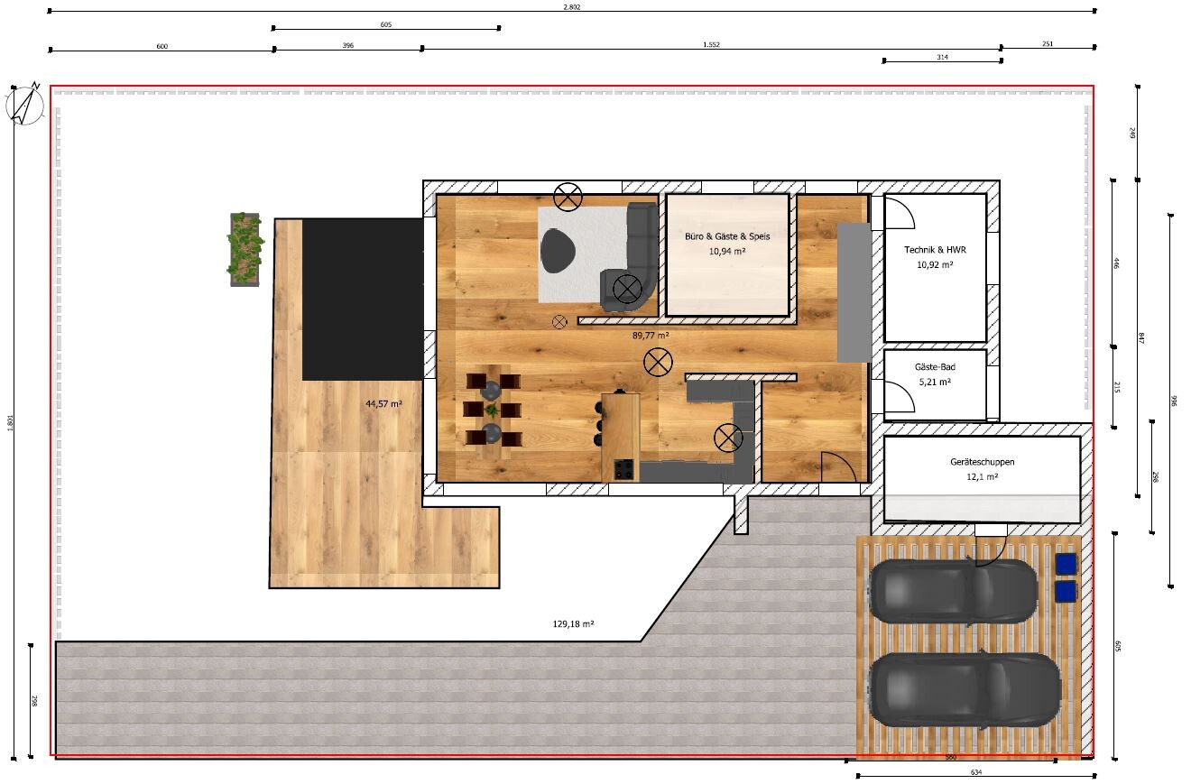

I have already developed about 10 variants on how to arrange the buildings.
I have also attached my 4 favorites.

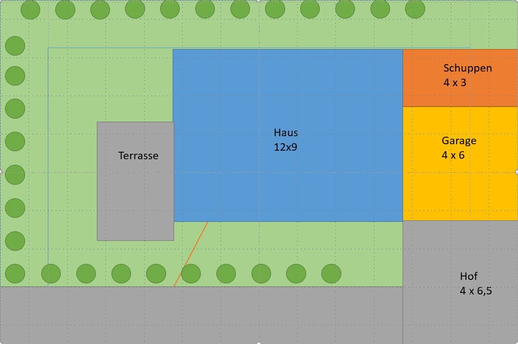

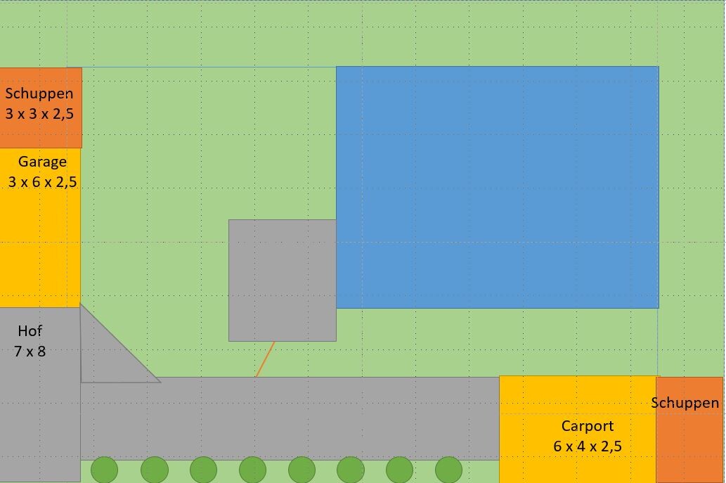

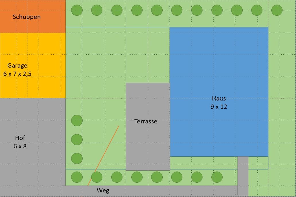

V1:
House 12 x 9 m (39 x 30 ft)
Garage 6 x 6 m (20 x 20 ft)
Shed 6 x 3 m (20 x 10 ft)
Positives:
- Garage and shed are neatly arranged.
Negatives:
- House is not square and might be difficult to design with a gable roof.
V2:
Positives:
- Large courtyard for the children.
Negatives:
- Garage is far from the house.

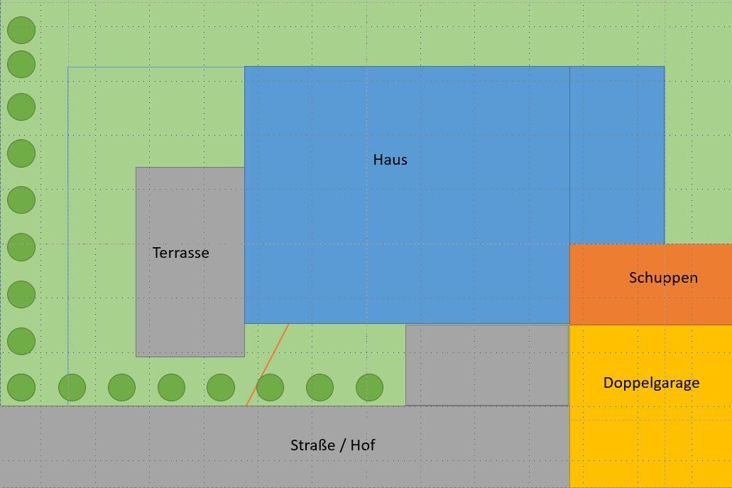

V3:
Positives:
- Garage and shed are on the northeast side, so they avoid midday sun. However, the office and guest toilet would have no windows or only face the garage (according to the current planned layout).
Negatives:
- Feels like almost the entire plot is paved, which would also increase costs.
V4:
Positives:
- You could use either the carport or the garage for something else as long as you only have one car.
Negatives:
- Takes up a lot of space.
I am really getting frustrated because I would like to decide this myself and not wait for what the architect proposes.
I would like to have the layout finalized already.
Can you help me here? What would you do? Or do you have other ideas?
V1:
Positives:
Negatives:

Samsonite4 Jun 2022 14:03This concerns the plot outlined in red.
