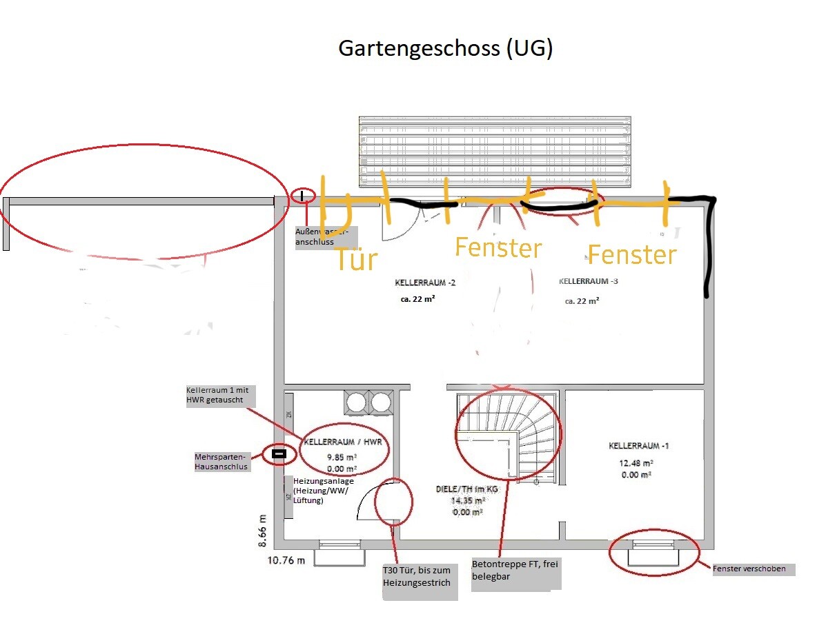

Unfortunately, I’m not home this week and don’t have access to the latest floor plans, but I will attach some that are not fully up to date. I tried to sketch the changes in the basement with my smartphone, but it’s not great. There is a large room downstairs with three openings to the garden, which will basically become three separate rooms later. Access to the garden should be possible for the homeowner on the right side. So, from the living room, you can reach the garden via a door on the north wall, going down a ramp or sloping terrain into the garden. Alternatively, you can go through the kitchen, then the pantry to the carport, and from there into the garden (depending on how the masonry or slope is done there, a stone staircase will be installed or just a simple slope). That’s the general idea.
hanghaus2000 schrieb:
The zoning/planning permission plan with building boundaries should also be helpful.
There is already an excerpt from the zoning plan in the first post (showing the position of the house on the lot).
Lower ground floor plan (basement) with cellar rooms, doors, windows, and staircase.

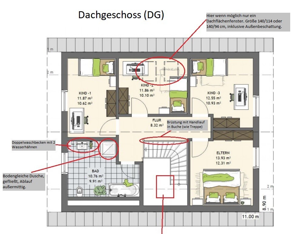

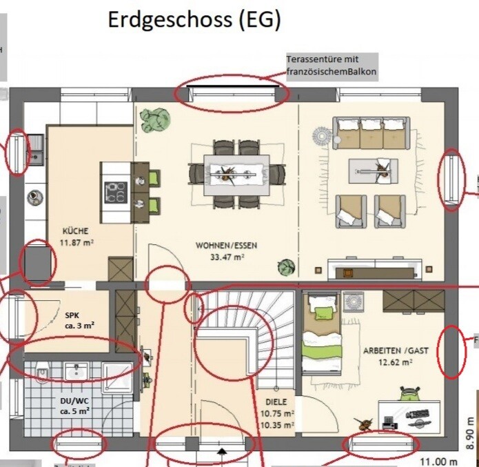

Ground floor plan with kitchen, living/dining area, hallway, bathroom, and study/guest room.
Upper floor plan with three children's bedrooms, master bedroom, bathroom, hallway, and staircase.

You don’t seriously mean the French balcony in the living room, do you?
Si0n198912 Jul 2021 21:00
You don’t seriously mean the French balcony in the living room?
Yes, we plan to add either stairs or a balcony there later. We actually want a balcony, but our budget makes that difficult. That’s why it’s designed so that a cantilever balcony can easily be added afterwards. Don’t you think that’s a good idea? As I said, it’s not completely finished yet, and we want to keep our options open.
