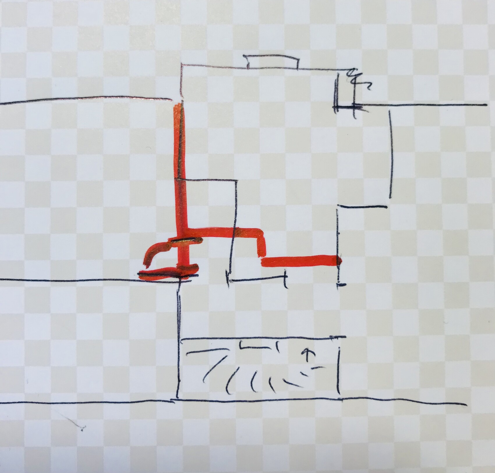

To avoid seeing yourself in the mirror while sitting on the toilet, we could swap the toilet and bidet.
27 Oct 2021 12:22
I would make complete changes to the upper floor.
The hallway is very small and therefore feels quite oppressive.
The "gained" 1.5 m² (16 sq ft) in the children's room doesn’t improve the space at all and is therefore wasted.
So: widen the hallway to about 130 cm (51 inches) and eliminate the entrance recess in the children’s room. Then rearrange the bathroom again.

I measured again, and between the door and the left sink there would be only 30 cm (12 inches) with Myrna_Loy’s suggestion. The door would inevitably hit a person standing there. Don’t you also think it makes more sense to keep the bathtub at the front? And to avoid seeing yourself so much in the mirror, just swap the toilet and bidet.
