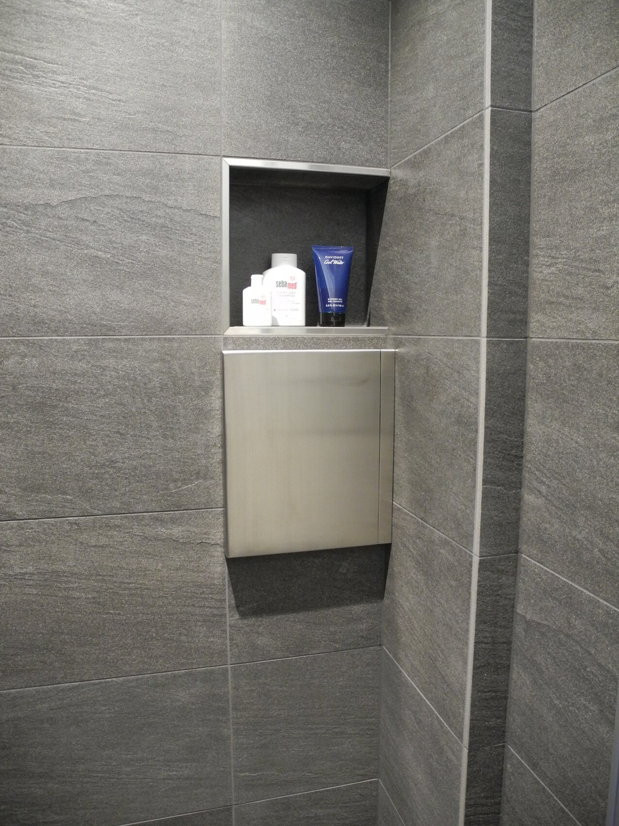

we are about to complete the bathroom on the top floor of our new build. The pipes have already been installed going upwards. We have a laundry chute in that room. We would also like to install a shower, which would need to be positioned in a way that the laundry chute is integrated into it. Do you have any ideas on how to make the chute waterproof? Is this even possible?

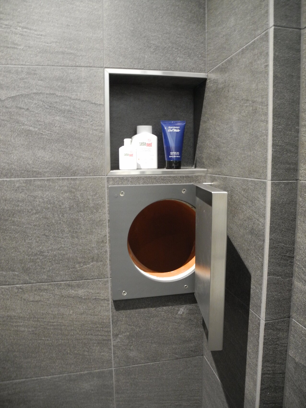

MM1506zzzz23 May 2021 23:43I have a laundry chute opening in the shower on the top floor, and there is absolutely no problem with moisture. You should use a well-designed hatch that does not have any gaps.
Before I put space-consuming and visually unappealing laundry baskets, washing machines, and dryers into the living area, I prefer to undress in the shower and let the laundry fall directly into the basement next to the washing machine.
