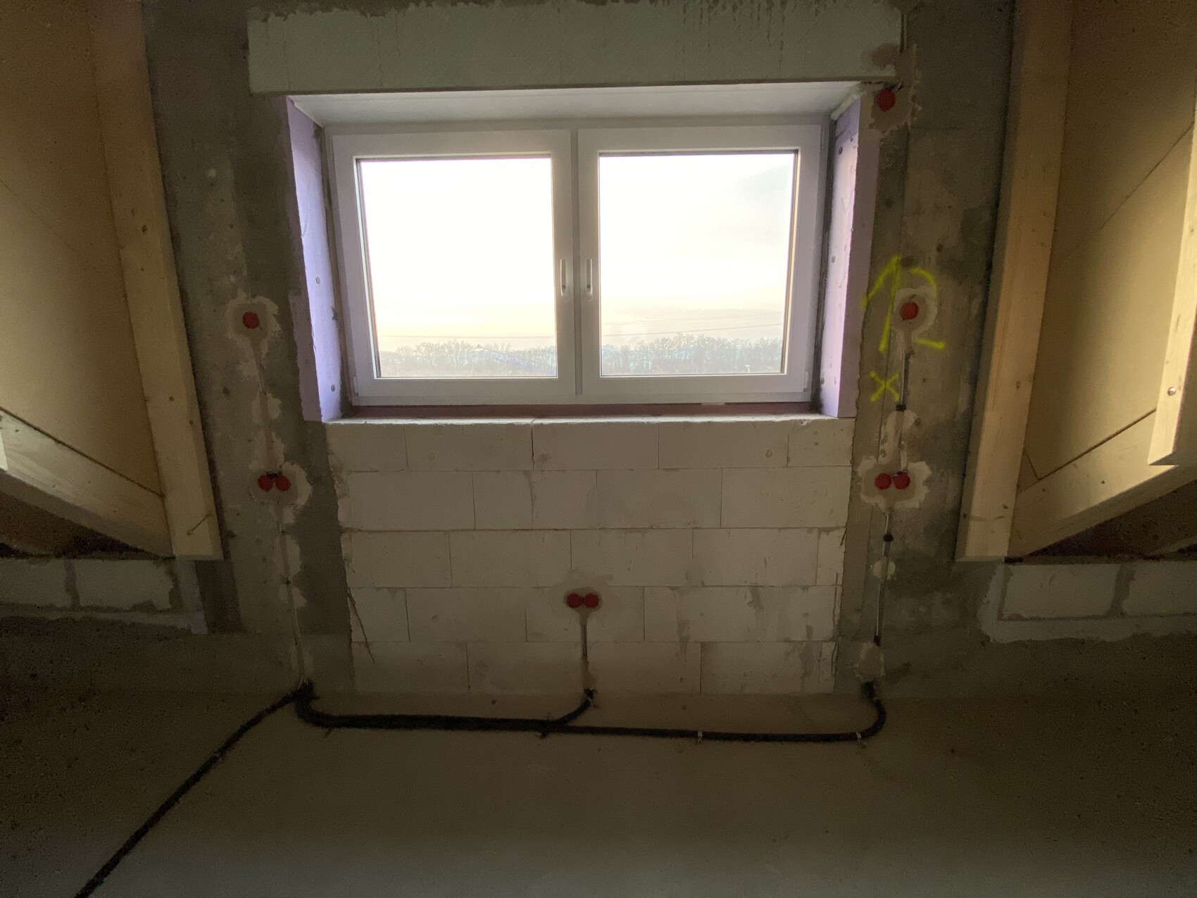

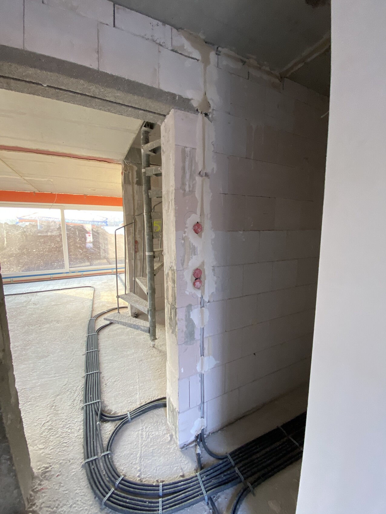

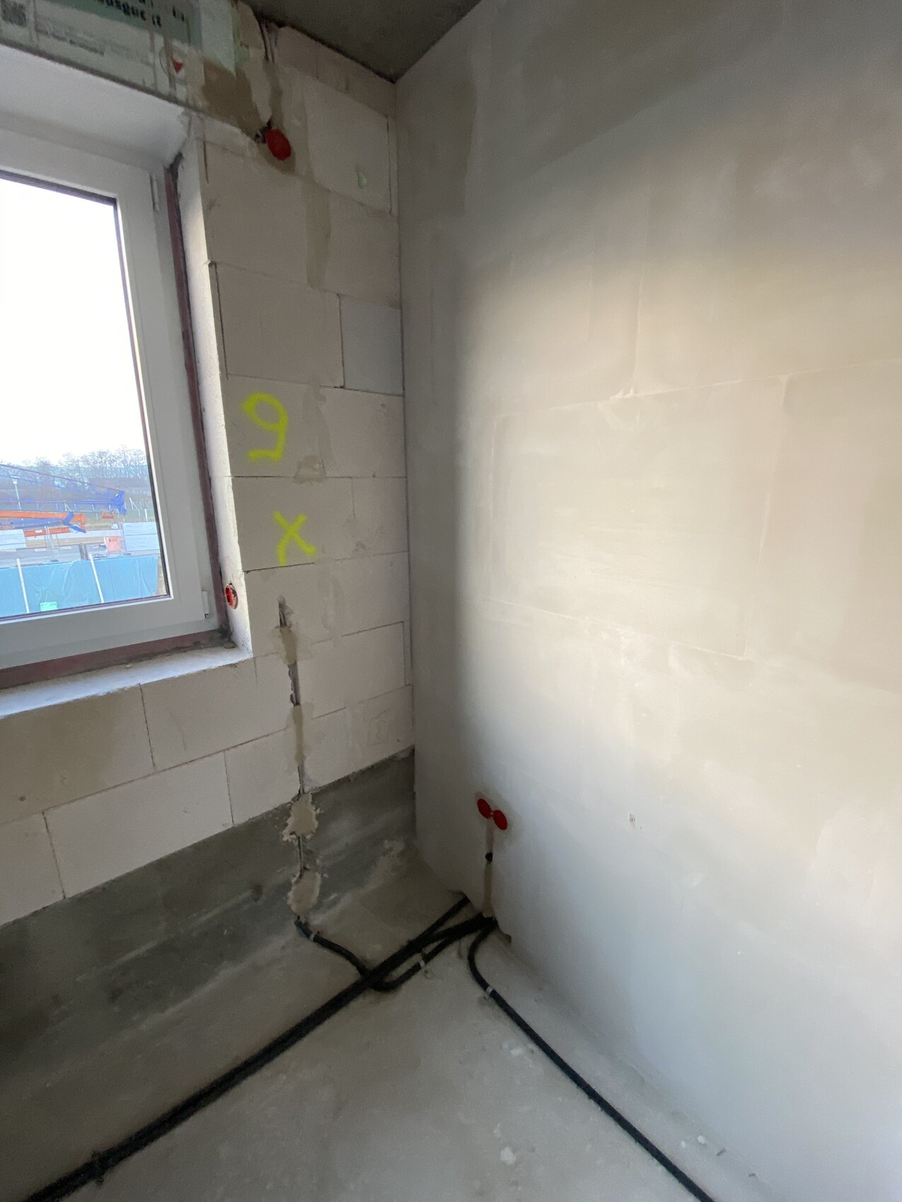

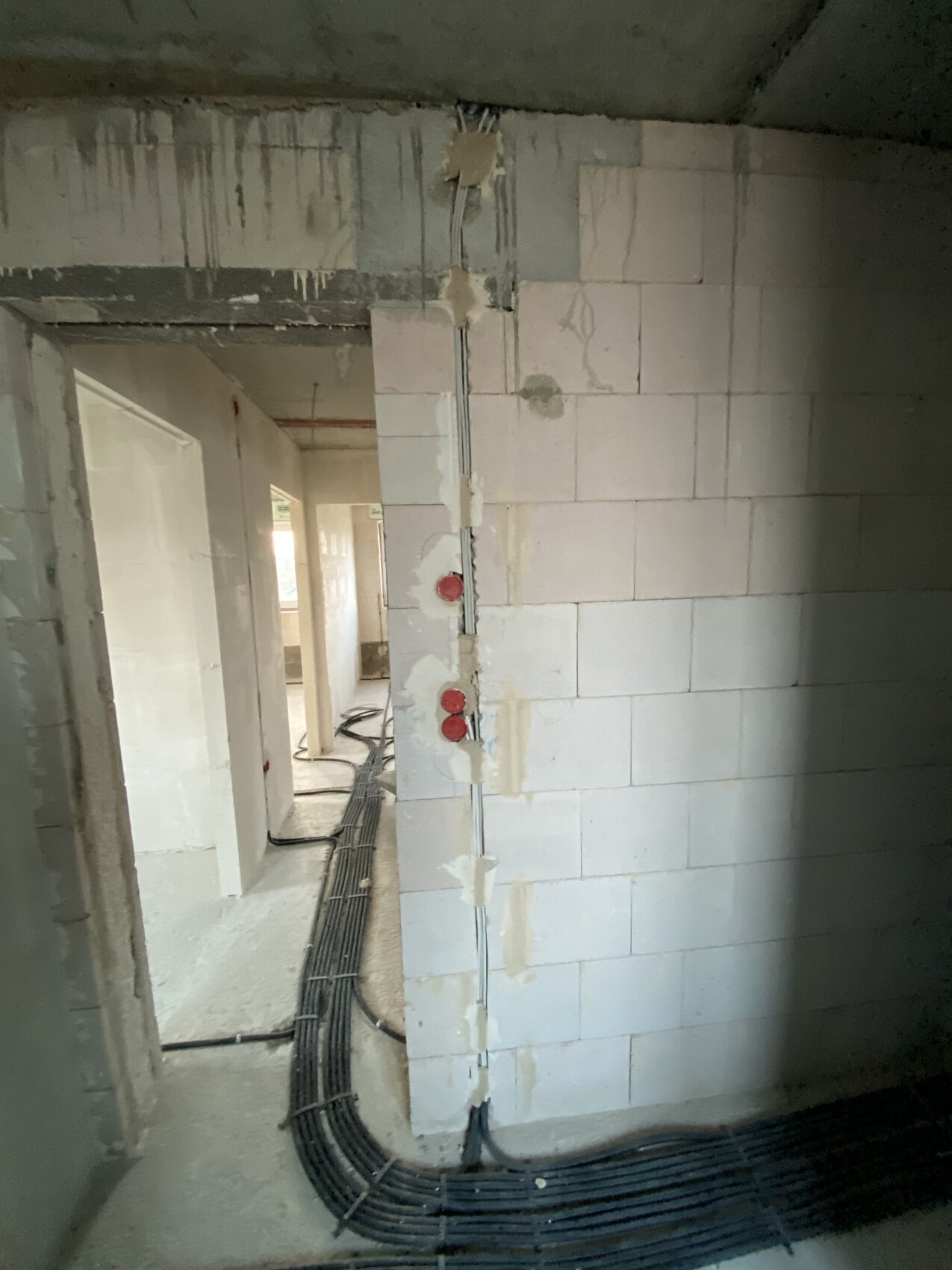

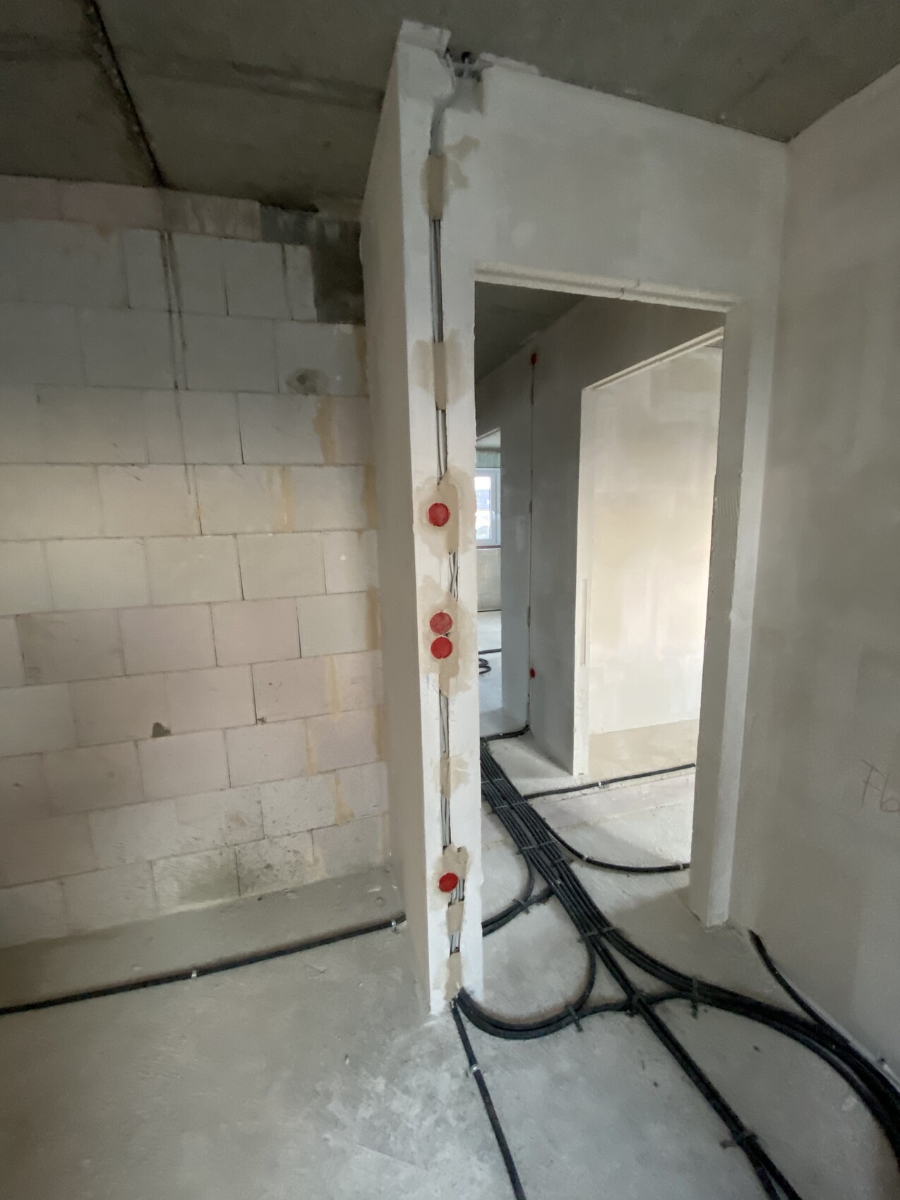

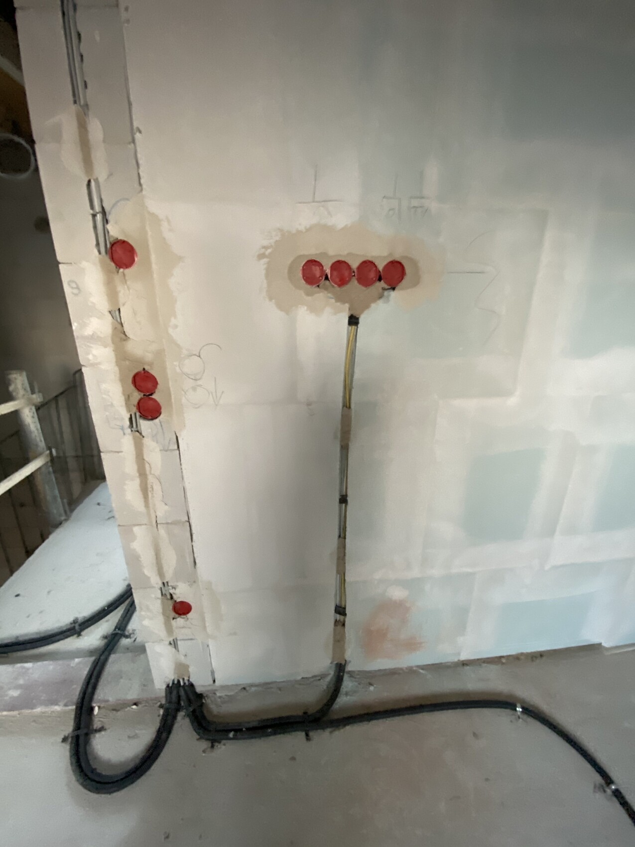

goalkeeper27 Jan 2020 09:50Looks pretty good. But why can’t the conduits be left 10-20cm (4-8 inches) longer to avoid problems when replacing the cable in case of a malfunction? Now the entire floor buildup comes on top, and then the conduits basically only provide mechanical protection. Even though in 99.9% of cases nothing happens, it could have been done with just a bit more material.
What I find unacceptable here is that the LAN cable / satellite cable?! also doesn’t have any conduit all the way to the outlet. Who knows what the future holds for internet connections. Quick replacement is definitely not possible this way.
I’m also a bit confused about the cable routing? There’s only one conduit coming up? Where exactly does the network cable end?
danixf schrieb:
What, in my opinion, is completely unacceptable here is that the LAN cable / satellite cable?! also doesn’t have conduit up to the outlet. Who knows how internet needs will develop. A quick replacement is definitely not possible this way.Many electricians just see the DIN 18015-1 as a rough guideline. Considering the price of a network outlet here, I would never accept anything less than having all cables fully installed in conduit. The typical electrician response will probably be: "Even if we put the cables in conduit, you can’t replace them anyway."
goalkeeper27 Jan 2020 11:31hanse987 schrieb:
"Even if we put the cables in a conduit, you can’t replace them afterward anyway."That’s what my electrician friend also said yesterday during the walkthrough.
Otherwise, I already reported the data lines without conduits to the general contractor this morning – also four incorrectly positioned ceiling outlets.

hanse987 schrieb:
The typical electrician’s response will probably be: "Even if we put the cables inside a conduit, you can’t really replace them anymore." goalkeeper schrieb:
My electrician friend said the same thing while inspecting yesterday. You can always replace an electrician, even with conduit.
Did the smart guy ever explain why conduit is used in the first place, or why he thinks it’s called that?
