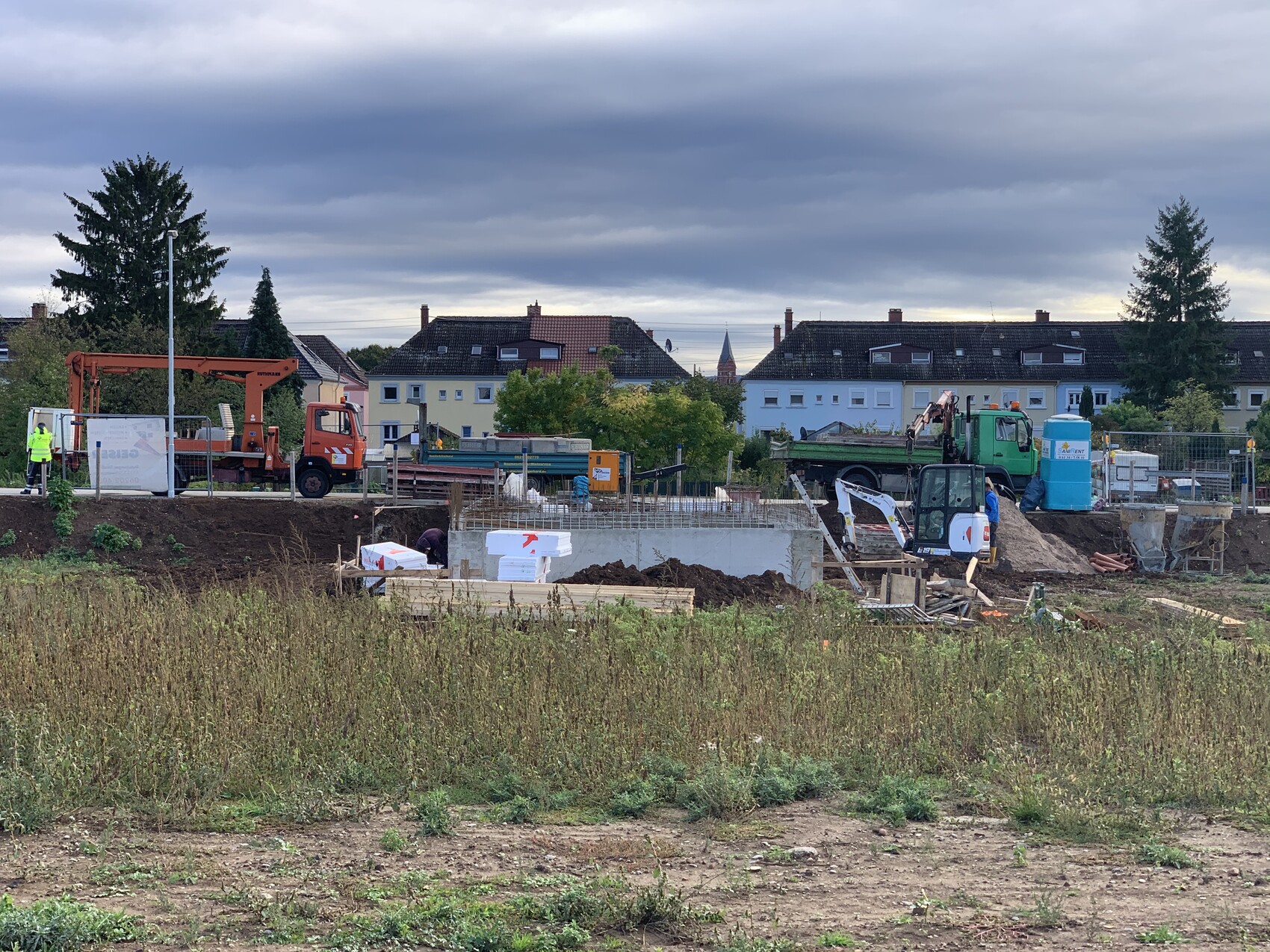

The crane has been gone since early this morning. Fortunately, the team worked quickly, allowing the foundations to be poured beforehand. This was very important, as otherwise the heavy formwork panels would have had to be installed and removed using the excavator. Now, only the slab remains before masonry work begins.
The photo clearly shows the difference in elevation.

17 Oct 2019 10:01
goalkeeper schrieb:
The picture clearly shows the difference in height.
Oh man, it really wouldn't have taken much more to end up with just a simple basement...
kaho67417 Oct 2019 10:12
Scout schrieb:
Oh man, that really was just a step away from a simple basement...
Yes, looking at that picture, I also found myself missing the basement...
goalkeeper
17 Oct 2019 10:46
Scout schrieb:
Oh man, there really wasn’t much left to make it a simple basement...
kaho674 schrieb:
Yes, looking at that picture made me miss the basement too...
However, this is just an optical illusion, and I hope this helps ease some of your disappointment.
The foundation has nothing to do with a basement. For example, the foundation area that was excavated and lies underground consists only of unreinforced lean concrete (economical). Additionally, the excavated soil (clay) can be placed between the foundations. With a basement, it would have needed to be removed.
We are glad about this: a 35,000 saving, and I won’t have to keep going down to the basement to fetch water later on.
