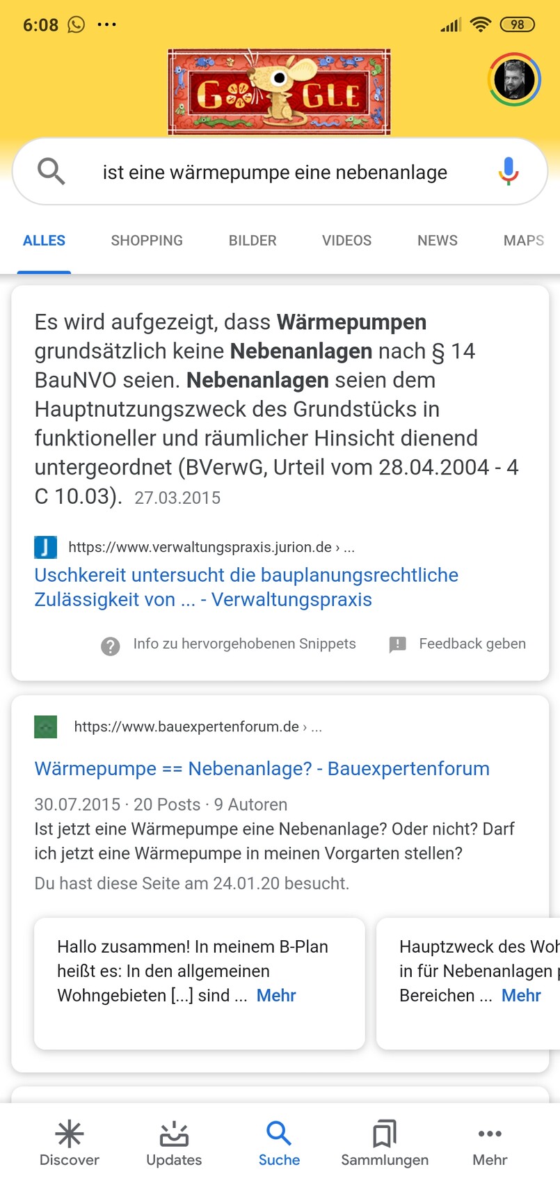

goalkeeper24 Jan 2020 21:43tomtom79 schrieb:
A heat pump is not an auxiliary system. Therefore, it does not need to be included in the building envelope; there are plenty of posts about this. Really? I can’t find any information on that...
Scout schrieb:
They apparently seem to be so quiet that even growing grass would comparably make more noise.Did you misunderstand my words and forget that I cannot tolerate these cat repellent boxes? I only pointed out that a 3-meter (10-foot) setback from the property boundary can be an objective impossibility, as in the case of a 7-meter (23-foot) wide plot, it would practically only allow a central placement.https://www.instagram.com/11antgmxde/
The internet is full of dozens of opinions, etc. Most of the time it’s only about the noise level. The neighbor has to prove first that it is too loud.
