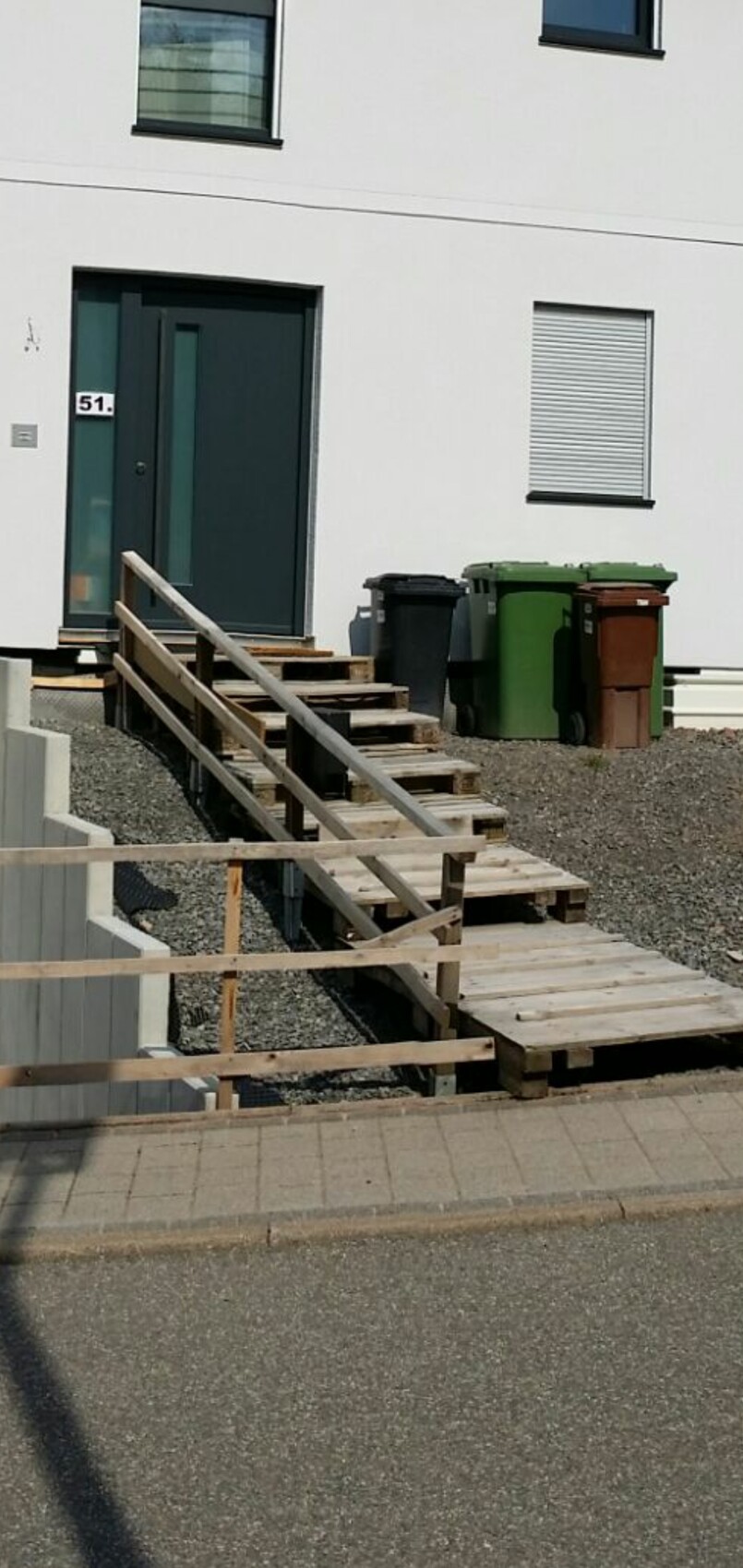

Our temporary solution for one year. Of course, it’s ideal to have everything finished before moving in, but that’s not always possible, whether due to budget or doing it yourself.
Our parking area was just gravel for two years. It improves gradually, and we have neighbors who started building before us and still aren’t finished.
