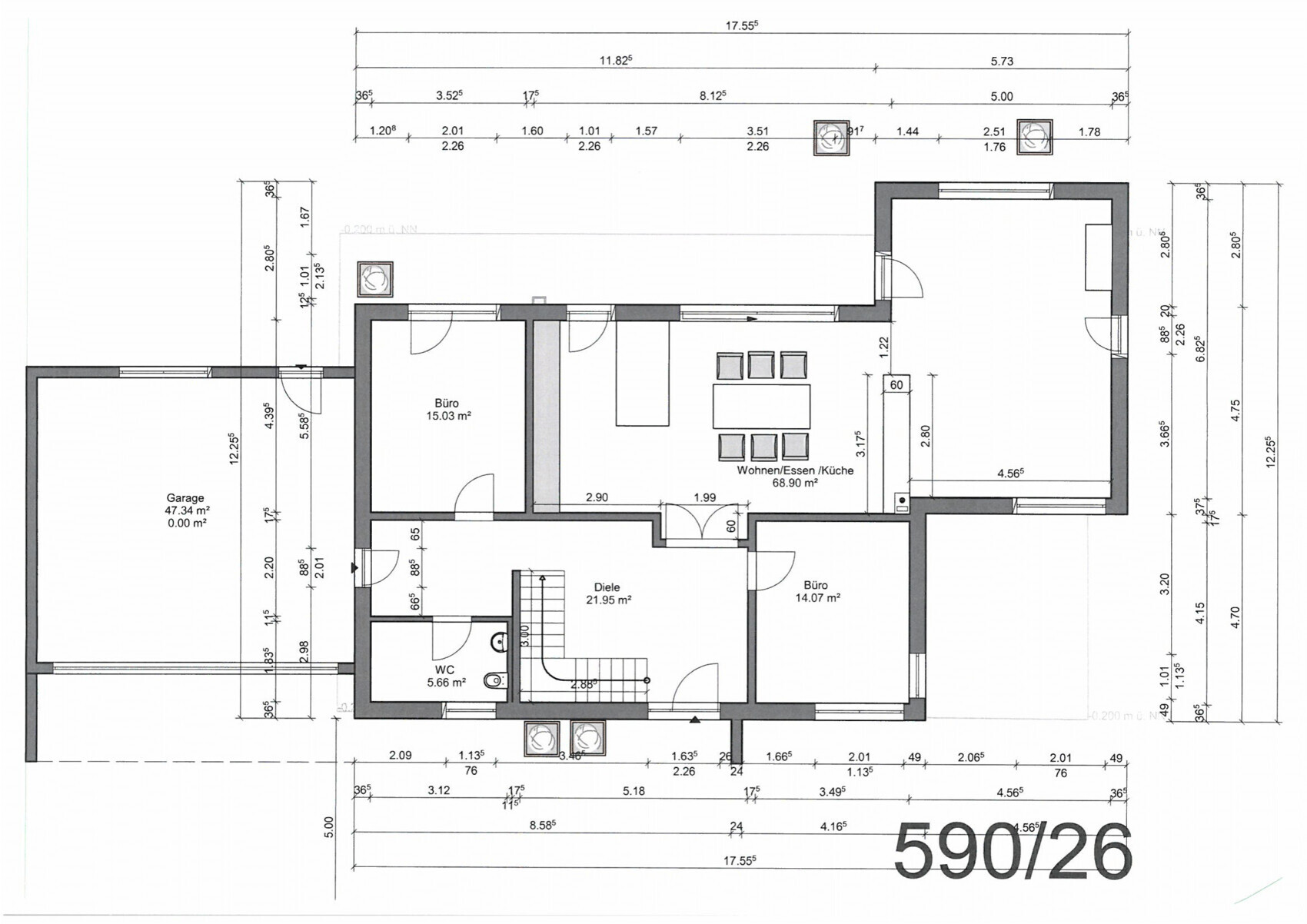

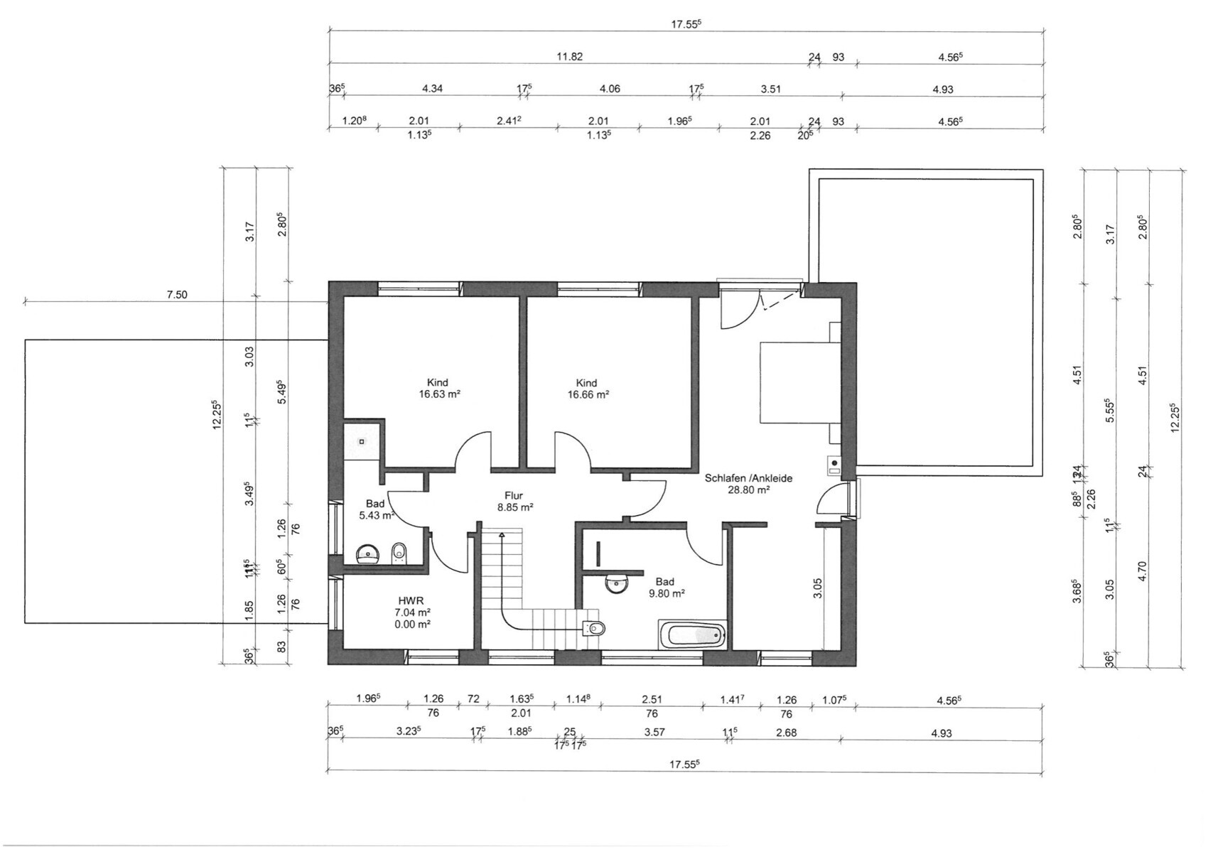

I am currently planning the construction of a single-family house and am still undecided about the cooling concept. I have attached the current floor plan. Regarding the layouts, I also started a thread in the floor planning forum (https://www.hausbau-forum.de/threads/grundrissplanung-und-platzierung-efh-ca-200qm-auf-900qm-Grundstück.39104/page-4#post-505270).
This is a KfW 55 new build (Poroton brick, reinforced concrete ceiling) with an air-to-water heat pump, controlled ventilation system, and blinds/shutters on all windows. The garden side with the large windows faces southwest, the entrance side faces northeast. The office facing the garden definitely needs air conditioning, as it is in constant use with many technical devices generating significant heat. Otherwise, I personally prefer it quite cool; I usually vacation in Scandinavia but definitely not in Greece, Egypt, or similar. In other words, my comfort temperature is significantly lower than most other people’s.

Samantheus24 Jun 2021 18:07I have now received an initial offer for a DAIKIN R32 multi-split outdoor unit and a total of 5 [I]DAIKIN R32 Comfora wall-mounted units[/I] for approximately 19,000 EUR (including installation). Compared to your figures, this seems quite high to me, so I will look for alternative offers. Have you generally had good experience with Daikin and are you satisfied?
bauenmitschaf24 Jun 2021 19:27Maybe another alternative idea: Your sketch looks almost like reinforced concrete slabs on the ground floor and first floor, right? In this case, thermal activation of the concrete slabs could be a good option. This would allow you to cool very effectively (ideally combined with a brine-water heat pump with passive cooling) and also lower the supply temperature during heating (increasing efficiency and the self-regulating effect). Additionally, a split air conditioning unit could be used for dehumidification.
