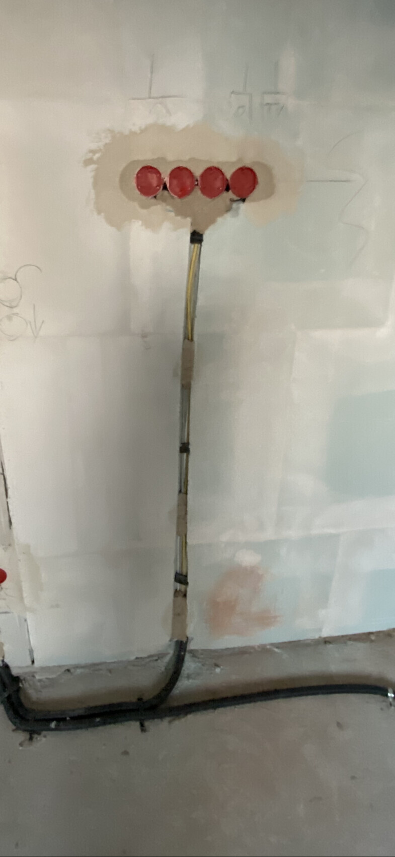

danixf schrieb:
I’m a bit confused about the cable routing? Is only one conduit leading there? Where does the network cable end?Where does the yellow cable go? Is it inside the same conduit?G
goalkeeper27 Jan 2020 14:00danixf schrieb:
Where does the yellow cable go? Is it inside the conduit as well?In this picture? It goes inside the conduit and then into the utility room to a patch panel.
goalkeeper schrieb:
In this picture? It goes into the conduit and then into the house connection room onto a patch panel.Exactly. Your equipment was in the attic before. Now it makes sense...apokolok schrieb:

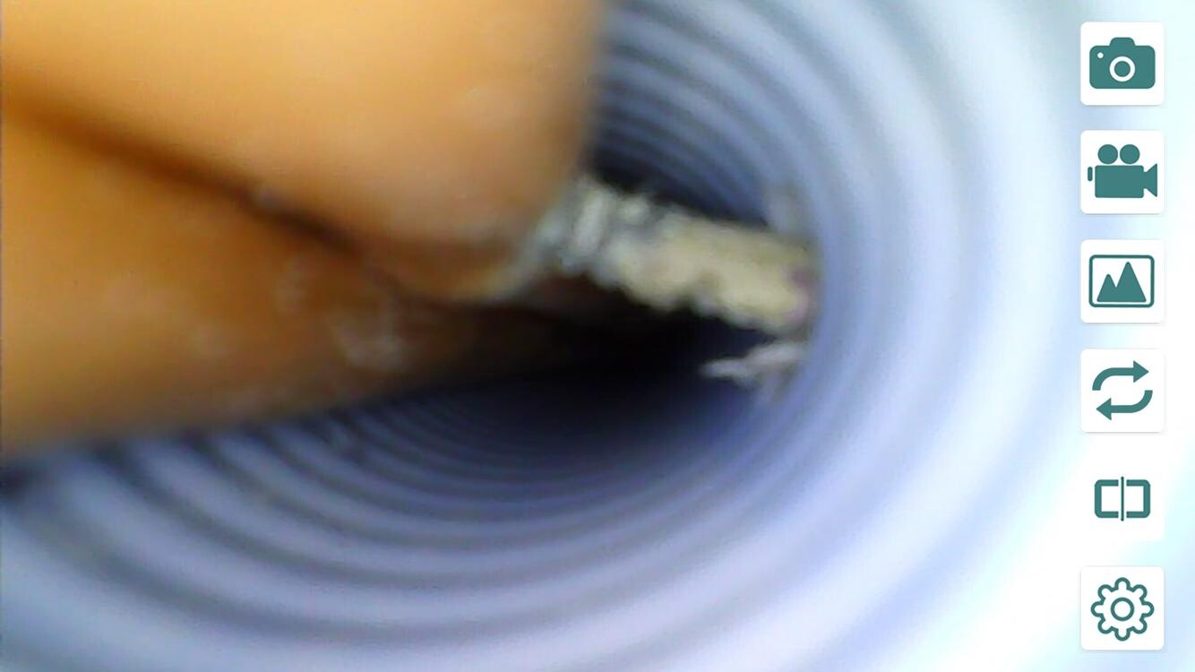

Anyone installing CAT7 or higher into the wall won’t touch it for their entire lifetime.I have. Even duplex. And you can see how quickly something can go wrong. In the photo, the conduit looks huge... but it’s only M25. Similar arguments were made 20 years ago. No one really knows what data volumes will be needed in 10-20 years. You’re probably right, but with minimal effort you can prepare for the future.
