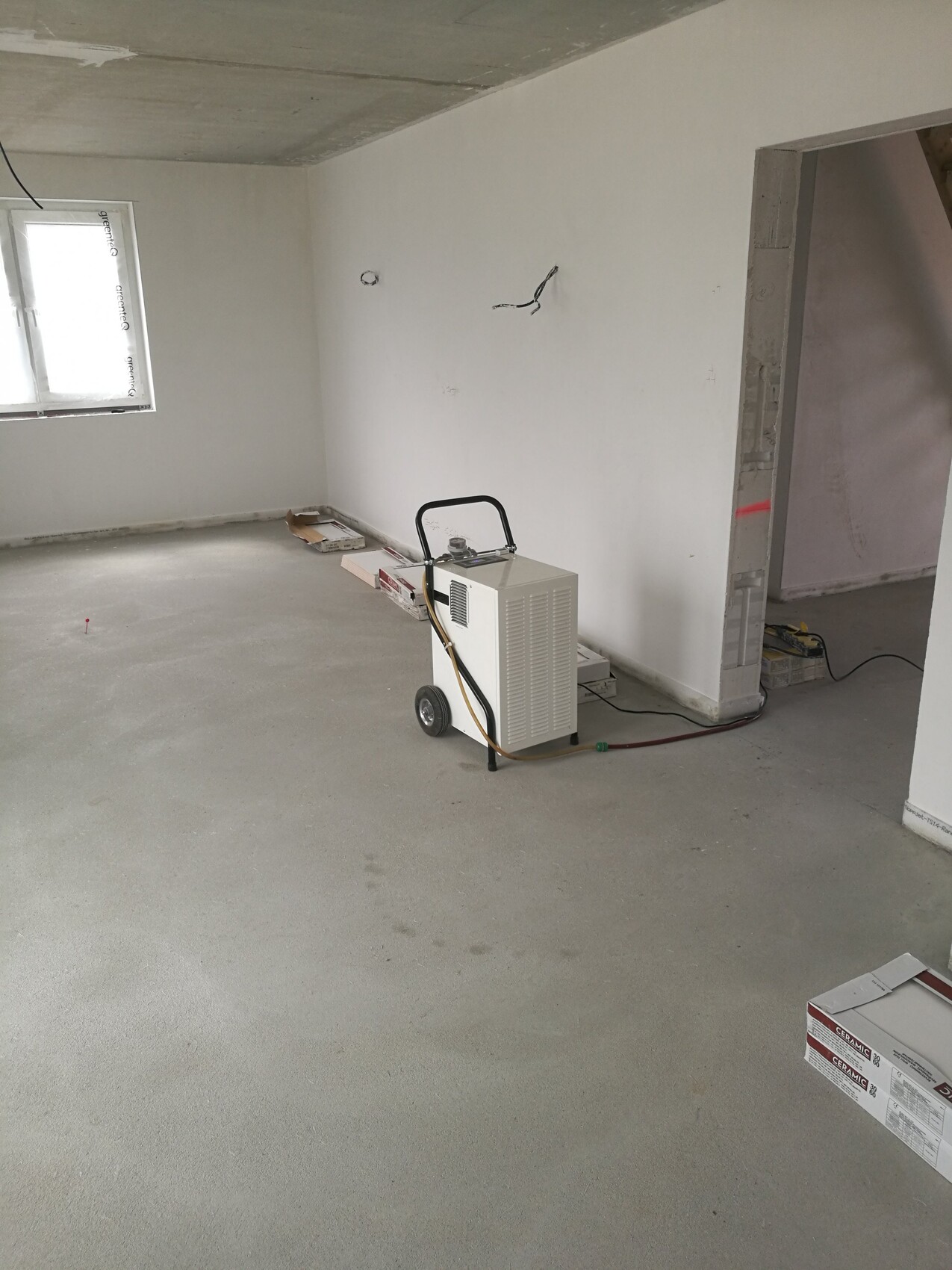

Steffen8021 Jun 2018 08:55The large one is good. The smaller ones are just toys. We had three large ones... I bought them myself on Amazon and then resold them for about 80% of the original price. They had around 2000 hours on the clock.
Renting would have been significantly more expensive.
