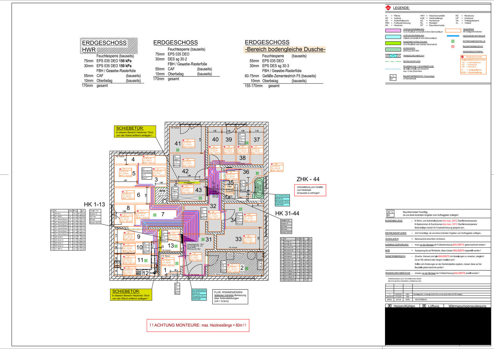

Neubau20223 May 2022 07:23Good morning everyone 🙂
I received the plan this morning (see attachment).
Converting the PDF to JPEG unfortunately reduces the quality significantly.
Here are the relevant details:
If I’m reading it correctly, there are 1x 13 and 1x 14 heating circuits, so a total of 27.
The maximum circuit length is 80m (262 feet).
The supply temperature according to the plan is 35 degrees Celsius (95°F). I personally find this quite high. I will ask about it again. Isn’t the setting done by the heating system installer and not by the underfloor heating company?
In the living room, kitchen, children’s room, and main bathroom, the pipe spacing is 6.5cm (2.5 inches).
In the bathrooms, bedrooms, office, utility room, and corridor, the pipe spacing is 13cm (5 inches).
Neubau20223 May 2022 07:39TmMike_2 schrieb:
No, everything fits, you will never reach 35°. That number is just irrelevant. Okay. So everything is very good, or at least well planned, and I can just sit back and drink cheap whiskey with cola? 😎
