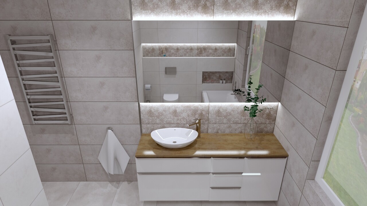

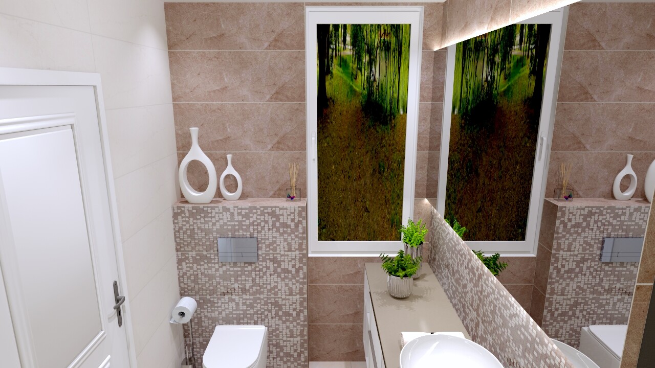

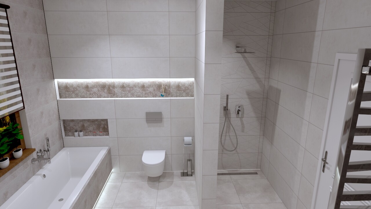

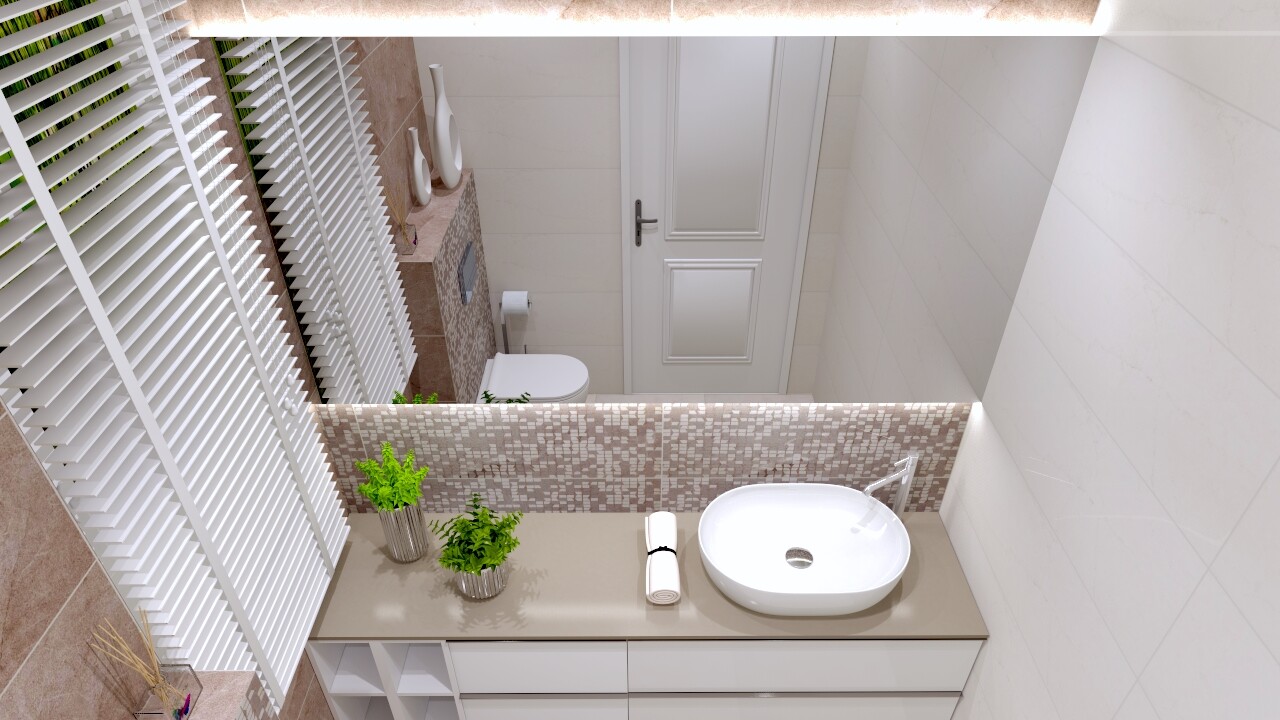

Neubau202226 Apr 2022 07:51Here are some photos of our bathroom planning (bathroom = 9.5 sqm (102 sq ft); guest toilet: approx. 3.5 sqm (38 sq ft)). The planning was done in Poland (Szczecin). The cost was 400 PLN per bathroom, which is about 85 €. The package also includes drawings with dimensions and detailed tiling plans, specifying the tiles for each wall. The only change will be that we will add a drywall WC module for storing toilet paper and the toilet brush.
If you order the tiles together with the planning, the planning cost will be deducted. We have tiles going all the way to the ceiling. The tiles cost us 2,850 € plus 260 € for transport.
