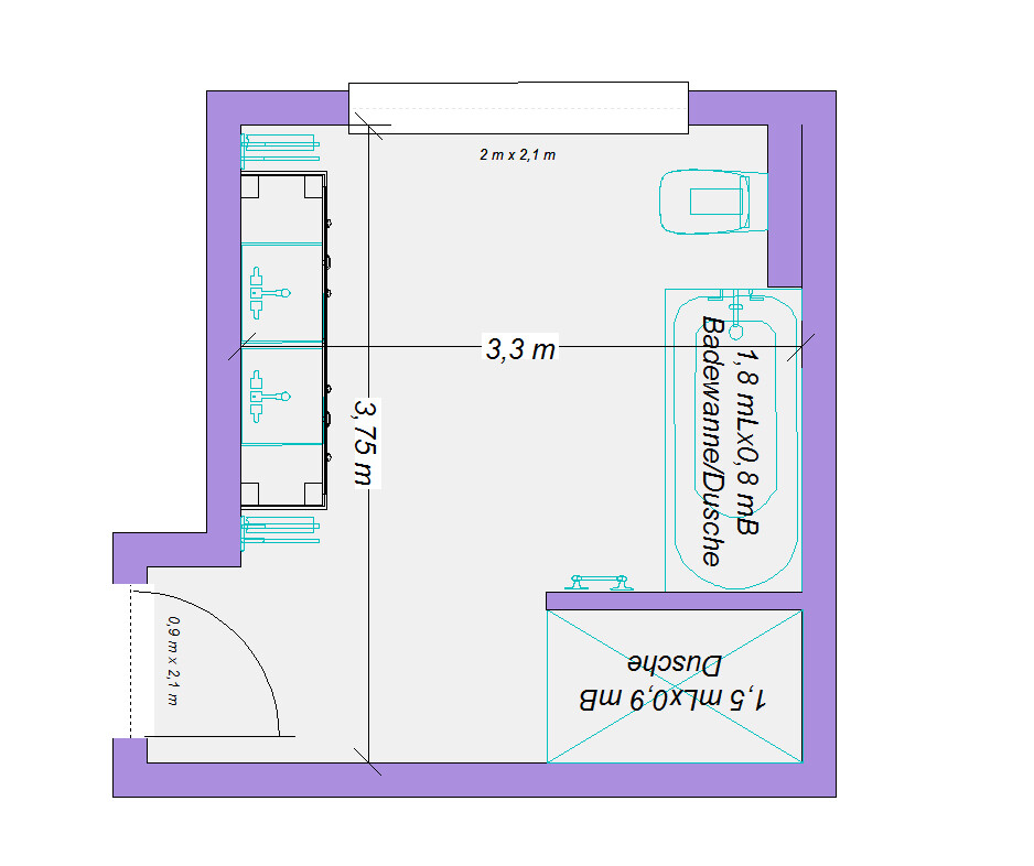

I have a room that I want to convert into a bathroom. I’ve already experimented a bit with arranging the sanitary fixtures in a 3D program. I’m usually very uncreative with this kind of stuff. Maybe you have some ideas?
I tried using a T-wall to position the bathtub more in the middle of the room, which would create good space for some storage. But then the access to the toilet becomes quite narrow. Another option could be to place the bathtub by the window in the left corner and put the washbasin in front of the T-wall.

Is it a bad idea to put a walk-in shower in front of a floor-to-ceiling window?
Of course, privacy would need to be ensured. Otherwise, I think the idea of natural light in the shower is quite nice. Does anyone have something like this and can share their experience?

motorradsilke26 Apr 2022 09:41kati1337 schrieb:
The scenario where we want to open the window while someone is on the toilet or in the bathtub seems very unlikely to me. Generally, it's rare for multiple people to be in the bathroom at the same time. So the situation where "you can’t get through because someone is standing at XY" hardly comes into play here.

I consider the T-shape here completely unsuitable. Besides, the window is on the wrong side. I would go in this direction:
Similar approaches have already been shown. However, I always find it nice when you can place a wide cabinet combination around the vanity. The shower then needs its own spotlights if a glass enclosure is not an option. I would at least use frosted glass for the upper part.

I consider the T layout completely unsuitable here. Also, the window is on the wrong side. I would go in this direction:
Similar approaches have already been shown. However, I always find it nice to arrange a wide cabinet combination around the washbasin. The shower then needs its own lighting spots if a glass enclosure is not an option. At least I would add frosted glass to the upper part. In my opinion, the most sensible "compromise design."
An open, bright room without labyrinth-like sections, practical in terms of available space and sightlines (hidden toilet), etc.
The only drawback would be the open view of the shower area when entering the room. But other than that…!
I would also avoid the double washbasin, especially since Kati mentioned the bathroom is rarely used by two people simultaneously. Better to install a standard 130–150 cm (51–59 inches) washbasin and use the additional space next to it for storage.
