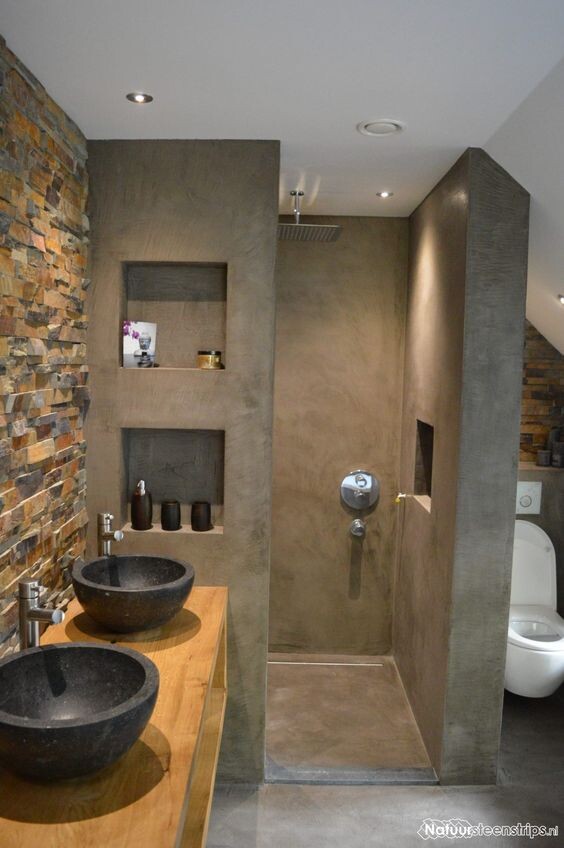

But the layout itself is great. It also reminds me of this picture I once found on Pinterest and really like:
Modern bathroom shower with two black stone basins on a wooden shelf and stone wall.
Not the concrete look, but the idea of connecting the long solid wood countertop to the shower with those built-in niche shelves.
