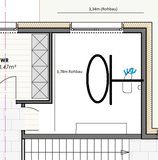

I have a room that I want to convert into a bathroom. I’ve already experimented a bit with arranging the sanitary fixtures in a 3D program. I’m usually very uncreative with this kind of stuff. Maybe you have some ideas?
I tried using a T-wall to position the bathtub more in the middle of the room, which would create good space for some storage. But then the access to the toilet becomes quite narrow. Another option could be to place the bathtub by the window in the left corner and put the washbasin in front of the T-wall.
General requirements for the bathroom:
- Large walk-in shower without glass
- Bathtub with a view of the window
- Bathtub positioned so it doesn’t face the toilet
- Longer washbasin (not 100% fixed, at least 80cm (30 inches), preferably more for double sinks)
- Corner bathtub or, if straight, with larger shelves around it (for decoration / candles)
- Space for one shelf for towels (lowboard or tall shelf doesn’t matter)
Do you have any great ideas? Things to consider?
Is it a bad idea to put a walk-in shower in front of a floor-to-ceiling window?
Of course, privacy would need to be ensured. Otherwise, I think the idea of natural light in the shower is quite nice. Does anyone have something like this and can share their experience?

Basically, I find these half-height privacy walls simply unattractive, so that wouldn’t be an option for me. If separated, then all the way up to the ceiling. In your case, that would be somewhere in the dark corner at the back. Maybe you could enhance it with stylish spotlights or LED strips. The same applies to a shower with three walls. I wouldn’t choose only two walls, as the water will spread quite a bit, especially in a smaller bathroom. I wouldn’t want to mop up half the bathroom every time.
I would place the bathtub by the window. And not a freestanding one, but at least partially built-in (for shelves to hold cocktails, candles, and so on). However, if you want to enjoy the view there, a half-height frosted window, as mentioned earlier, won’t help. You wouldn’t be able to see outside anyway.
I don’t think your first layout draft is bad at all. I would only change the position of the bathtub and the washbasin. Have you considered moving the toilet and the shower to the bottom of the plan (possibly rotating the toilet 90 degrees)? The washbasin could then go on the front side of the T (where the bathtub is now) or on the shower’s side wall, and the bathtub could be placed in front of the window (maybe as a corner tub in the top-left of the plan). That way, you would still have enough space on the left wall for a shelf or something similar.

I like the design in post 3, but I would swap the washbasin and bathtub because the washbasin is used more often. Then install a nice corner bathtub. There’s enough space for that. This way, you can look out the window and towards the door.

[ATTACH alt="Unbenannt.JPG"]71395[/ATTACH]Swap the washbasin with the bathtub and the toilet with the shower?!
In my opinion, the washbasin should always be placed close to the door since it is often used for quick handwashing, etc. The shower (with a glass partition) in the bottom corner (right side of the plan) can be designed to any desired length. The only downside would be the toilet next to the bathtub, but you wouldn’t really notice it when enjoying the view towards the window 🙂

I would place the bathtub by the window.If you have other options, then definitely not that. Windows need cleaning, and that is only possible if you stand in the bathtub.There are good reasons why the classic layout is still the most beautiful in the long run.
